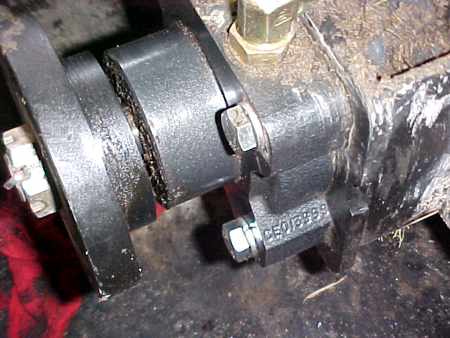

I pulled the wheel to check for oil leaking (see above post) and these are the numbers I found on the Parker motor.
CEO13999 is stamped on the top (see attachment) and under the motor are the numbers 25C3N (no picture).
Hope this helps.
PJ

Paul,
Interesting that the motors look to mount differently than the last version of the PT425.
I have a yard tractor that leaks past an oil seal (Hydro tranny) only when the temps get below 20 F. The rubber oil seals get pretty hard at those temps. Keep an eye out, and let us know.
Thanks for the picture.
Duane
   / replace parker wheel motors #11
they bolt the wheel motor to a weldment then it bolts to the frame. at least that is what i saw my last time at pt. the new wheel motor is larger and the mount is a lot heaver than the old way, a vast improvement!! /forums/images/graemlins/cool.gif
