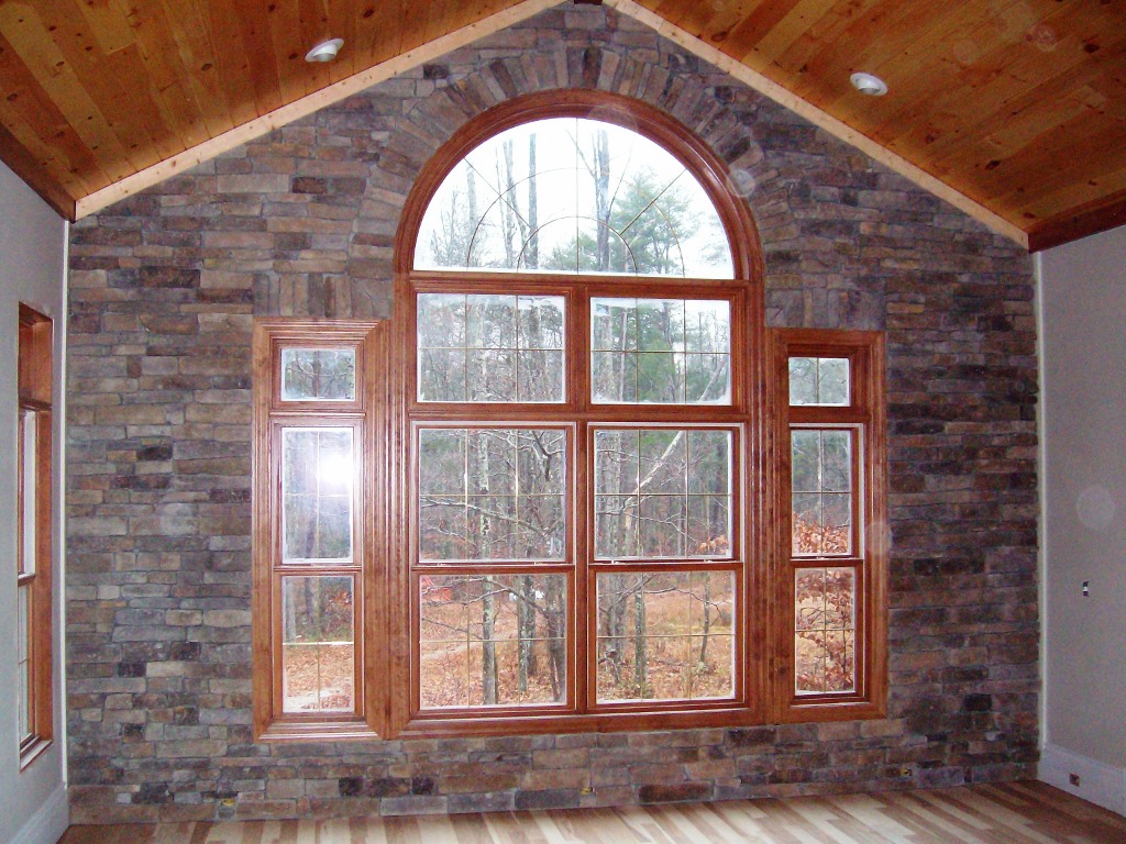

There's only one potential problem with the low-e coatings. We bought nice low-e Sun windows for the new house (about $38k worth!!). In one of the window "sets" (see photo) the top 1/2 round developed a leak between the two panes and started to fog slightly. Sun quickly agreed to replace the 1/2 round at no cost to me, BUT they are now using a slightly different coating, so the coloration from the coating is different from the rest of the "set". It is only slight, but noticeable.

I can tell the color difference but only because I looked for it since you pointed it out.
That window and wall is beautiful.
I truthfully cannot see any coloration difference.....and agree that the wall and windows are just beautiful !!! And here I thought I was a big spender by splurging for $5000 worth of Low-E glass 400 series Andersons.....:laughing: Before your post I had never seen the brand name of Sun windows. Did you go with stock sizes, custom sized, or a combination of both?

I have had the same experience with a 5'X5' window JRobyn mine is much darker than the rest but we can live with it.

Was it the low e coating or the argon between the glass that caused the problem.
