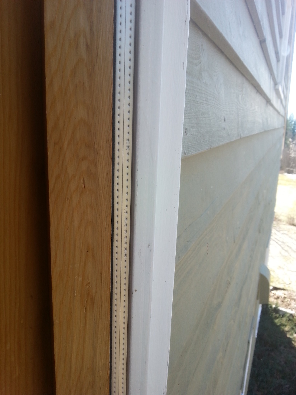

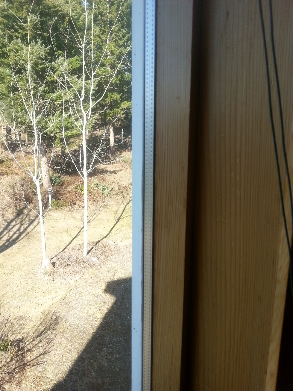

Can you just replace the glass?
All the seals of our then 32-year old home were leaking when we moved in 11 years ago. They had moisture and dirt between the panes but the wood frames we good. The local window store came out and measured all the windows, ordered sealed glass panes and installed them for a very reasonable price. They removed the outside 3/4" wood strips to take the windows out and cut new strips. As EddieWalker recommends, they put double-sided tape on the new glass panes. They peeled back just enough of the vinyl tape covering on the inside face of the tape strip so it was accessible once they put the window in the house frame. They removed the tape by carefully pulling it out between the inner house wood surface and the glass. Here are some photos:
