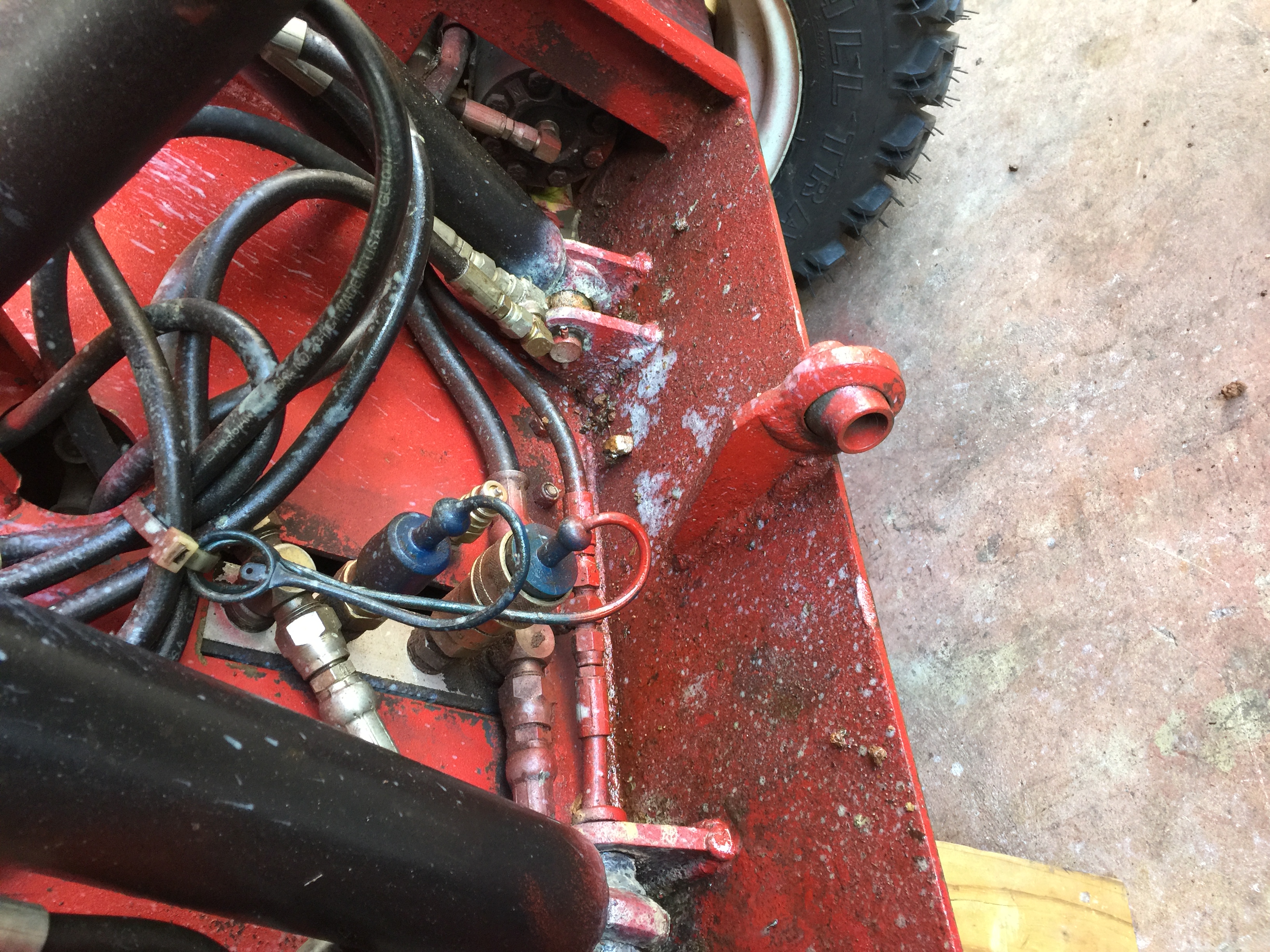

Being lazy here I know. Sure I can find it but what is this bracket for. Maybe for a plow / snow blower hookup or something?

It’s like the human tailbone. A left over from a previous version that somehow does not go away. It was part of the stabilizing for older implements before the quick attach came into play. It might still work with an implement but none I know of.

But your tractor is weird. Is that your pto hookups with the covers on them? That would not last in my machine. Too many branches hit that area
I’m not sure, but some of the older brush hogs had a second attachment point down there. You get a better transfer of force than with the lift arms.
I’d use it anytime that you are putting a lot of force on the arms; plowing, using the potato digger, etc.
All the best, Peter

As mentioned, that's for older units without the quick attach. I think they called it the 3-pin hookup. If you google a bit, you can find pictures of some of the older units and attachments. There's also a few on the "for sale" page on the Power Trac website.
Your right and I've been thinking the same thing .. Pretty exposed to puncture from branches ... Plan to make a cover for it soon. I have one short hose in front that goes to the loader. It must rub slightly when the bucket goes up and down. I noticed It has rubbed the outer layer off .. I need to be proactive and replace it while I'm at it ..
I'll have to do that .. I did look briefly though my documentation and have not seen any diagrams with the included attachment point. There probably was an older attachment or two that used to be on the list ..
