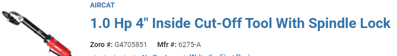

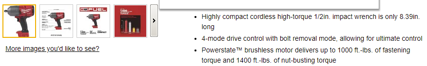

I replaced 90+ bolts/nuts on my John Deere 1600 4-18 plow. Bruit force with a Milwaukie impact or Aircat cutoff saw at 14,000 rpm.
