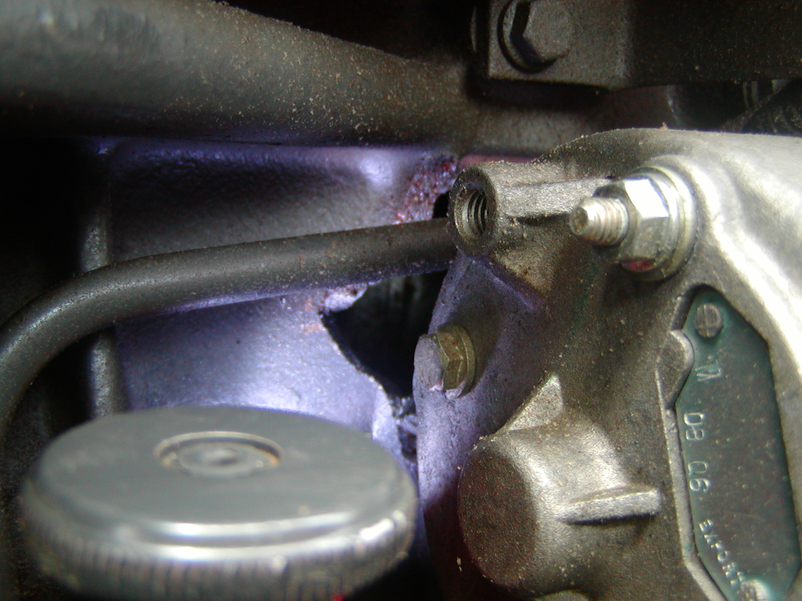

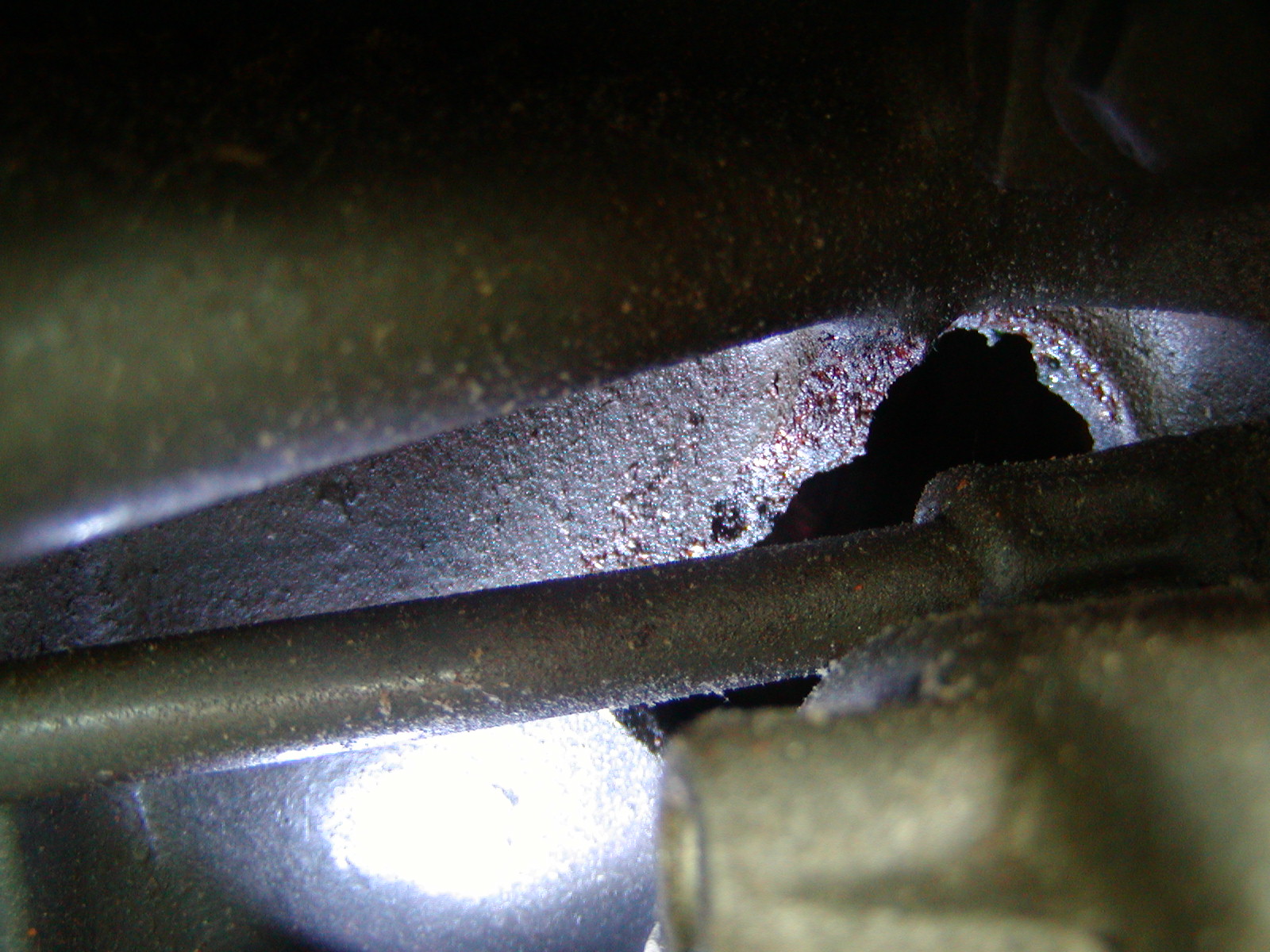

Of the handful of engines that I've seen that chucked a rod out the side of the block, they were ALL a huge oily mess... oil sprayed out of the hole everywhere...
Those pics look pretty clean... even though it has sat for a little while... not much residue.
I'm not saying that it did get run dry on oil, but those pics make you wonder...

Been mowing with my old MF230 the last few days and haven't been on so here is the update.
Mahindra contacted my dealer and told him to pick up the tractor and assess the problem.
They are very busy in the shop right now ( this is a small dealer in a small town ) but will get to it asap.
As for the oil not showing in the pictures, it had been several weeks and MANY heavy rains and storms before I took the pictures. At first it was flowing out the block and running down the side.
My friends Kubota 3400 ended up pulling the Mahindra back up to the house, should have gotten a picture of that!

The Mahindra is on it's way to town! Dealer just picked it up. Mahindra has been calling him to get status report.
He doesn't know what could have happened, never seen an engine fail where this one did. Have to pull it apart to see.
   / Review of 4500
#36
Went by dealers today for followup.
The rod cap was lying in the oil pan!
One bolt is sheared off clean, the other is bent, then sheared.
Both shoulders of the rod are broken off.
He is waiting for the Mahindra rep to come by to look at it.

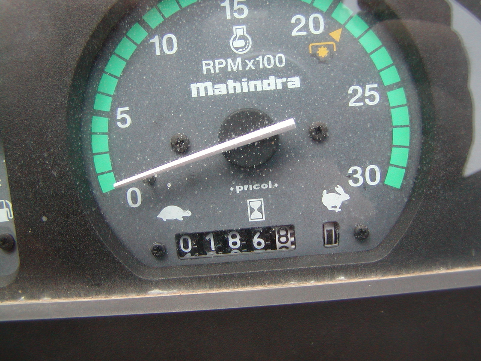

at 186 hours, there simply isn't an excuse for this.........a buddy of mine was thinking of selling his NH and going with mahindra........
i'll be watching this....

From what you describe, there is usually only one way that such a dramatic failure of a rod can happen...that's if the piston has seized...is that the case? BobG in VA
   / Review of 4500
#39
Don't know about seizing, dealer thinks rod cap came off and then the slap of the loose rod broke the shoulders off.
I am no kind of mechanic, that's why I try to use people who know more than I do to work on my equipment.
Rod caps are the problem mentioned by the dealer who sent me the private message and said that there have been some others with the same problem, but not many. Sure hope the new engine Mahindra went to addresses this problem.
   / Review of 4500
#40
As of today, Mahindra rep has not told dealer what they will do.
#3 rod was about to go, and there was antifreeze in the oil. Cylinder head, gasket ? I don't know. Just waiting.
