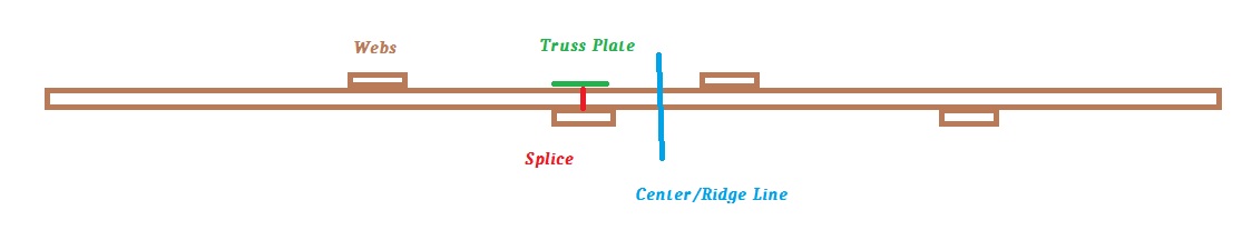

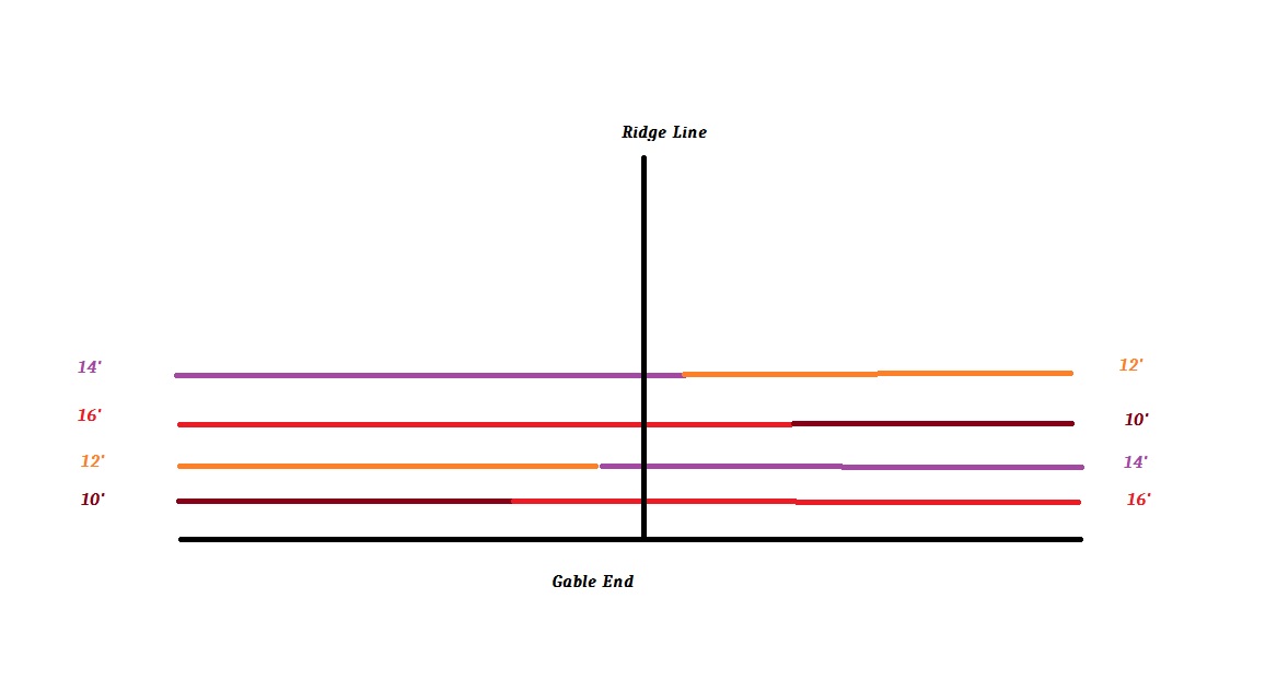

This is sort of what I'm looking at. This way, no two splices (where the colored lines meet) on the bottom chords would be at the same point on any side by side trusses.

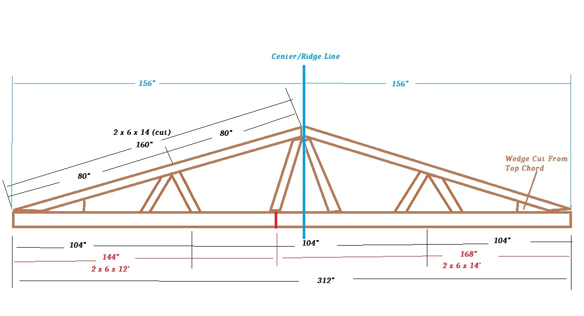

Hate to keep buggin' ya'all, but this is what I came up with after studying a bunch of truss maker diagrams and what I have in the garage that was stick built. This is sort of a modified design based on a few others. Bear in mind this was sketched out in MS Paint, so it's not even close to scale. Second picture is an attempt at a top view top show that the webs would be nailed to the sides of the top and bottom chords in an alternating pattern to hopefully help avoid any future twisting. One would be nailed and glued across the splice between the 12 and 14 footers with a truss plate on the other side, nailed through both.
Turns out the piece I cut off the top chords fits perfectly as a wedge between the top and bottom at the ends, so that will be added and glued in place.
Will this work? Do I need more webs or rakes?

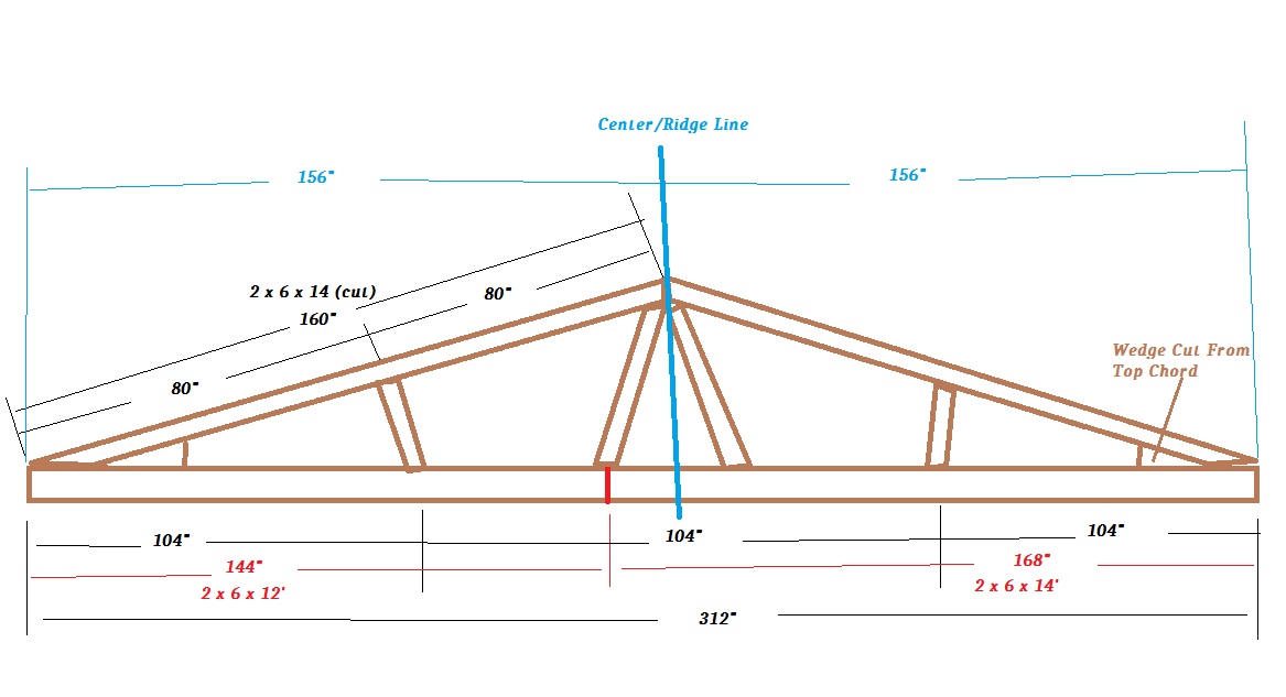

Top chord (rafter) looks fine, longest span is under 7' - The "mini-spans" on bottom chord are a bit long, I marked up your sketch a bit.
It's fine to put your cutoffs on the end like that, but don't expect it to do more than just fill the corner - for strength on those end joints, you will need to make truss plates shaped to that end - top edge of plate follows the outer edge of rafter, bottom edge follows the bottom edge of horizontal chord.
Looks like you're using MS Paint - couple tricks I use on that (I do more precision stuff in Cad) - if you want lines at perfect 90 or 45 degree, start the line and hold the shift key - mouse position will determine angle, and will shift between horizontal, 45* or vertical - try it, it's handy. Also, if you're semi-**** like me you can "sorta" SCALE a drawing - move your mouse while looking at the borders, you'll see a pixel count change as you move the mouse. Choose a rectangle shape, click on far left of the screen, drag right and a little bit UP - one of the small indicators will show the size of your rectangle. If you drag full width of your screen, that will tell you how many pixels the width is. If you make that skinny rectangle come out to an even # of pixels, you can draw subsequent shapes to 1/2, 1/3, 1/4, etc, and your drawing will be less likely to "fool" you.
Also, the ellipse tool will make a true circle if you hold the shift key while drawing it - if you want several identical circles, you can copy ONE circle with the select tool; that puts your selection into the clipboard, and you can copy and drag it anywhere on the drawing.
I spent breakfast time looking thru pics, must have a few HUNDRED of the shop and NONE show much of my trusses. sometime today I'll go take some pics of mine for you.
As I mentioned before, I would NOT try to use the entire length of lumber, ESPECIALLY on your bottom chords - there's too much likelihood that you'll end up using ends that are split or knotted, which will SERIOUSLY WEAKEN those TENSION joints. You'd be better off centering all your bottom chord splices and making that joint with THREE inside chords - one vertical to roof peak, and two more angled outward @ 45*, then dividing the remaining rafter length. I'll explain more later today, after I get a few pics for you... Steve

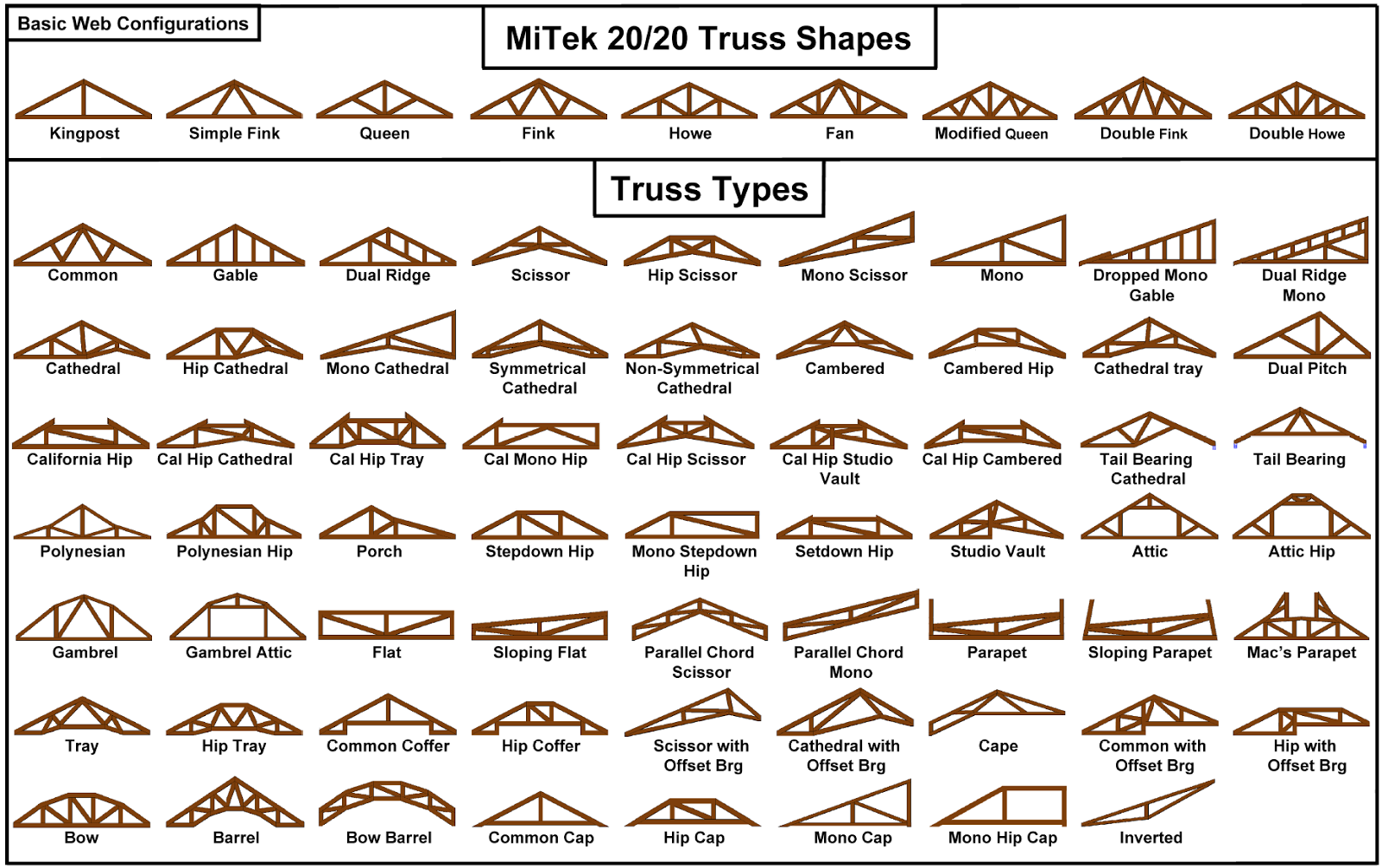

You don't have triangles in your truss. Your truss should look like one of these.

T's, absolutely; the ones I haven't posted pics of (yet) are a modified Queen. The changes I drew (above) are just a little improvement over the original. And DigginIt does have some triangles, just not everywhere... Steve

A lot of those don't really have triangles. What I did is based on those designs, dividing the spans into manageable sections and combined them with what I see in my own garage that has been standing for close to 20 years. That is sort of an inverted Fan with a vertical down from the ridge to the center of the bottom chord and just one web angled down and outwards from near the ridge to the center of remaining width of the bottom chord.
