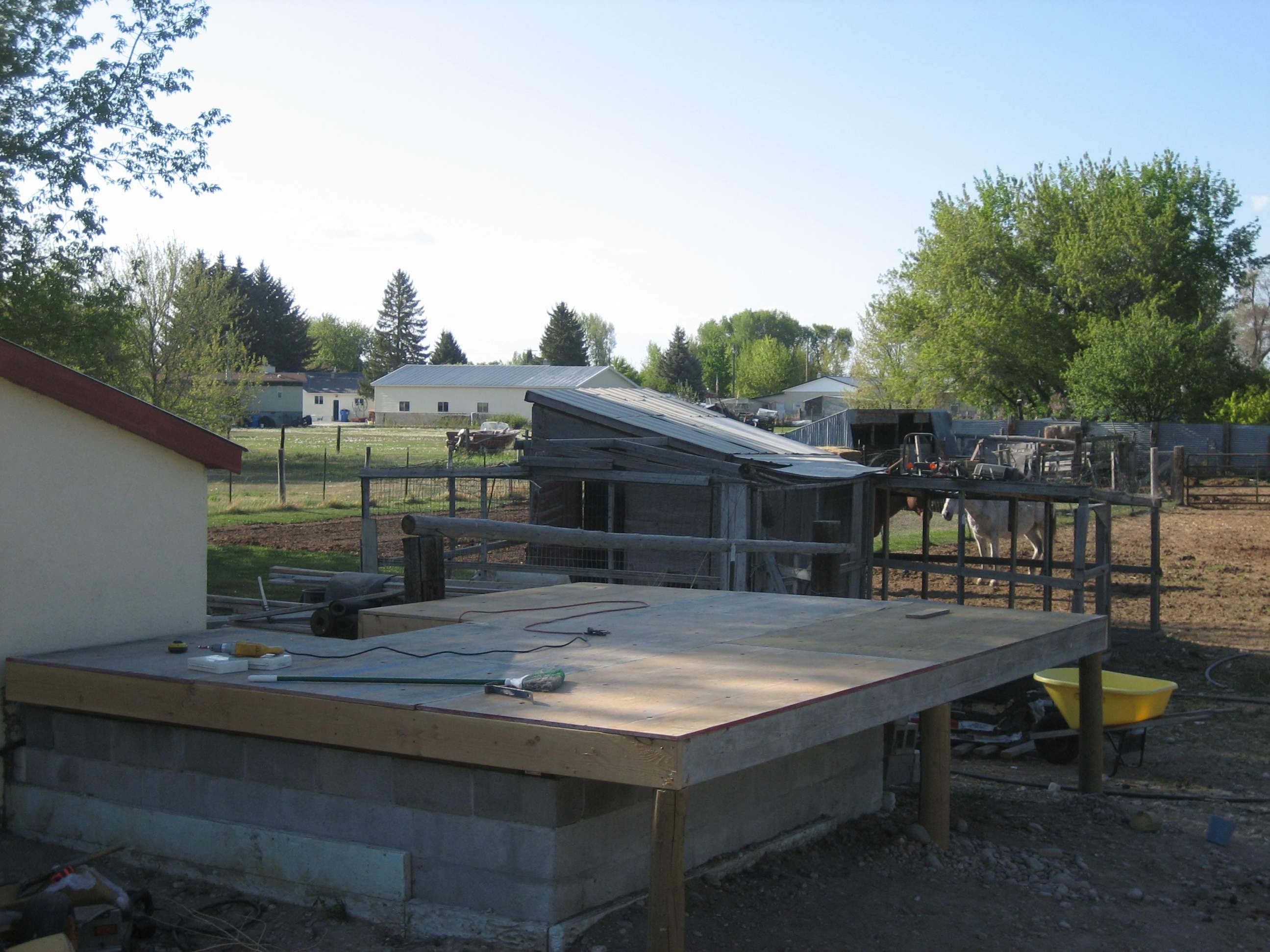

The subfloor is done. I didn't know what the code is for screwing down subfloor, and I didn't want to stop to look it up. I put a 1 1/2 inch grabber screw every 16" down each joist. That should be plenty. The floor is good and solid with no squeaks.
The next part is the wall framing. I'm a little intimidated to frame the walls, but I'll manage.

I'm still undecided how I'm going to do the framing. I looked up the code for subfloor screws and I severely misjudged it. The code calls for screws every 12 inches in the field and every 6 inches on the edges. I may go back and add another screw between each one I've already done. It won't be any cheaper or easier than it is now.
   / Root Cellar Remodel, Split Level Storage, Shop, Shed Pole Building on a Foundation
#97
I added screws to the subfloor. I went back and added an extra two every 16 inches on the perimeter and I added one in between each screw on the rest. That puts me every 5-6 inches around the perimeter and approximately every 8 inches in the field. That should at least do it.

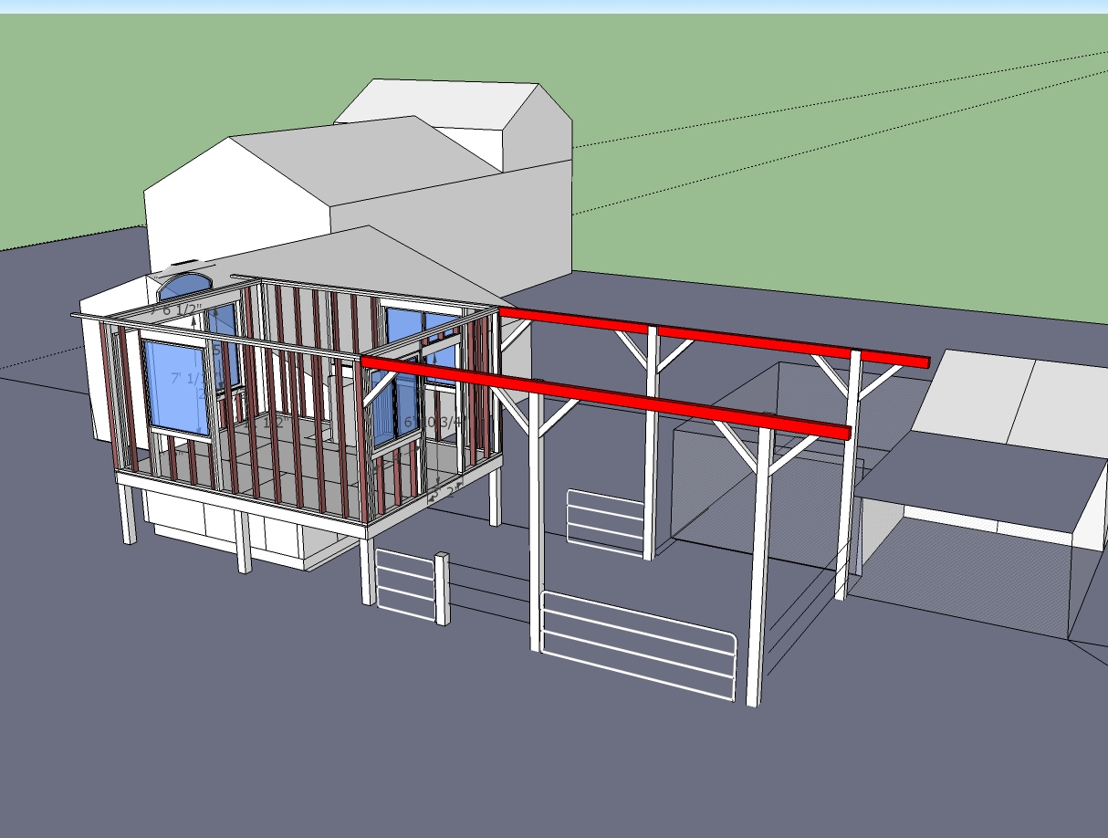

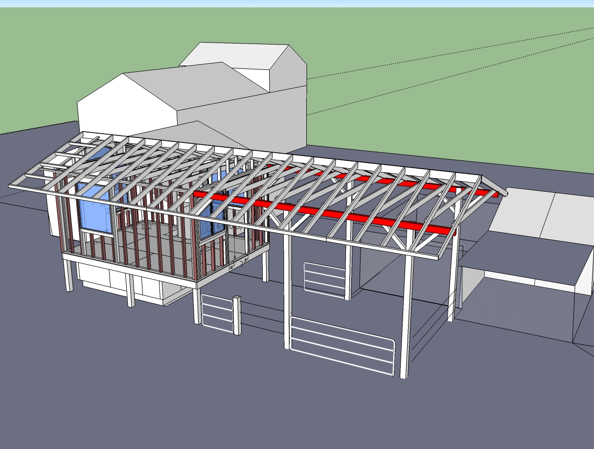

I'm back into this project, and I have a question... What size should my beams be that hold up the shed side roof?
The beams I'm talking about are the horizontal beams that are red in the attached pictures. The upright poles are 9 1/2' apart. The beams will be 12' from each other.
It seems to me that 2X8's should be a good size for this application, but I'd love to get some opinions.
The roof will be shingled. The roof pitch is about 4.5/12

IBC span tables don't go that low a span (the building is 12' wide if I understand your drawing). Residential rule of thumb is 1" of header depth for every foot beam length, for wall spans under 20' and 30psf ground snow rating. So I'd say double 2x8s is probably OK if you have good lumber, I think I'd go double 2x10s to be comfortable. Be careful how they're fastened to the post. If the post is big enough, I'd notch it for at least one of the beams, preferably both, and use a couple 1/2" through bolts with large washers. Put dummy posts in the location of each midspan truss/rafter to make sure the load is properly shared between headers and they act as a single structure to resist rolling.
