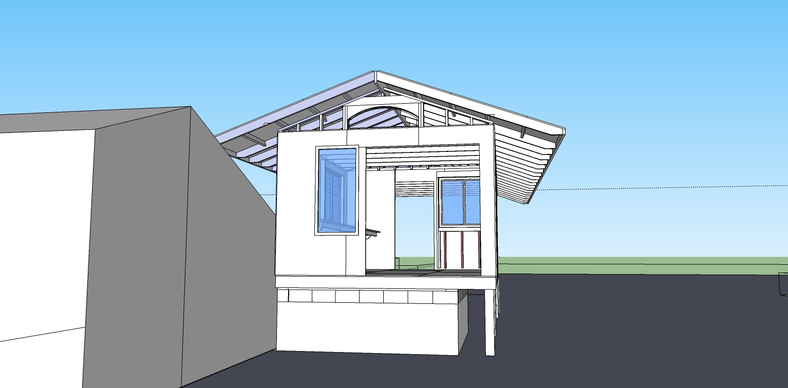

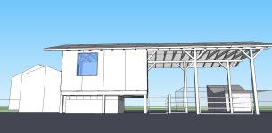

Now for the insulation debate. I'm very interested in any comments because this is a unique situation. There are three parts to this discussion: Climate, Structure and Schedule.
Climate: Idaho is very arid, but can get very cold. We don't typically have a lot of moisture in the air. For instance, today is about 25% humidity, and we just got rain over the weekend. We don't have the condensation problems that coastal areas and southern climates have. But we do get very cold. There's potential for a 80 *F differential in temperature if it's -20 *F outside and I heat the shop to 60 *F to work in. That is the purpose of this smaller insluated shop. I want a small space that is easy to heat so I can be comfortable working there in the winter.
Structure: Only a part of the workshop is over the basement. The rest of the floor is open to the atmosphere. I'll include a picture for reference below. About half of my floor is going to be over the basement that hopefully stays above freezing in the winter. The other part of the floor is going to be over the open air.
Schedule: As mentioned before, the workshop will only be heated periodically. I gave a best case scenario of 12 hours on Saturdays and 4 hours a few nights a week. A more realistic estimate is about 6 hours on Saturdays and maybe 2 hours at night twice a week. The rest of the time the workshop will be left to fluctuate to whatever temperature Mother Nature dishes out.
The question comes down to this... Do I need a vapor barrier and should it be up or down?

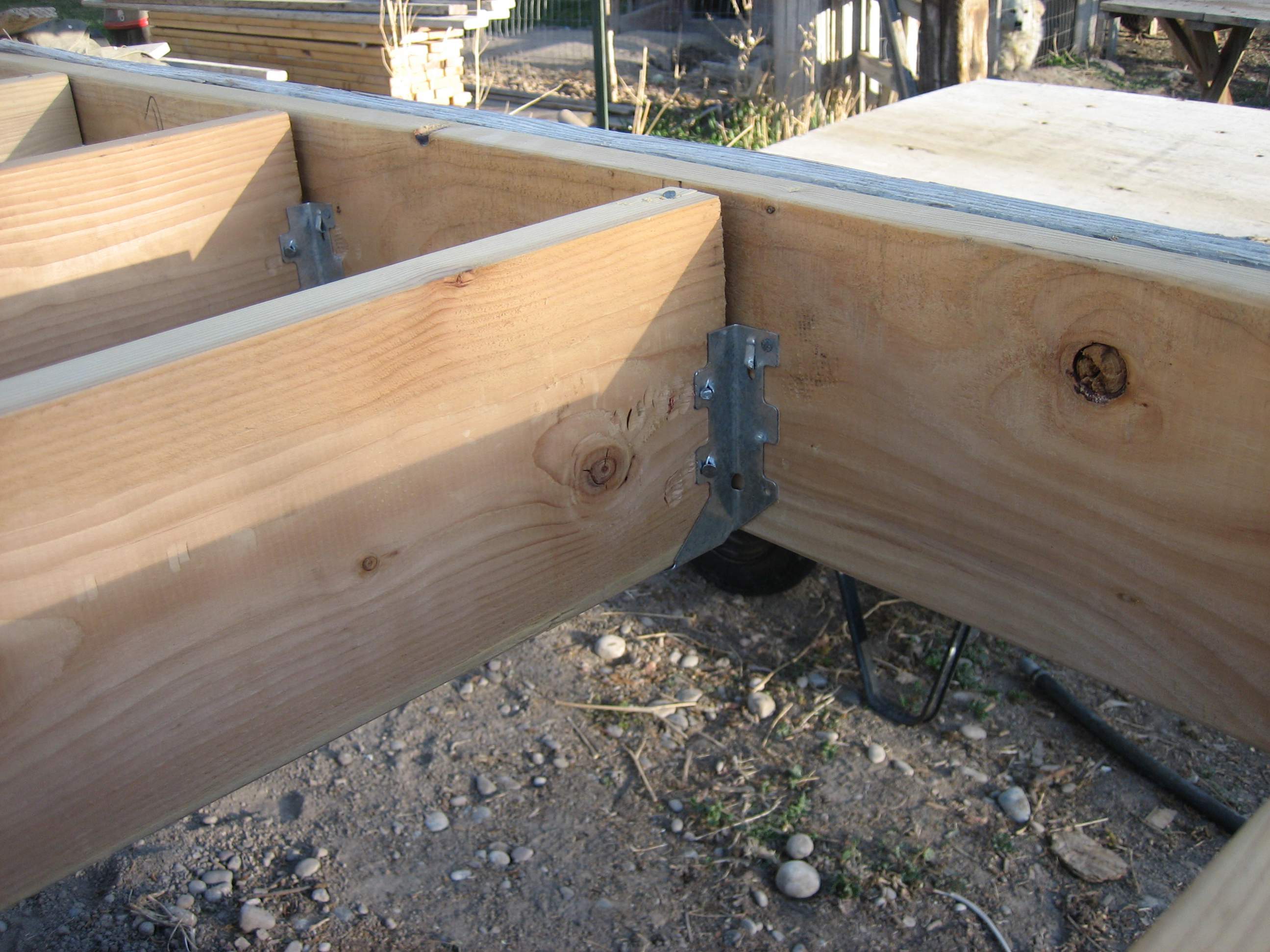

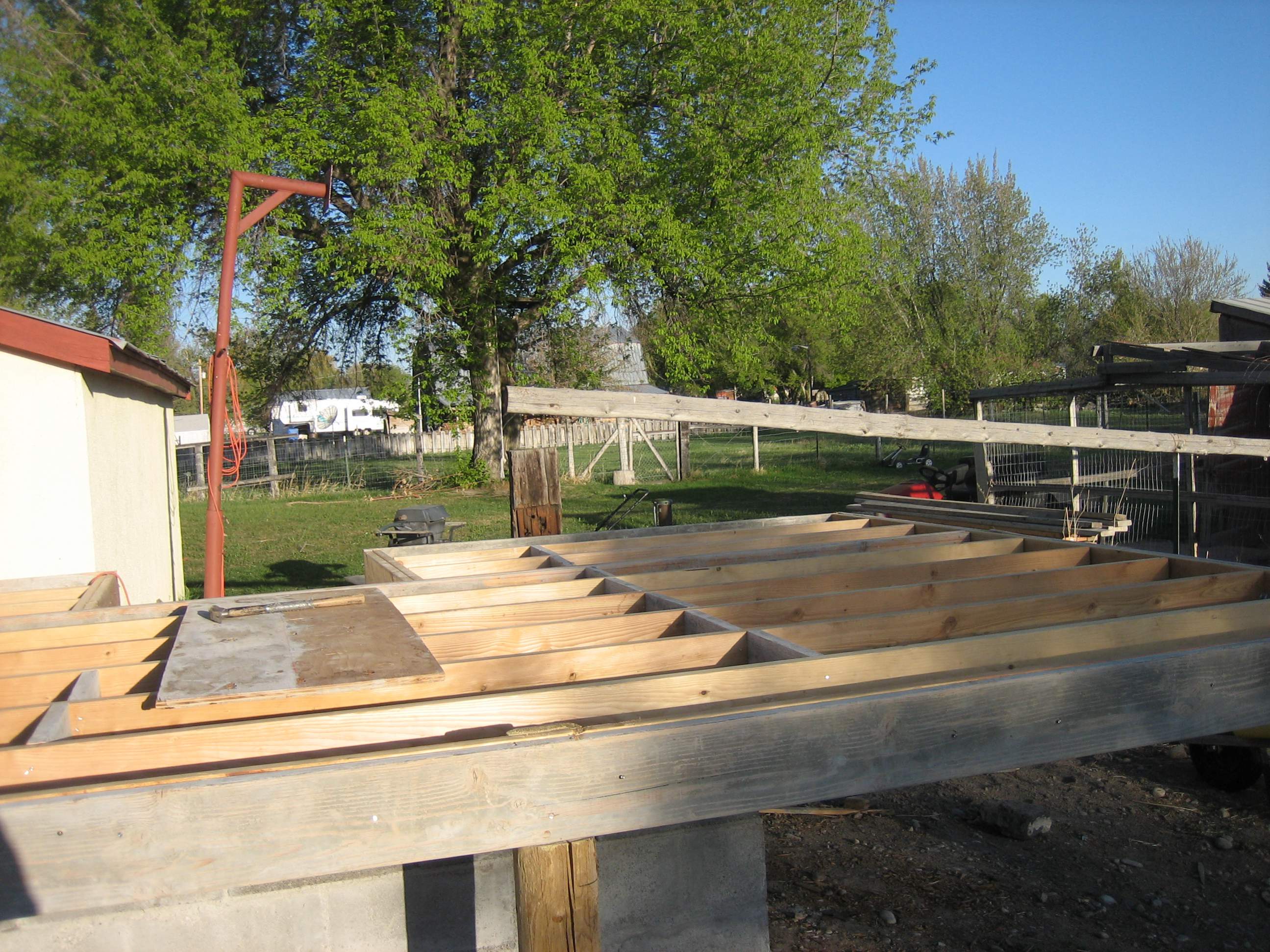

Here is the progress I made last night. I got all of the cross nailing done on the joist hangers. Then I got some of the blocking installed. I ran out of daylight before I got it done. (The pictures were taken this morning.) Hopefully I can get some more done tonight. I would have done more, but I took advantage of some very nice weather and rode my horse for a while when I first got home from work.

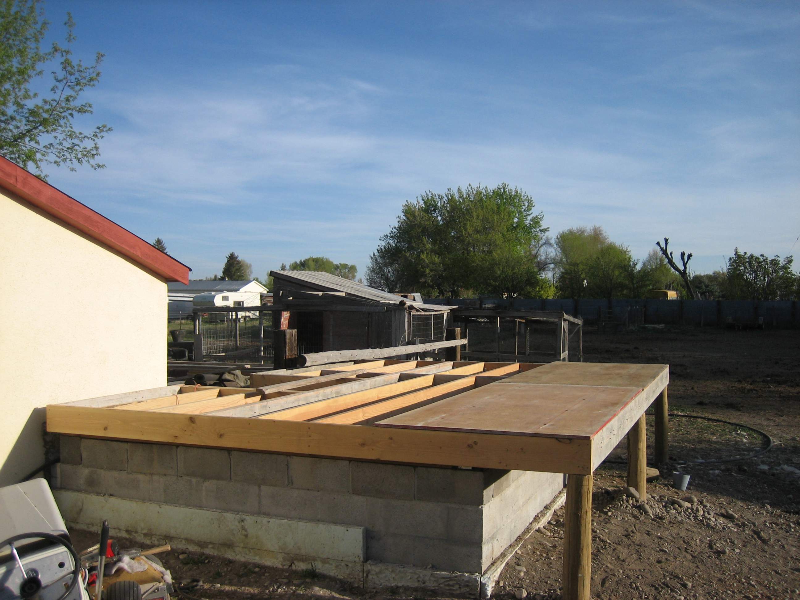

The first bit of subfloor has been set in place. It's not screwed down, but I set it up there last night just to check the fit after I had finished nailing the cross blocks in that section.
One step at a time. I'm counting my blessings that I'm finding the little bit of time I can to work on this project.
