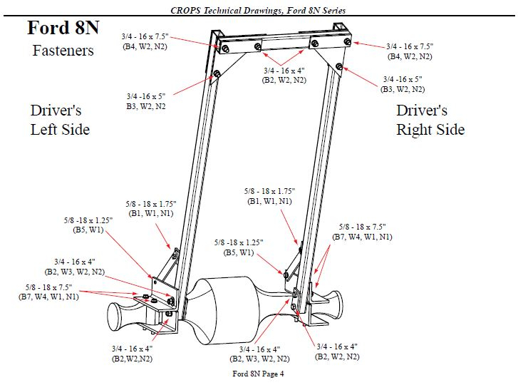

The way I see it, there is no reason that a manufacturer couldn't supply engineered drawings showing where holes could of a certain size could be drilled and what could be fastened to those holes. Like a 1/4" hole drilled in the center of the beam to attach a light should not affect the structural integrity of a ROPS. If it does then the ROPS is built out of to light a material to begin with.
Some of the first 4X00 John Deere CUTs came with a non foldable ROPS. The local dealer took them to a welding shop and had the welding shop make them foldable if the owner desired. I'm not saying this was wise or legal, I'm just stating what happened.

Yanmar has a few canopies that are mounted to the ROPS. They do supply official released drawings detailing how to drill and modify the ROPS for these canopies on installation. Since they certified the ROPS with the ROPS manufacture and the certification with the KY safety, this is legit.
Other tractor companies follow those same guidelines to prevent liability and lawsuits.

I think there's a lot we could do to our ROPS without measurably changing the safety they provide. For example, what's one teeny little 3/32" hole for fishing a lamp wire up there going to hurt?
But the thing is, there's kind of a sacred cow involved here. We don't really know for sure. We could also trigger something unforeseen, like the magnetic car door signs did. And I'd have to guess it's kind of putting a red flag there for future buyers -- if I was shopping for a used tractor, I'd pass on any with ROPS or frame mods, unless I was desperate, in which case I'd push for a significant discount.
