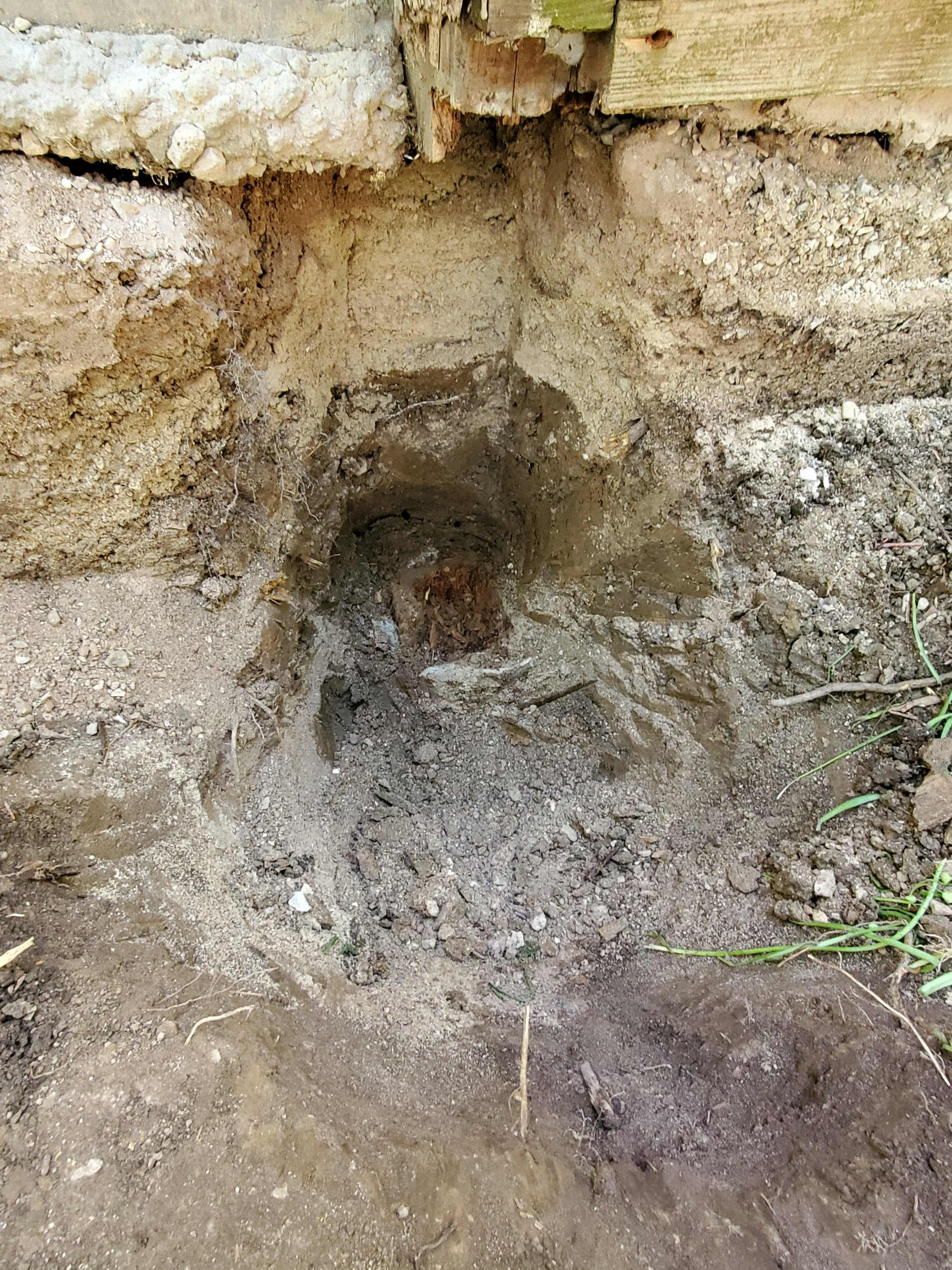

I have an older metal outbuilding. The 6"X6" posts were set in concrete and I'm sure most are rotting. The one by my entrance door has rotted completely thru and shifted about 1+ inch. The inside of the barn is all concrete with part of it finished and the post are covered up. I dug the one by the entrance out down to the concrete and cut off what was left of the post. My plan is to pour concrete over the existing concrete, set a new 6x6 a few feet long, and butt the old and new together and sandwich with 2x6's with carriage bolts. What should I backfill the hole around the new post with? Stone? Is this a correct way to do this?
Also, I need to remove the horizontal boards at ground level and replace. The problem is I need to remove the metal siding? I have removed a couple rows of nails, which are a pain, but cannot get enough flex in the siding to pull it out far enough. I will remove another row of nails. Is there a easier way to do this?
One last thing, the plant I worked at closed down after I have worked there 20 years due to outsourcing so money is tight, I'm doing all the work myself.

I would expect that you will have to remove most if not all of the nails. You do not want to bow or bend the siding as you will never get it back to the original shape and position. I know doing it by yourself is a pain. That's how everything gets done around here (of course wifey helps when she can). If you can, notch the upright posts (beams) this is what I mean Simple Half Lap Joint - Timber Frame HQ.

Is the reason the posts rotted is because there was a joint between the slab and the concrete surrounding the posts ? And then water got between them and into the posts ?
I have much the same problem as do you, though with no slab. I'll be pulling the rotted posts out, pouring concrete as a footer, extending it above ground level using Sonoco tubes. Then the remaining portion of the posts will rest on the footer.
/ Rotted barn posts #4
Did same project for a customer to save their barn. You are correct on the posts. I simply dug a sister footing, poured concrete and set sister posts. I used (3) 5/8” galv carriage bolts to sister them together up to about 5’ above ground and 3’ below ground. Has held fine for years. Did about 40 posts that way. You need the posts in the ground for building stability.

I dug the old post out that was incased in concrete. There is a round concrete "cookie" at the bottom of the hole. Can I just set the new post on top of that cookie and backfill with crushed stone or should I pour concrete around it also?
