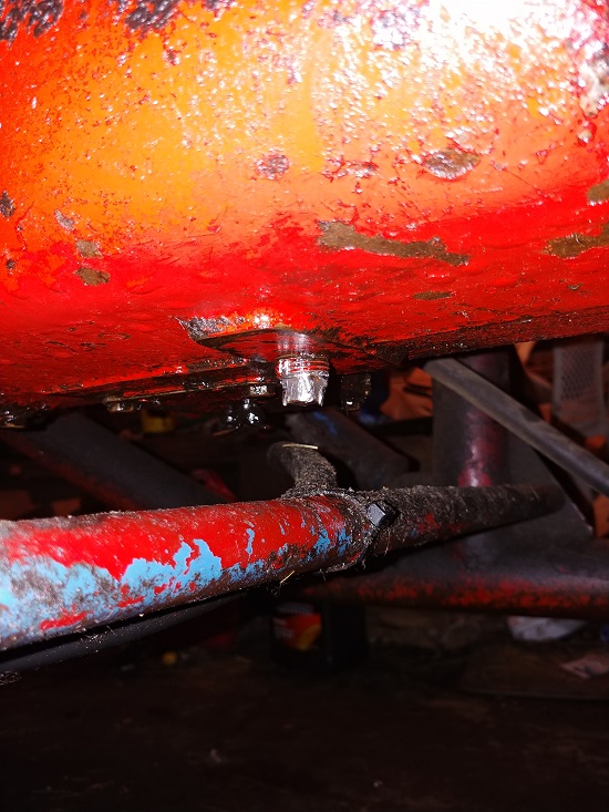

Looks like there may be enough room in the pan boss to just drill and tap a new hole...
But I would probably first try welding a wrench onto the stub that's left. Worst that can happen is that you twist it off.
Then you have two choices:
A) drill out the existing plug and hope you get your drill centered (and parallel).
B) drill and tap a new hole.
BTW, why do you need to remove the plug? Is it possible to use a pump to drain from the top?

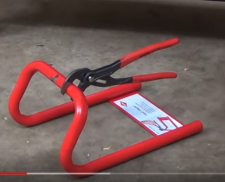

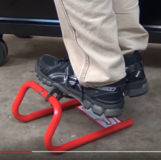

Put the Knipex on the plug adjusted for a good fit, squeeze, and slide a three foot long piece of thick wall small diameter tubing over the top handle to pull on.
If it can support a man standing on the top handle, it can take a torque multiplier pipe :thumbsup:.
/ Rounded off drain plug #1,689
You gotta love self explanatory pictures like that!

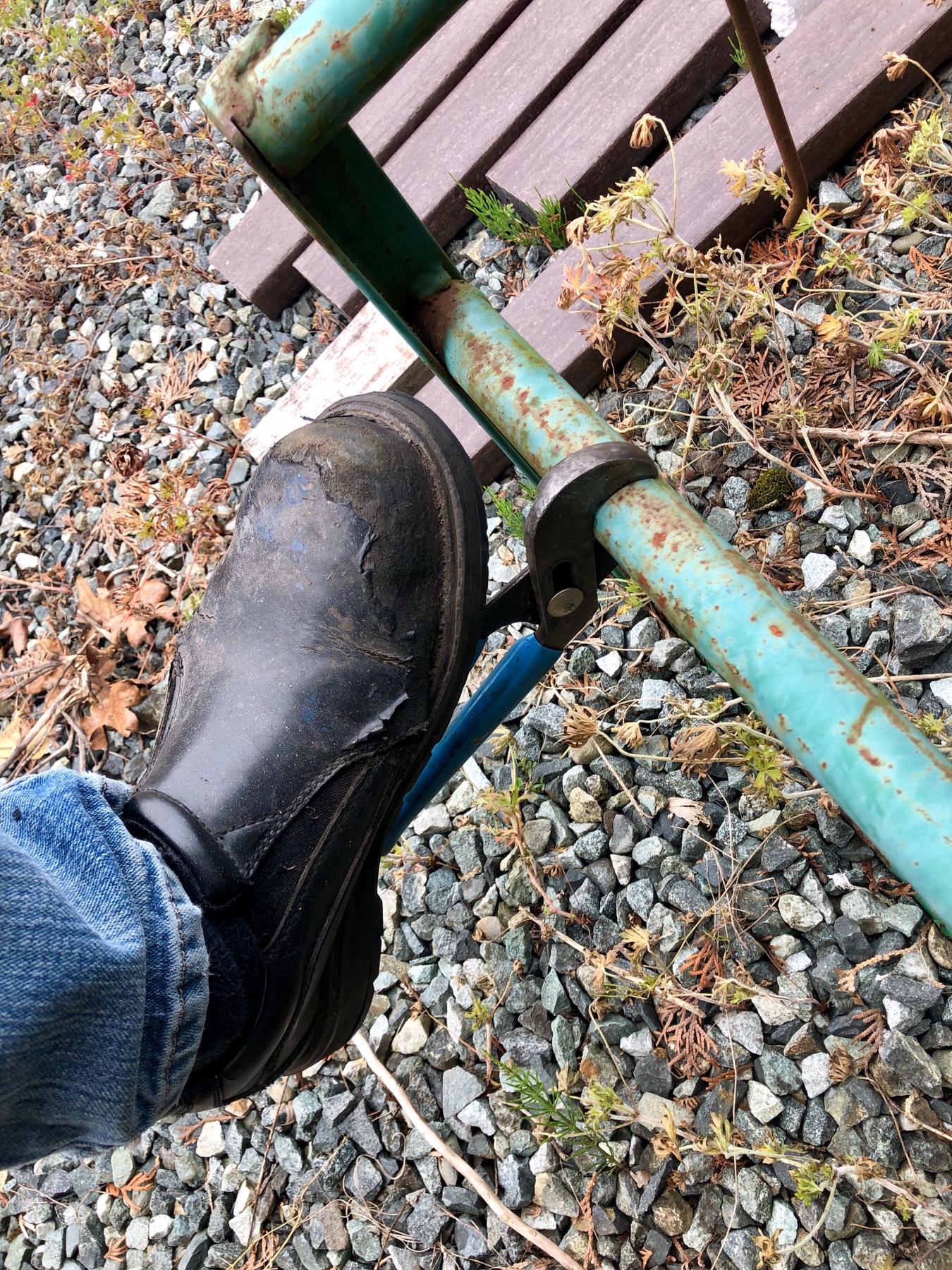

Have you used one? I take them any day over my pipe wrenches.
I don’t have any Knipex pliers but I’m quite certain they would work. Here’s some pics I just took of my 40 year old Channellock 410 pliers.
Pipe
Square head plug
Pipe
I stood on the tool with full body weight and it didn’t lose its grip. Couldn’t manage to balance myself to take the picture with phone at same time so you’ll have to take my word for it. Coordinated I’m NOT.
