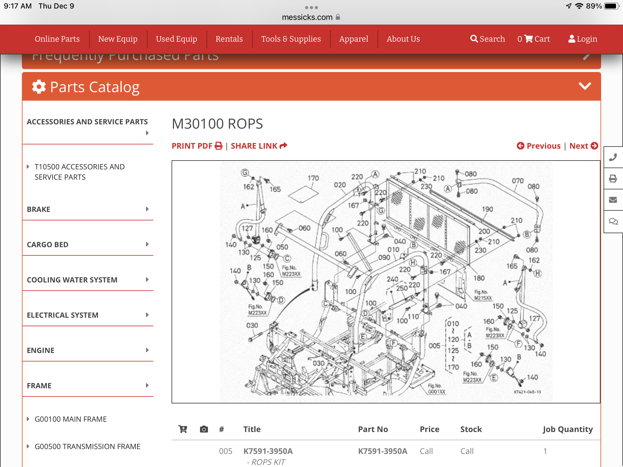

/ RTV ROPS - beware #23
Looks like the front passenger side pillar broke right about where there is normally a grab handle welded on. Without more information I wouldn't conclude anything, but offhand, when that breaks you are down to three pillars and the ROPS won't be able to resist loads nearly as well. It folded up just like I'd expect with that particular pillar gone.
/ RTV ROPS - beware #24
This is what it would have looked like before, seems like it broke near one side of the grab handle.

That is unlikely to be the initial/primary failure. That is more likely to be a secondary failure. I can expand on the logic if needed.
/ RTV ROPS - beware #27
Can you get closeup pictures of the fracture on the upper end of the pillar, both at the roof/gusset and the end of the tube?
