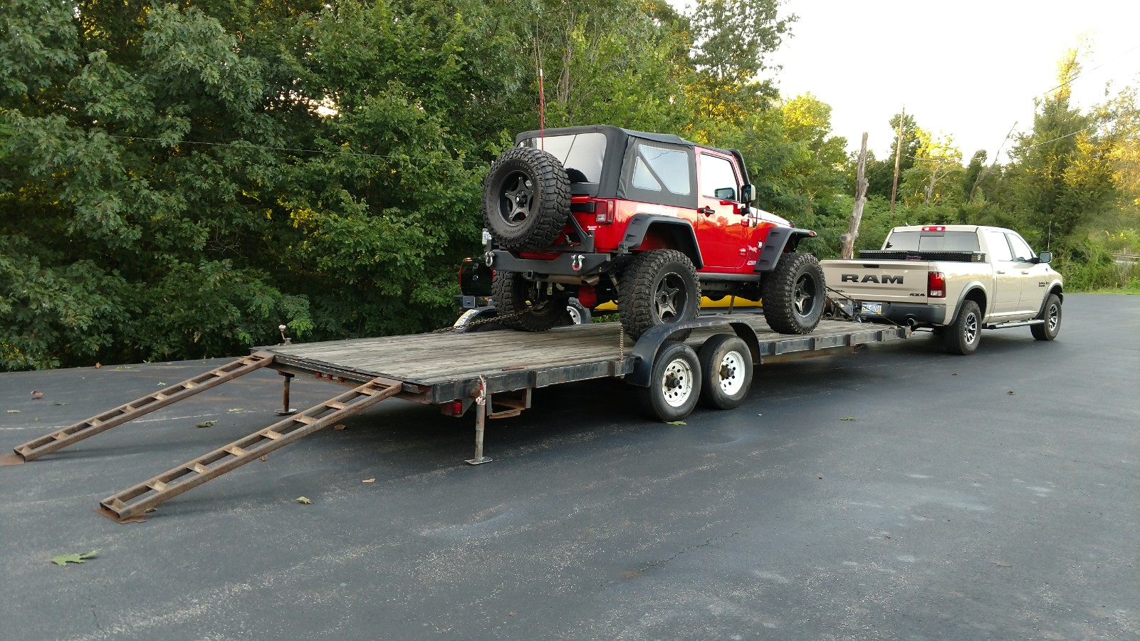

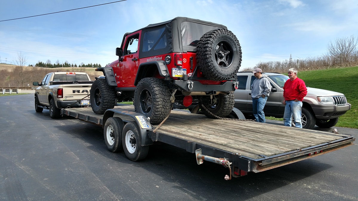

Set your trailer up correctly and you will not lift the rear tires of the truck. Your rear tires lifted, not the front. This is the proper way to load a trailer.....

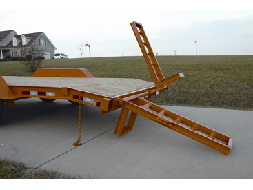

Careful with the drop leg systems or anything attached to the rear of your trailer. Eventually one will be down or fall down while your moving and you will bend or break it.
Every attached rear system that I have seen has eventually been bent or they have broken them off. Plus the drop legs are in the way of loading/unloading wide stuff at the rear of the trailer.
My trailer has drop ramps.
They don't bend.
