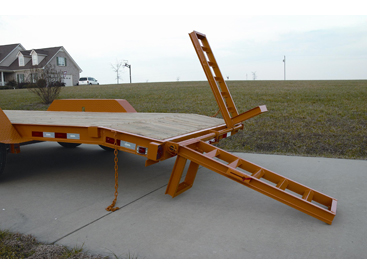

Many ramps have a leg built in to prevent what you are dealing with...
Or like mine and others, legs on the trailer itself that can be lowered and pinned in place. I carry blocks in my trailer-mounted junk box to use under them to make sure they have substantial footing.
I've had several boat trailers but this (the one for my BX) is my first of this kind. The dealer made sure he included a couple of runaway truck/trailer horror stories when I took delivery. And I'm darned grateful. Pretty sure I wouldn't have thought of it until the exciting ride began...
Z.
   / Runaway truck and trailer with me driving the tractor on it! #27
My trailer has drop ramps.
They don't bend.
Adding drop legs or jacks to the rear of the trailer was what I was referring to. Not drop ramps.
I should have been more clear.
This.
Having those legs is just one of the reasons I like standing trailer ramps. Those legs prevent what happened to the OP plus reduce the overall stress on the trailer to boot.
   / Runaway truck and trailer with me driving the tractor on it! #28
I have drop legs on my 14k trailer but would have loved drop ramps. All-in-one solution.

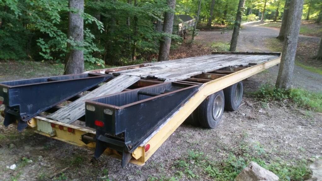

My big trailer has double hinged ramps so they don't get hung up on uneven ground. I've had the style with the fixed support on the ramp get stuck once loaded. 20170621_182943.jpg
And yes I know I need to replace the deck.
