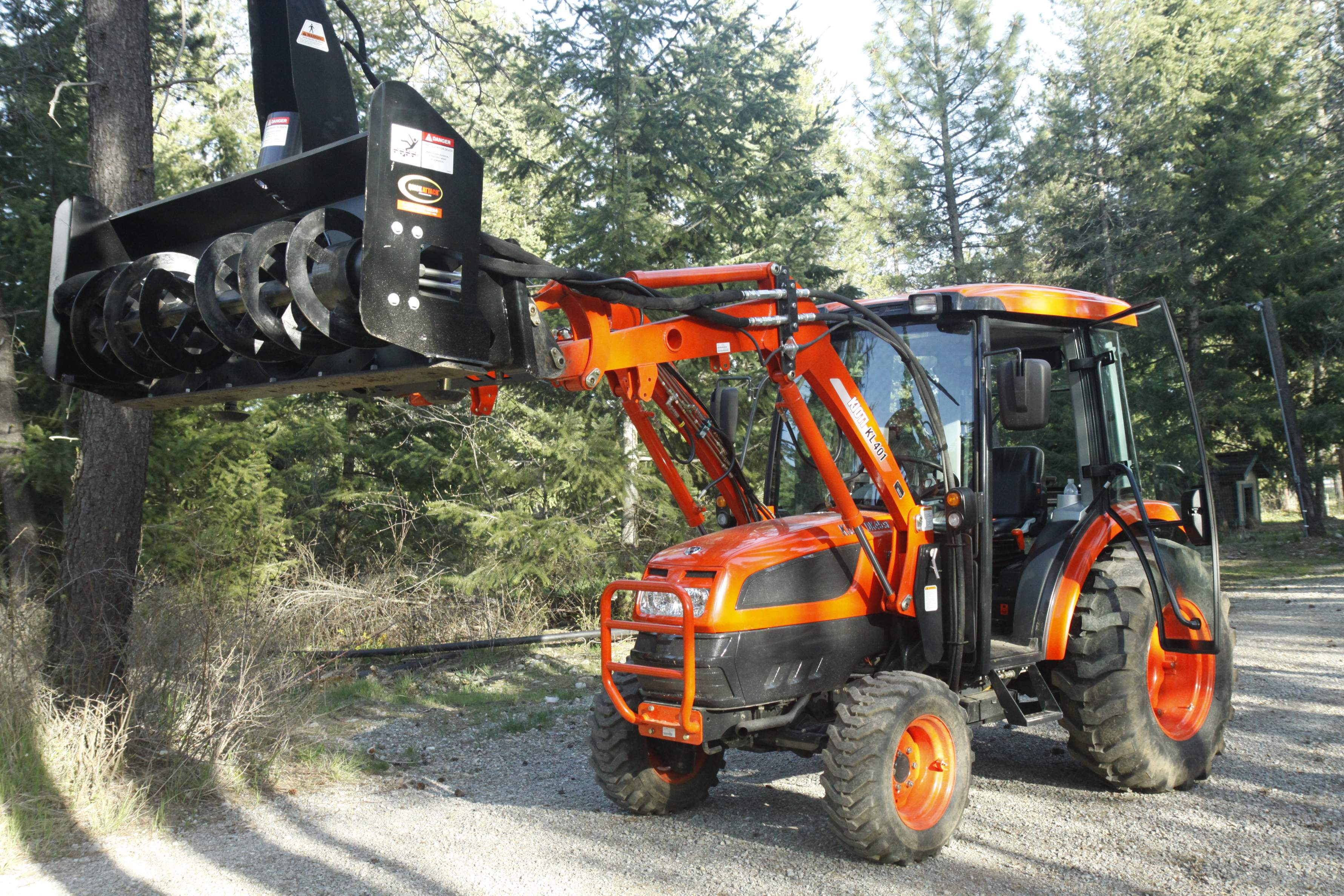

im not sure why you wouldnt like the idea of a pto powered hydraulic pump???
i looked into the front mount pto driven option for my snowblower, but i have to move large 5' tall piles of snow when my buildings shed off. I have 3 outbuildings that have to be cleaned when they shed so the animals can enter and leave and so i can move my equipment for my business around.
The loader mounted blower can blow at any height above the ground.
once you take this into consideration along with the 3,000 PSI, 15 GPH output of the power pack, i found that the rear hydraulic system was better than the front mount.... for my applications.
Now i can always add a hydraulic loader mounted post hole digger or ???? in the future. I can now officially run ANY skid mount piece of equipment i can find... and there are soo many nice looking toys out there.
as in the picture below... just try to do this with a front mount 3 point or front mount snowblower
Don't get me wrong, I'm not putting your type of system down. I was looking at a 25 GPM model that will run some pretty stout skid steer attachments. I guess the front 3 pt just seems to make a tractor so versatile (guess that's why they came up with the tractor name "Versatile").
I'm looking at it more for a mower than a snowblower. Gotta watch the weight of the mower. My loader won't lift the heaviest ones. When you lift mowers that high, you gotta watch for flying debris...:eek:
The other disadvantage of the pump is the rear of the tractor is now taken, no attachments can be run off the back. The front 3 pt allows both ends of the tractor to have a attachment mounted to it.
