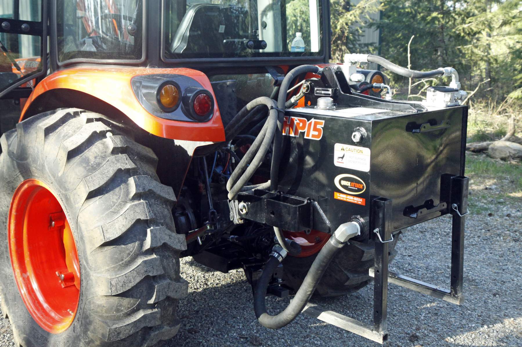

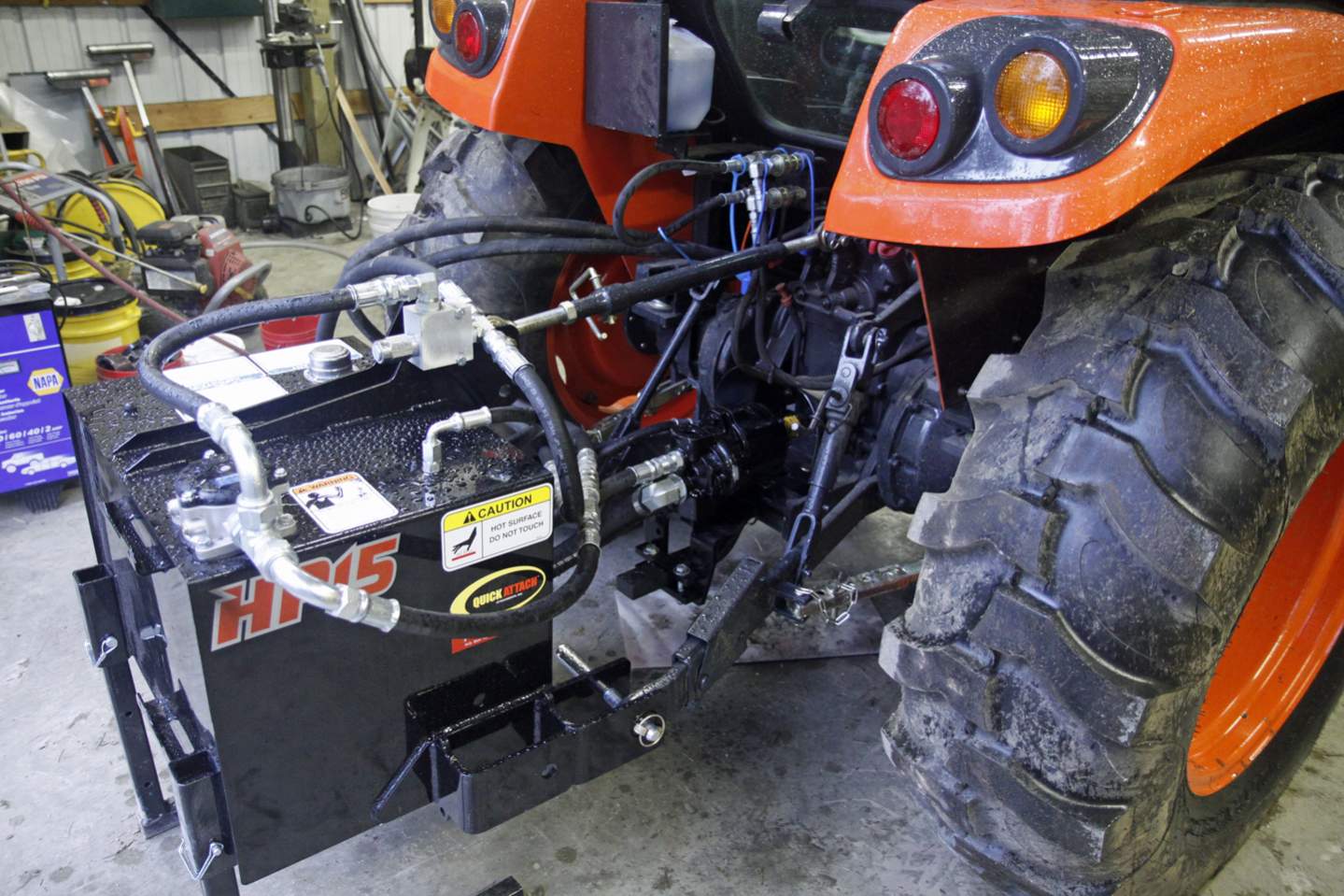

Yes, i ran the hoses from underneath the cab up the arms and down to the bucket. I made my own mounting brackets for the hose to mount thru the winter. I remove the entire thing come spring. I could leave it on 24/7, but i really don't need it in the summer (for now??).
The hose kit comes with both front and rear quick connects so you can drop off the powersupply anytime you want as follows.
1. Lower unit onto self mounted adjustable skids.
2. Unhook 3 point hitch
3. Unhook Quick connect from 2 hoses (supply and return) at the hydraulic tank (about 10 seconds)
4. Remove hydraulic pump (this unit slips over drawbar and slips into splines. Then theirs a bolt on bracket that secures it. Loosen t bolts and slip it off, then remove pump...about 1 minute tops)
5. drive away
i have only a few pics.. ill get some more tomorrow and post them if youd like. These show the brackets before powder coated everything

OK, here's what I don't get. Why is it so much more to buy an assembled unit than to buy the pieces? Just looking at Surplus Center, I see that you can get a 9.74 ci motor with a splined shaft rated at 20.8 HP continuous for $225(Surplus Center - 9.74 cu in VON RUDEN MLHS160S4A HYD MOTOR .
A PTO mount pump that's 9.9 ci and rated for 21 gpm and 32 HP is $526(Surplus Center - 9.9 CU IN PRINCE HC-PTO-1AC PTO PUMP CI 540 RPM).
A 25 gallon reservoir is $227 (Surplus Center - 25 GALLON HYDRAULIC RESERVOIR)
Allow another $500 for hoses, fittings and a valve and you're out the door under $1500. With the pump and the motor having the same displacement you don't even really need a valve, they will spin at the same rate and you control the motor by controlling the PTO.
Am I missing something?
By the way I think this is a great idea and it's something I've given some thought to in the past.
* I realize this is only rated for 474 RPM continuous, 563 intermittent, so it's not quite right for this application, I just picked it as a quick illustration of what's available.
also.. my unit is 3,000 PSI. the pumps and equipment your specking out is 2,200 PSI. None of the pumps at surplus center will go 3,000 PSI. These eaton pumps are real spendy.

what your missing is reality, surplus store is like a industerial dollor store, they buy alota surplus stuff, and like the dollor store, maybe it stuff cleaned up after a truck wreck,..John Deere/ Land Pride, and the likes dont use surplus parts to build there equipment,.
   / running high gpm attachments out front? #36
Another problem with that pump is it only goes up to 2000 psi, a 3000+ psi pump is much more expensive.

im not sure why you wouldnt like the idea of a pto powered hydraulic pump???
i looked into the front mount pto driven option for my snowblower, but i have to move large 5' tall piles of snow when my buildings shed off. I have 3 outbuildings that have to be cleaned when they shed so the animals can enter and leave and so i can move my equipment for my business around.
The loader mounted blower can blow at any height above the ground.
once you take this into consideration along with the 3,000 PSI, 15 GPH output of the power pack, i found that the rear hydraulic system was better than the front mount.... for my applications.
Now i can always add a hydraulic loader mounted post hole digger or ???? in the future. I can now officially run ANY skid mount piece of equipment i can find... and there are soo many nice looking toys out there.
as in the picture below... just try to do this with a front mount 3 point or front mount snowblower
