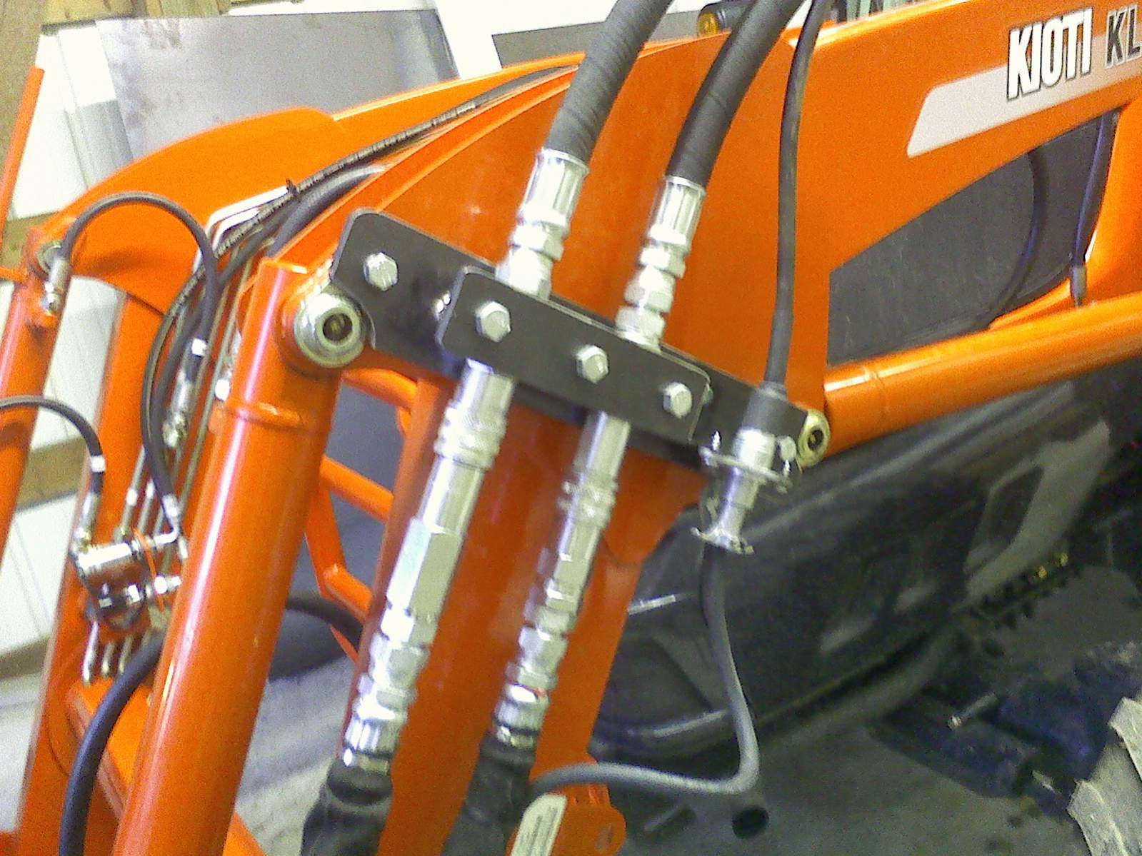

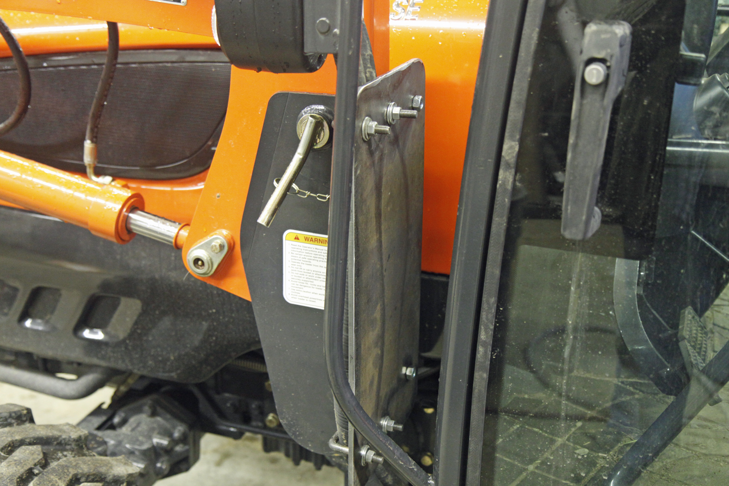

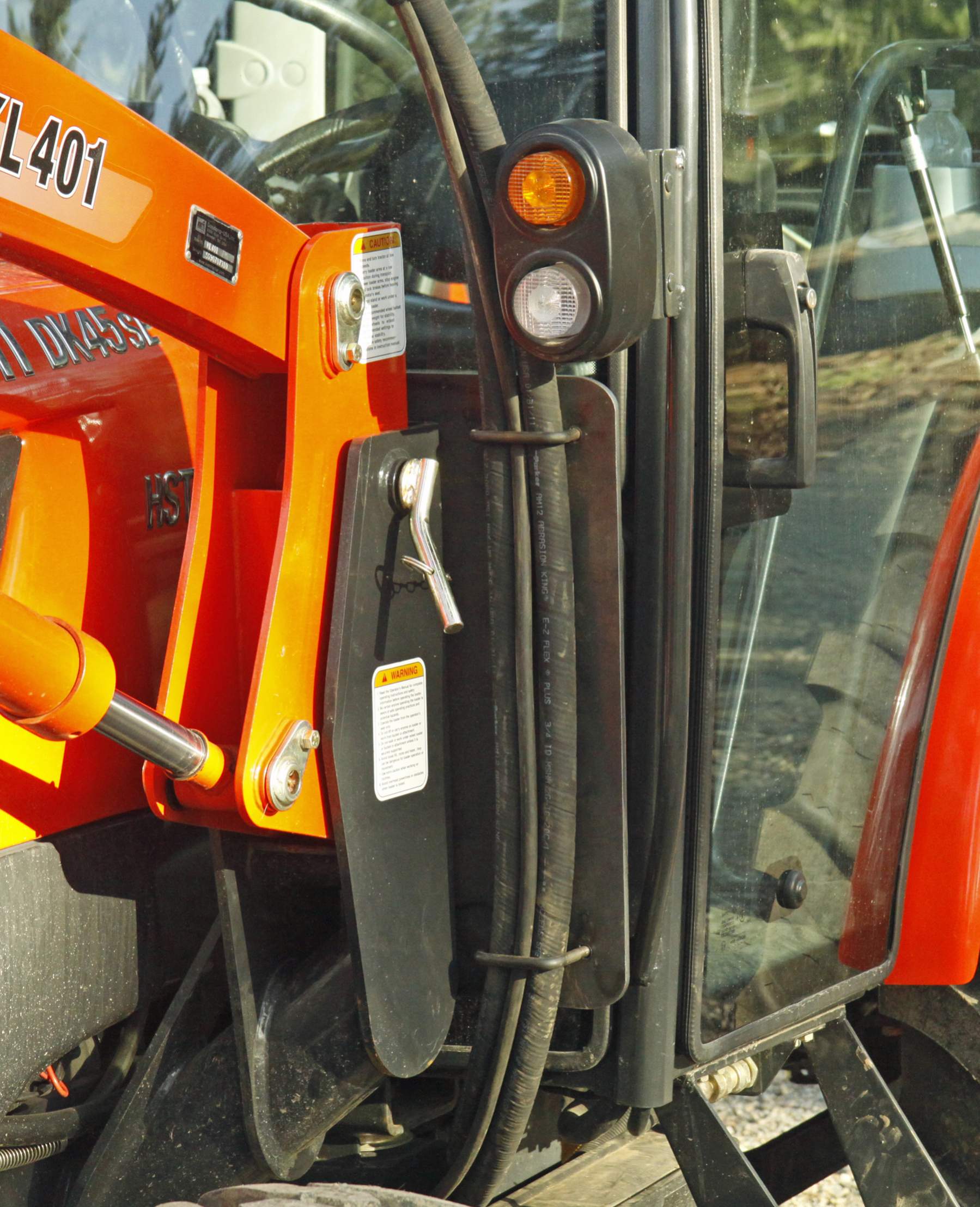

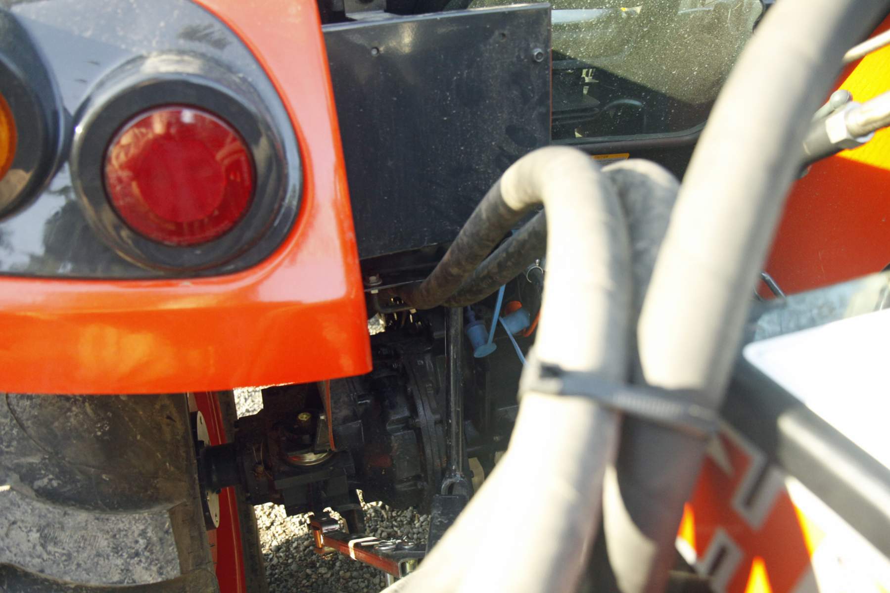

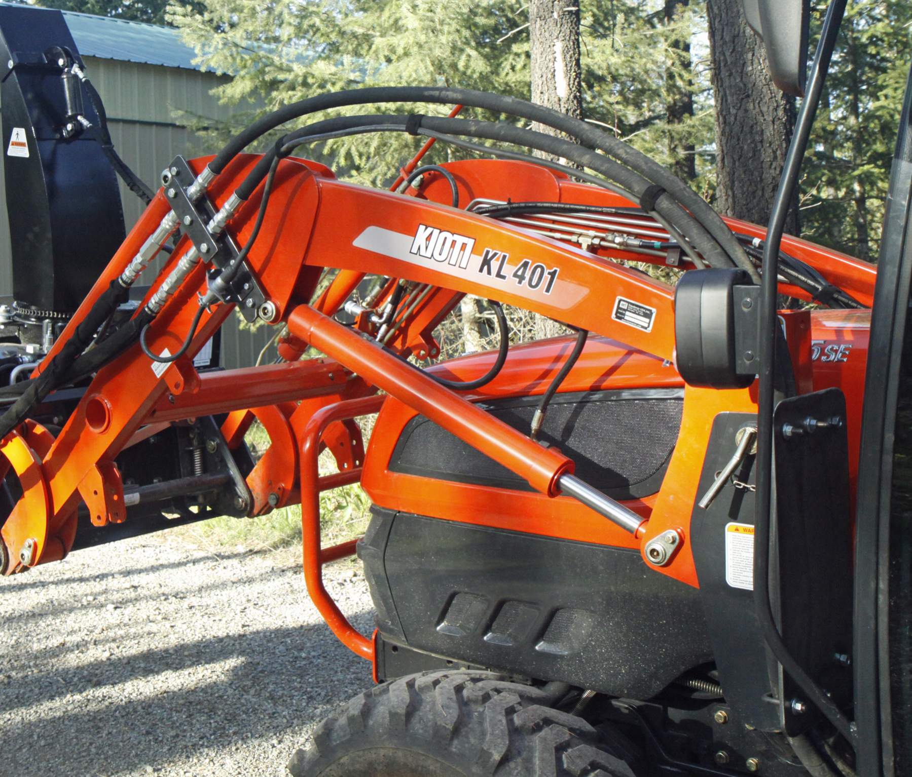

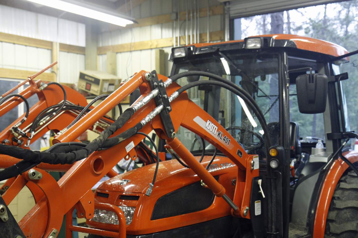

Yes, i ran the hoses from underneath the cab up the arms and down to the bucket. I made my own mounting brackets for the hose to mount thru the winter. I remove the entire thing come spring. I could leave it on 24/7, but i really don't need it in the summer (for now??).
The hose kit comes with both front and rear quick connects so you can drop off the powersupply anytime you want as follows.
1. Lower unit onto self mounted adjustable skids.
2. Unhook 3 point hitch
3. Unhook Quick connect from 2 hoses (supply and return) at the hydraulic tank (about 10 seconds)
4. Remove hydraulic pump (this unit slips over drawbar and slips into splines. Then theirs a bolt on bracket that secures it. Loosen t bolts and slip it off, then remove pump...about 1 minute tops)
5. drive away
i have only a few pics.. ill get some more tomorrow and post them if youd like. These show the brackets before powder coated everything
