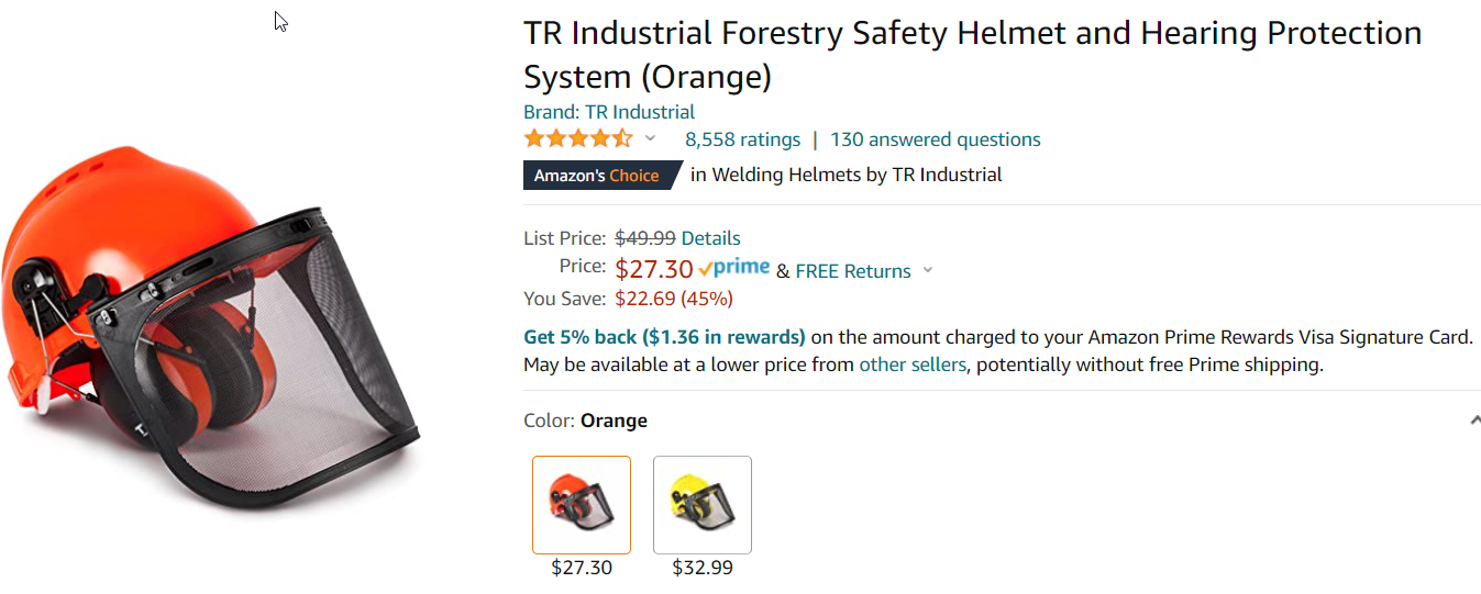

Safety glasses were always a last-second thought and figured better equipment was probably too expensive for a part-timer. When I started clearing a home site, I chased this down. The price wasn't bad at all and it beats the heck out of glasses when you are sweating. The ear muffs hold the hat in place and face shield works very well. I won't go back to just glasses ever.
   / Safety chaps testing - Saw Damage? #29
I wear one of those. Plus, if running saw all day I wear ear inserts... otherwise I will still hear the saw running all night. My hearing is bad enough, I am trying to preserve it.
   / Safety chaps testing - Saw Damage? #30
I bought the hard hat/shield/muff combo after cutting a big dead red elm and as it fell, Spears were raining down from the tree top and were sticking in the ground all around me. It was a RUN situation like many before.
