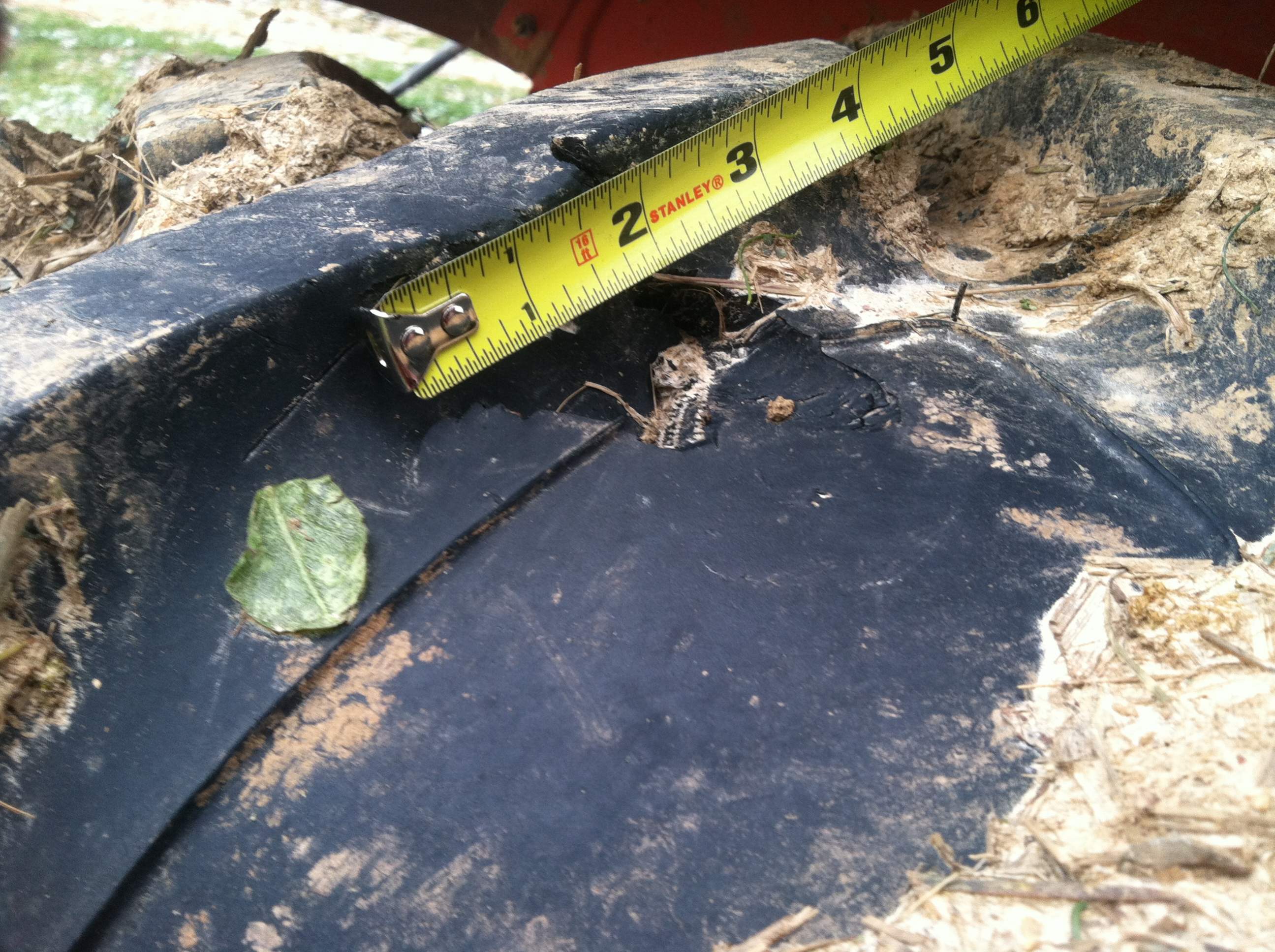

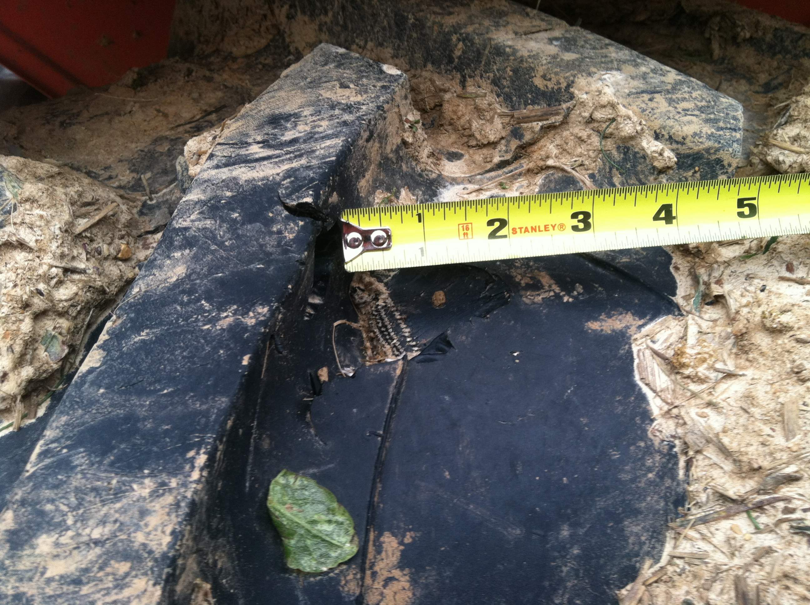

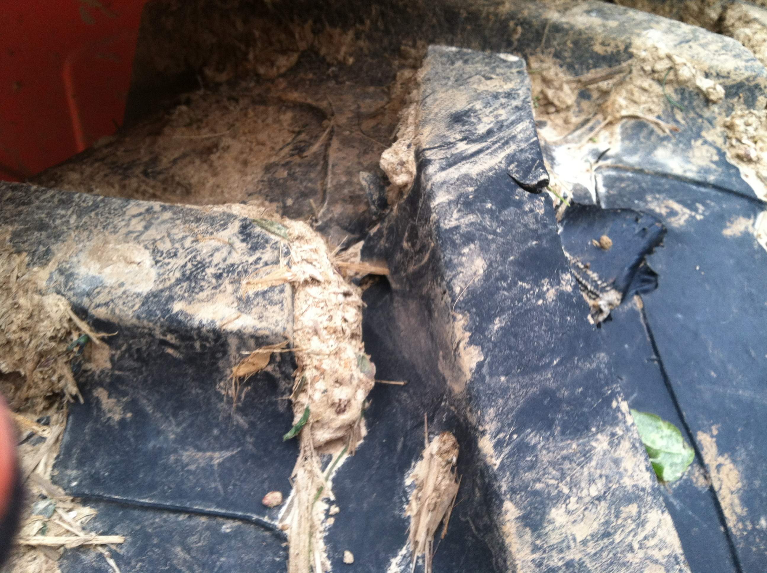

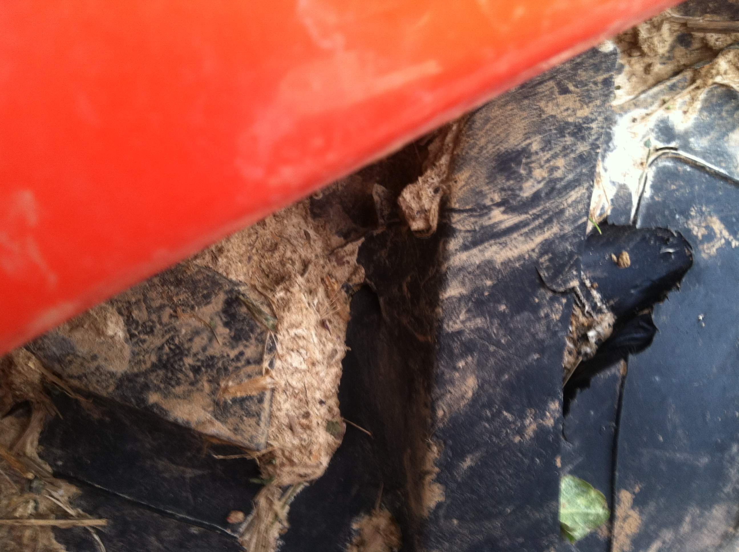

Something terrible happened to me this week. I was driving near a old fence row that I had torn out and I ran over something very sharp with the rear tire. It went flat in less than two minutes and I lost almost all my fluid. The tractor has less than 150 hours on it and I think it is too big to patch from the inside. :( I d@mn near cried.
Free Service Tire says they CAN NOT get the exact tire, TITAN 18.4 x 30 Radial, as it is OEM size only from Titan.:confused2:
So I call my dealer and he can get the tire but I have to buy the whole wheel with the tire, not just the rim. tire + wheel assembly + shipping = $$$$$
One other tire place said something about putting it back in a mold and through some sort of magic it would be good as new?
Bad news is its muddy and no one around has a 4x4 tire service truck. Good news is that I can do without it for a couple weeks. I am in no huge hurry to get it fixed other than the fact that I'm paying for it and I want it.
Am I crazy for wanting the same brand tire put back? I think it would matter less on a high hour machine.
I guess I'm looking for any thoughts, opinions or comments here.

As you have 150 hours on the machine and added to that the countless hours it sat on the dealer lot after it was shipped the decision is kinda moot as you need a new R1 bar tire and have to decide if you want a Titan and new rim to mount on it. A new replacement will be identical in rolling radius and tread design the only thing different is the name of manufacturer and the load rating if you do not specify the exact load rating as the original.
The other issue is that your tire has suffered a catastropic tread failure where the tread and bias plys have been compromised at the same time and the tire is unsafe to repair or use for that matter.
if you have calcium ballast in the tire you have to get it out of there to prevent rim damage and waiting 2 weeks for a repair is not good in this case.
there is no saving this tire as the play has been destroyed due to the puncture.

I would not be too quick to ignore what the other tire place told you about putting it back in a mold and making it as good as new...I had a nasty cut in one of my rear tires and I called a local tire company that fixes tractor tires and they are also re treaders...they make re tread tires...They came out and put a patch on the inside and refilled the tire and it was $100 even.... that was 2 yrs. ago and no problems at all since...I would really check out your options before giving up on that tire...Don't forget you can always patch the tire on the inside and get a tube...

If you can take the tire off in the field block the tractor up and remove it. Have a helper and put it on a truck and haul it to a competent tire shop. They can break it down and instantly know if its able to be repaired or what your best options are. A new tire that size isn't cheap, I replaced a 16.9-30 last summer and it costs over $900 for the tire, tube, fluid transfer and a small on site fee since I had them come to the farm.

Yeah I think I'll take it off and run it to the store. The problems with that are...
(1) I have TWO wheel weights per side AND cast wheel centers!!!! (heavy)
(2)When I set my front wheels out they were so tight my air gun just laughed at me, I had to go to a friends shop with a 1" drive air gun.
(3) Its is in the middle of 40 acres of pure red clay.
$900 ready to go would be a dream, I was quoted $1100 for just the tire before they figured out they couldn't even get it.
And Kubota wants close to $2k for the whole assembly.
As I sit here I was just wondering how far I could drive the tractor through grass and mud without causing damage to the rim?? I realize this would probably eat up the tire though.
