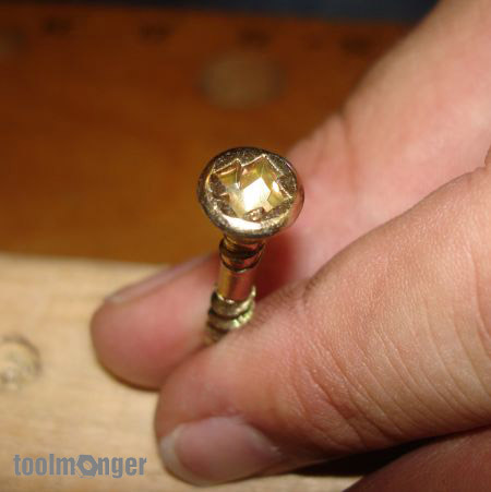

SteelDust,
I spent a couple of hours searching for the product you mentioned.
I could not find out anythng for a coated deck screw with a TORX head, however I did find it in stainless steel. Lowes is now carrying the Grip-Rite brand. Can you find a link or picture of this screw. There is another screw head out now called a LOX head. It looks like this, and has 8 sides.

I have a couple of boxes of the Torx head Deckmates out in my barn, this weekend I'll grab a picture or two.

I'm getting a kick out of this. Some how I've found DeckMates that are Torx and Spax that are square drive while others here are finding different. I wonder if it's a regional thing?

Maybe the Torx DeckMates are new stock? Ive seen Spax in both Torx and Pozidriv. So the Spax were worth the money in your opinion? Was there less splitting using them? I might start using them if their worth it.The place where i saw them forsale has stopped selling the exterior screws ( supposedly due to cost), and now only sells interior and eavesdrop screws so id have to go on the hunt to find them.
