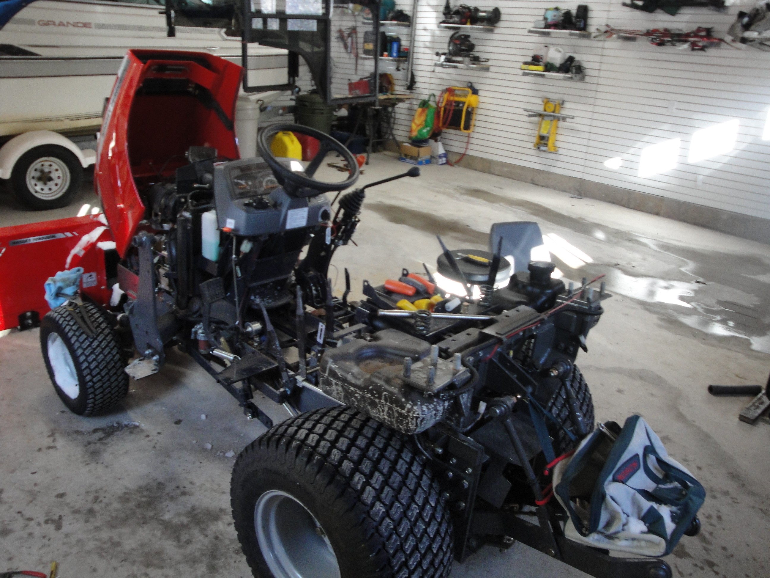

I had the recall procedure performed on my GC2600 today. I was at just under 50 hours so I scheduled the service (included with purchase) and recall be performed during the same visit. Both were done in about 3 hours, give or take, on my site which is about 130km from my very accommodating dealer (I removed the cab night before). The tech prefers to remove everything from the bonnet on back (I believe he mentioned they've done about 30) as the job goes a little quicker and easier that way. Anyways, I really don't have anything to add except some senseless jabberin about nothing. Here's a photo of the naked machine.
