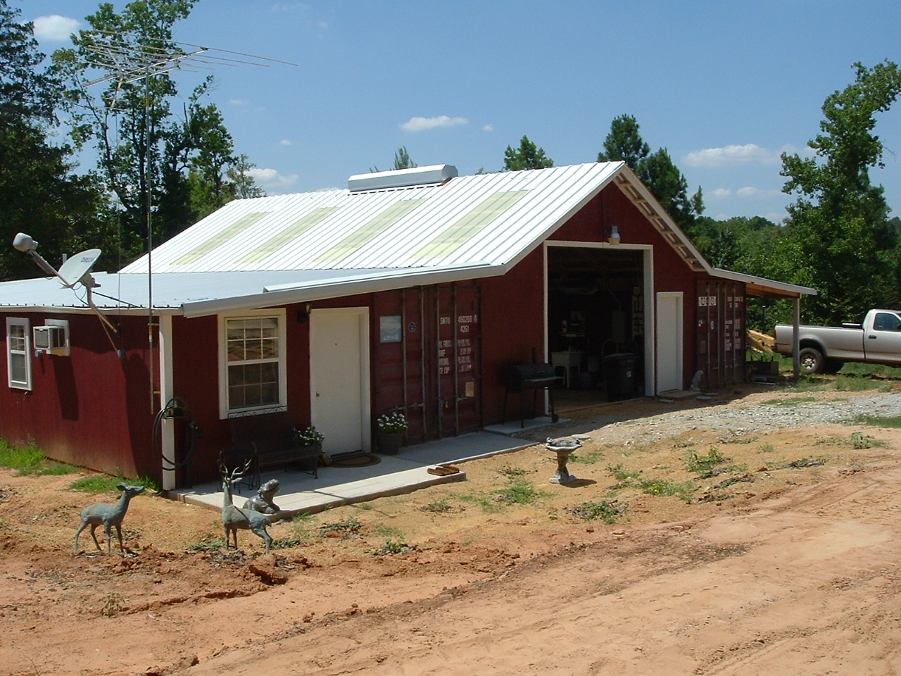

So I been thinking..... At times my Sweetie would say... "Now what ?"
I'm thinking it would be quick, easy, and hopefully economical to build a storage, shelter shed from shipping containers.
I want rodent and bear proof storage for livestock feed, hay, other equipment and directly out of the weather storage for implements and such.
For instance the one in the picture is super simple. It would be nice to have the full slab under it like the photo has, but not necessary. A pad at both ends of two, forty foot long containers. Depending on standard rafter lengths available, the containers a minimum of 12' apart. Rafters can be easily anchored to the containers with angle iron and bolts. Close in the gable ends and back end. Of course snow load here in the far north is a consideration.
Anyone done this ? Seen it done ? Thought of doing it ??
Facts, details, helpful info ?

I would set them on blocks that way it easier to level them after freeze, get some pressure treated truss's made they can span 40 feet, want 24-30 inch eve, at 48 overhang at the container doors. Road millings have them oil and roll it.

Major and really the only complaint I've consistently heard about container shops is condensation if they're not insulated and ventilated correctly. I'd have a setup like that in a minute.........Mike

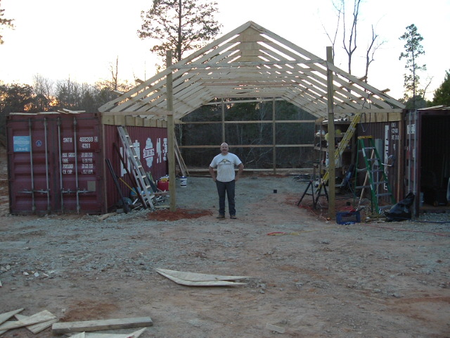

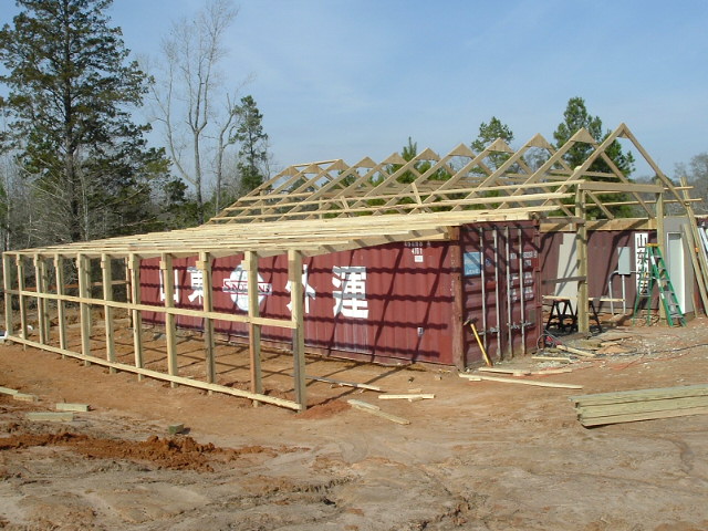

I built a shop from two containers about 15 years ago, give or take. I bought the containers to store stuff when I wasn't there because they where fast, affordable and fairly secure. After a year of working on the land I built a roof over them and walls between them. It was fairly simple to do, but not something that I would do again. They make poor walls and it's always a pain dealing with what's inside the containers. If you have the time, it would be much cheaper and better in the long run to just build a normal pole barn.
After my divorce, I created a small living area off of the side of one of the containers. I think it was 12 by 40.
Here are a few pics.
