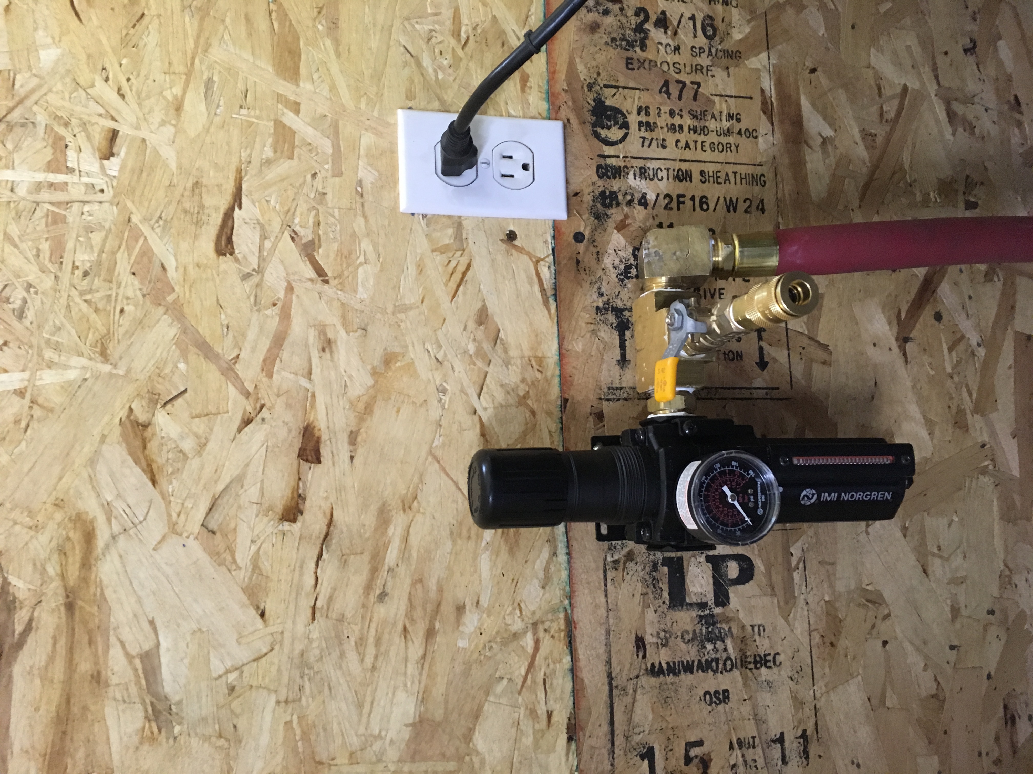

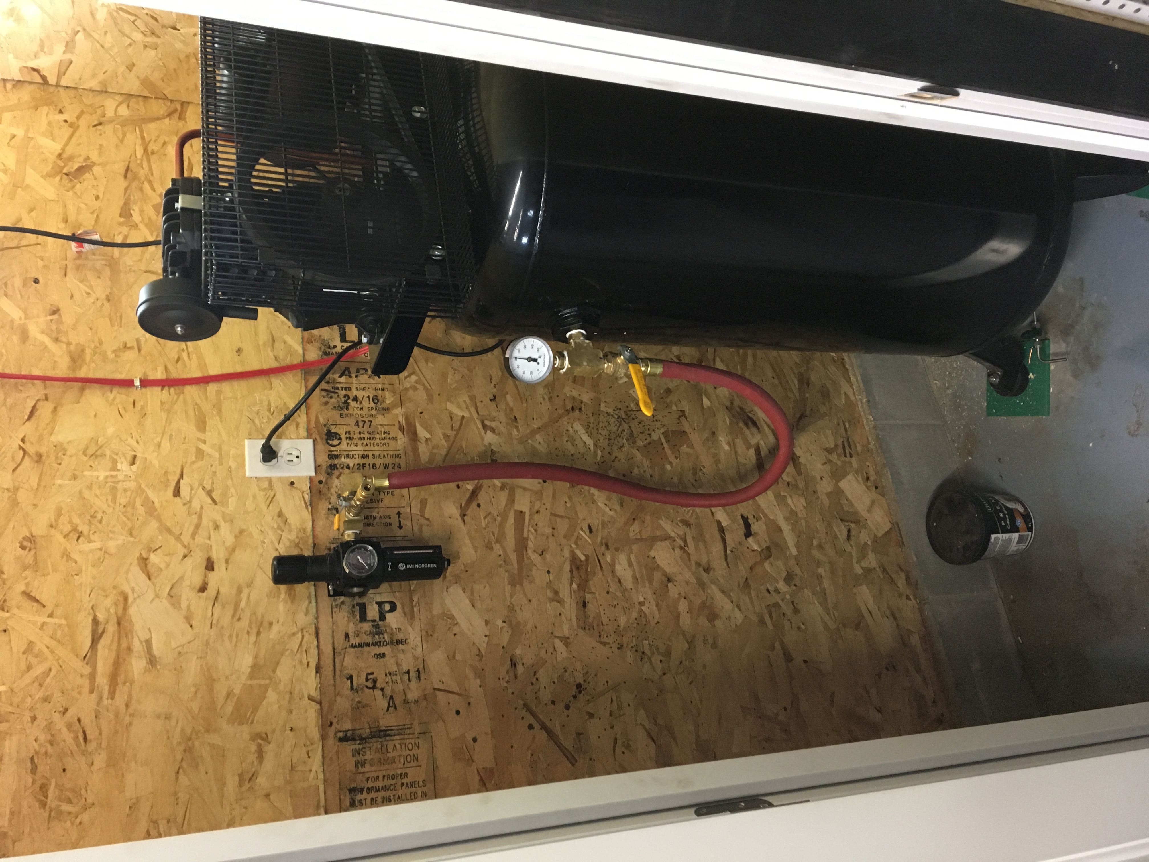

Just more general info about compressors. There are numerous discussions about using some types of plastic for air lines if anyone is not sure what to use. The other comment is that my shop is not heated all the time and can get to -30* F or whatever and I don't want my compressor coming on at that temp. For this reason and also if something happened to the compressor when I wasn't there I have it hooked into my shop lights with a rely so that it will only start when the lights are on. It's a 220 volt motor but the relay is connected to the 110 volt pressure switch I think. Don't ask how. My electrician did it. Also I had a 110 volt air valve so this is on the outlet of the compressor to keep air leaks to a minimum at the outlets and therefore the compressor is not running that often. I operate this valve remotely via a key fob and wireless adapter from Home Depot for about $35. Key fob is mounted near light switch so I don't loose it. A very small LED light is wired in also to let me know if the air is on or not. Hope this makes sense.

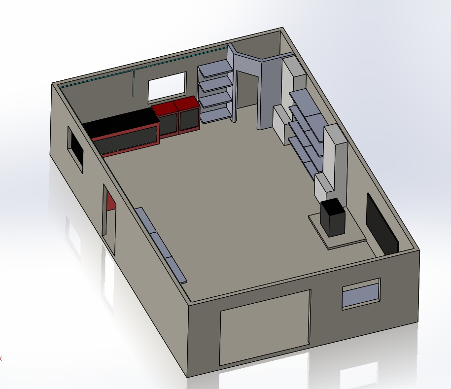

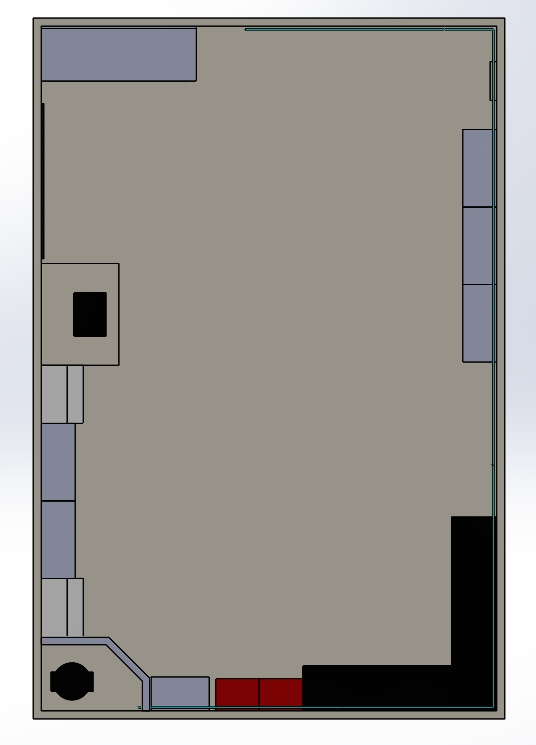

I'll have to make the "what pipe" decision in the new year. I'm leaning towards the Rapidair Maxline 3/4" kit, with one extra tee and outlet, but the exchange and shipping make it a hard pill to swallow.
my current dilemma is the closet size. the owners manual "asks" for 18" of clearance on all sides..... my current plan only allows for about 9" on three sides.
Besides annual oil changes... and the rare belt change what else should I worry about? if the compressor or motor go.. there is tons of clearance above the unit.
I've added some pictures to help show whats going on.... I'm hoping to add the compressor to the back corner of the shop
   / Shop Air Compressor set up questions? #50
View attachment 531876View attachment 531877
Have you ever considered building your “closet” on outside of your shop? Do you do woodworking where a whole shop dust collector might be in your future? Both compressors and dust collectors are big noise makers.
Having your closet outside would free up additional space in your shop? This could also increase maintenance acces as well.
My shop is too big ........... said nobody.
