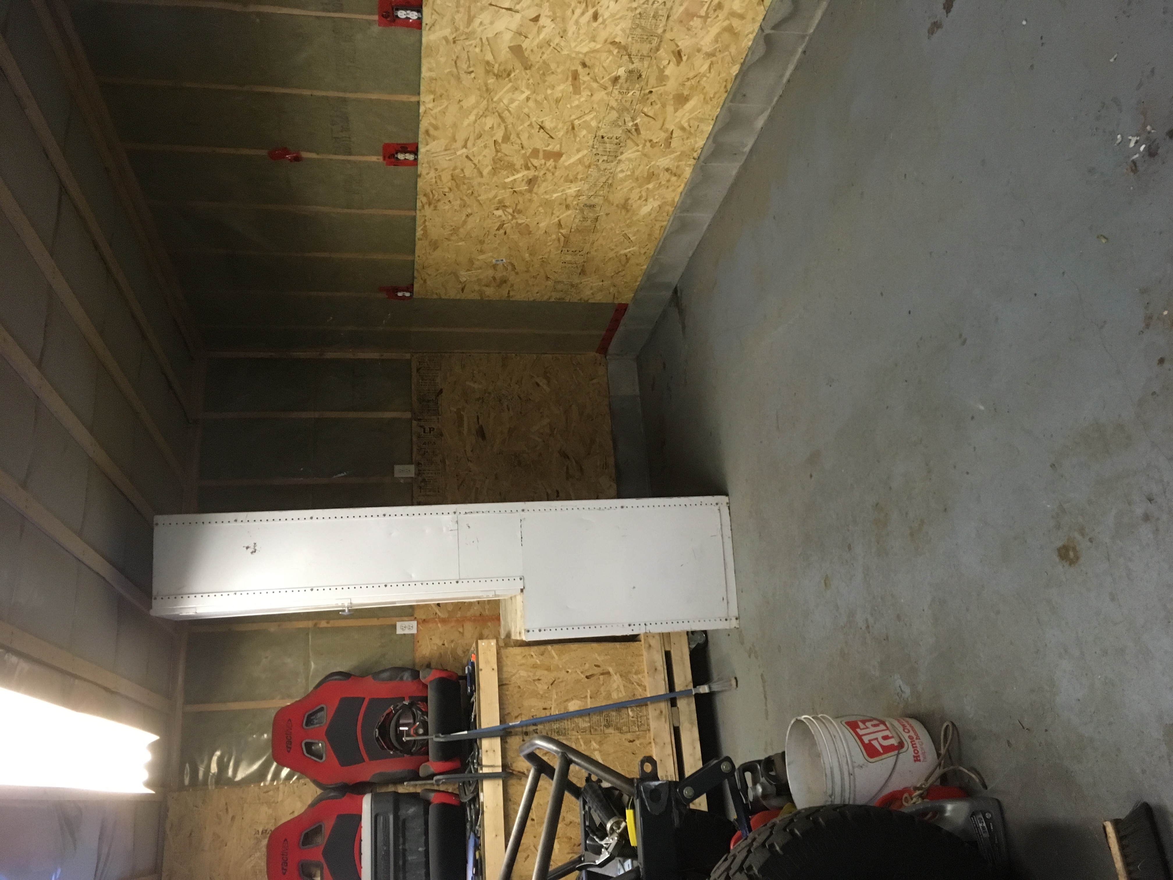

I go moving pretty quick on Saturday and didn't get a camera out till the afternoon.
I'd already put up OSB board on 1/2 the walls when I install my work bench, and had some extra material from another job. Unfortunately when we moved in we quickly set up 2 large shelving units to manage all my garage treasure. We didn't take the time then to sheet the walls. so the first step was to empty the shelf, and remove it.
PS all theses pictures are the corner where the compressor will go.

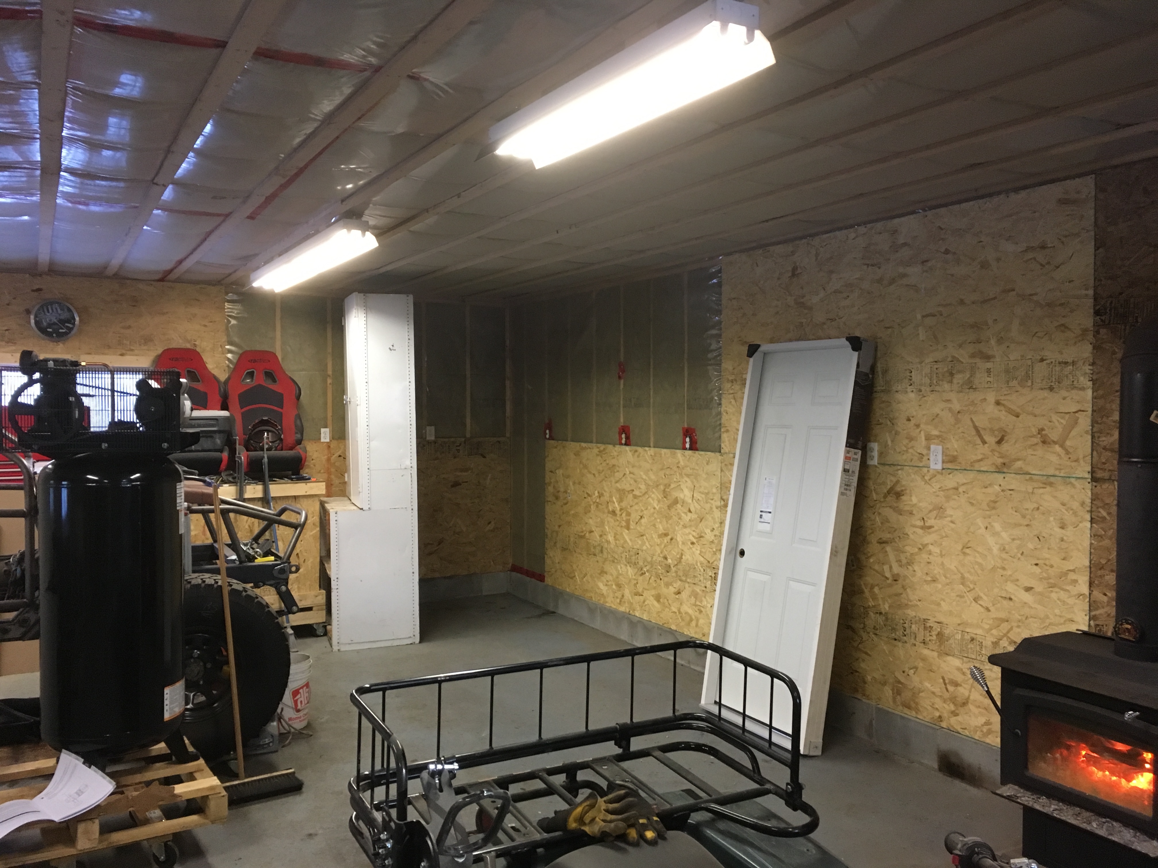

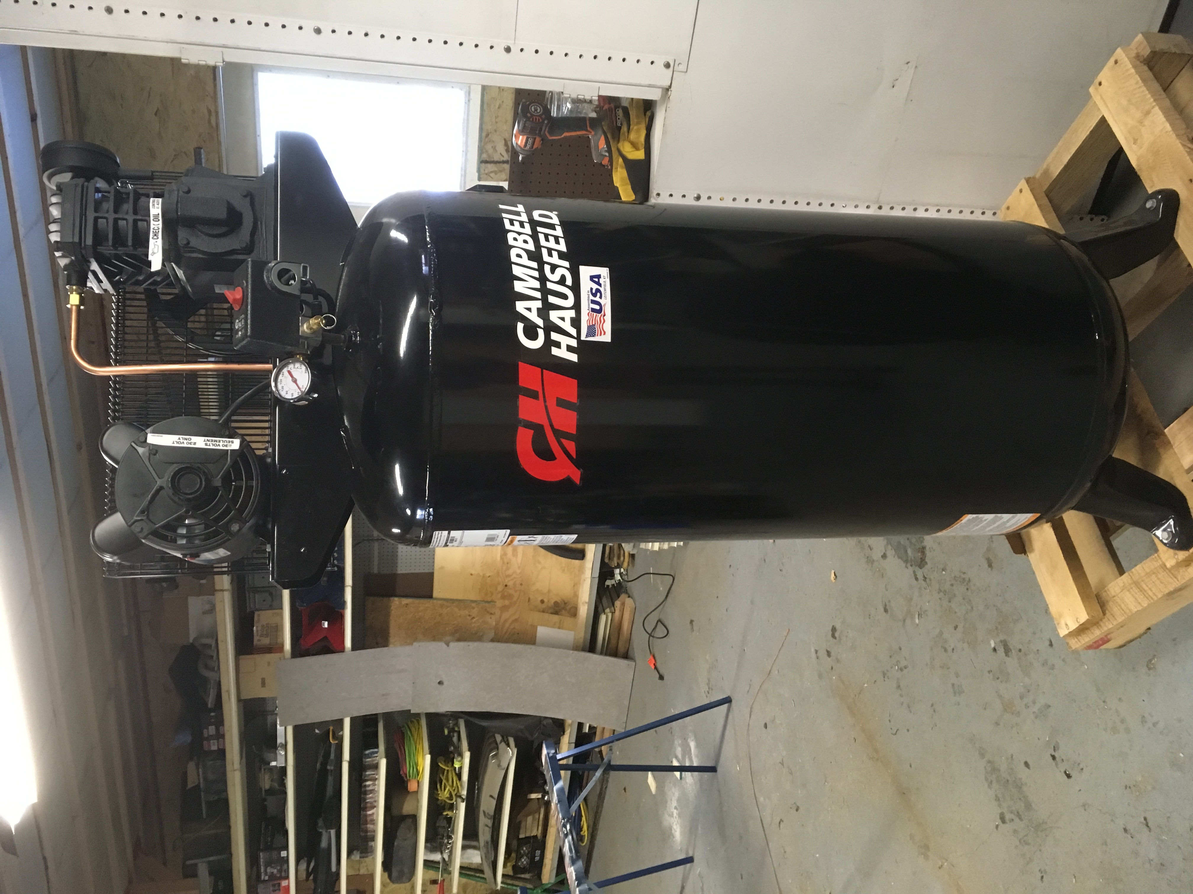

here is the compressor, waiting to get hooked up.

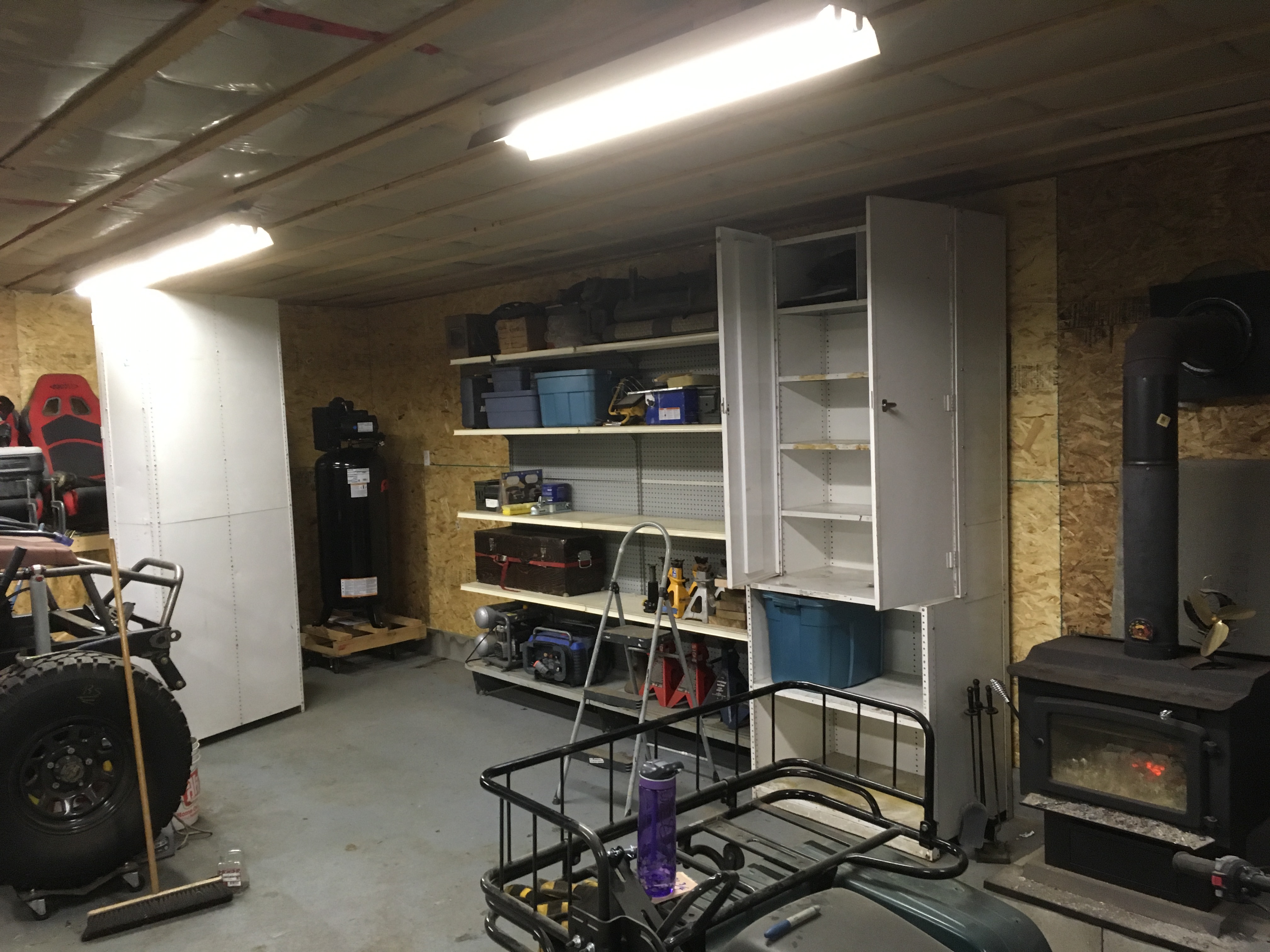

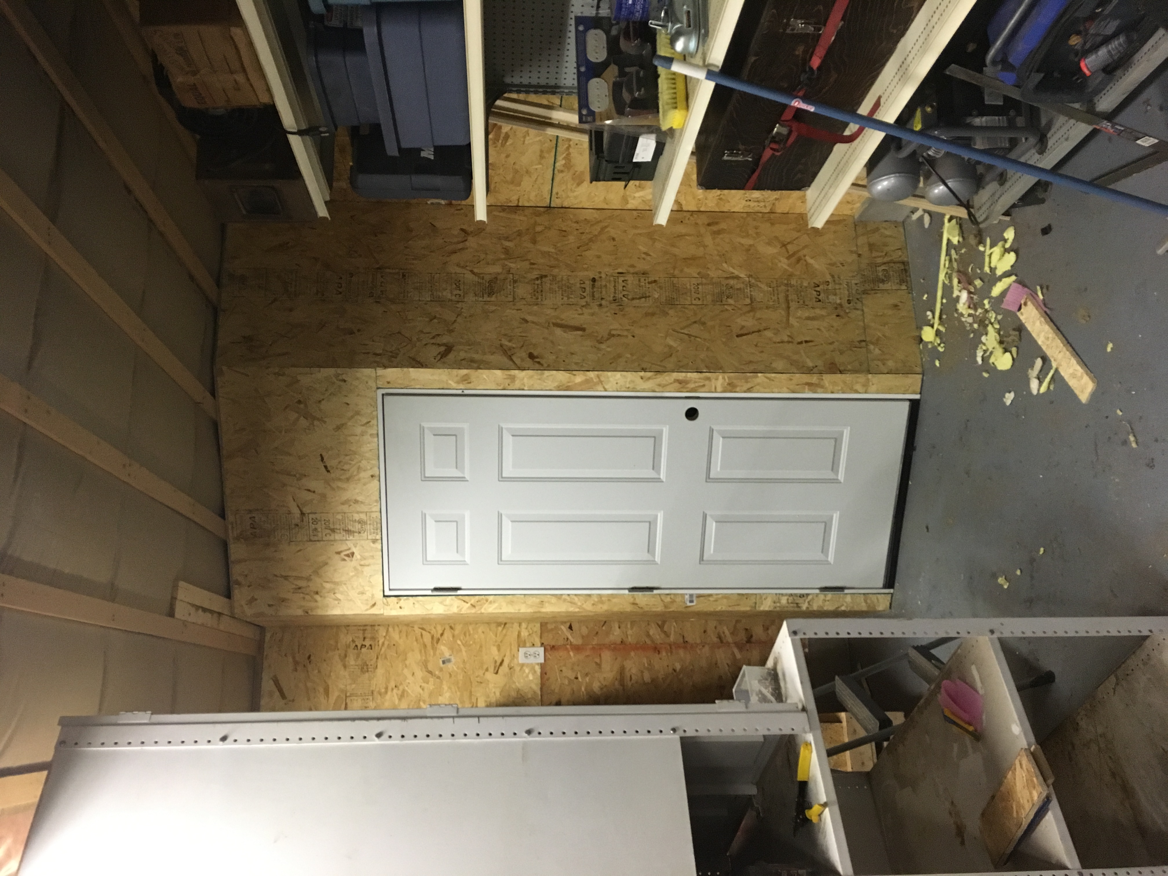

here's where I finished on Sunday night.
OSB is up on all the walls, both shelf units are back up.
I'm now ready to build the compressor closet.
My basic plan for the closet construction is 2x4 studs on 24" OC...... roxul insulation. OSB boards on both sides.... lots of Acoustic seal and spray foam for the gaps. exterior grade steel door (32")
I figure I'll try that, and if I need more sound deadening, I can add a layer of drywall on the inside.

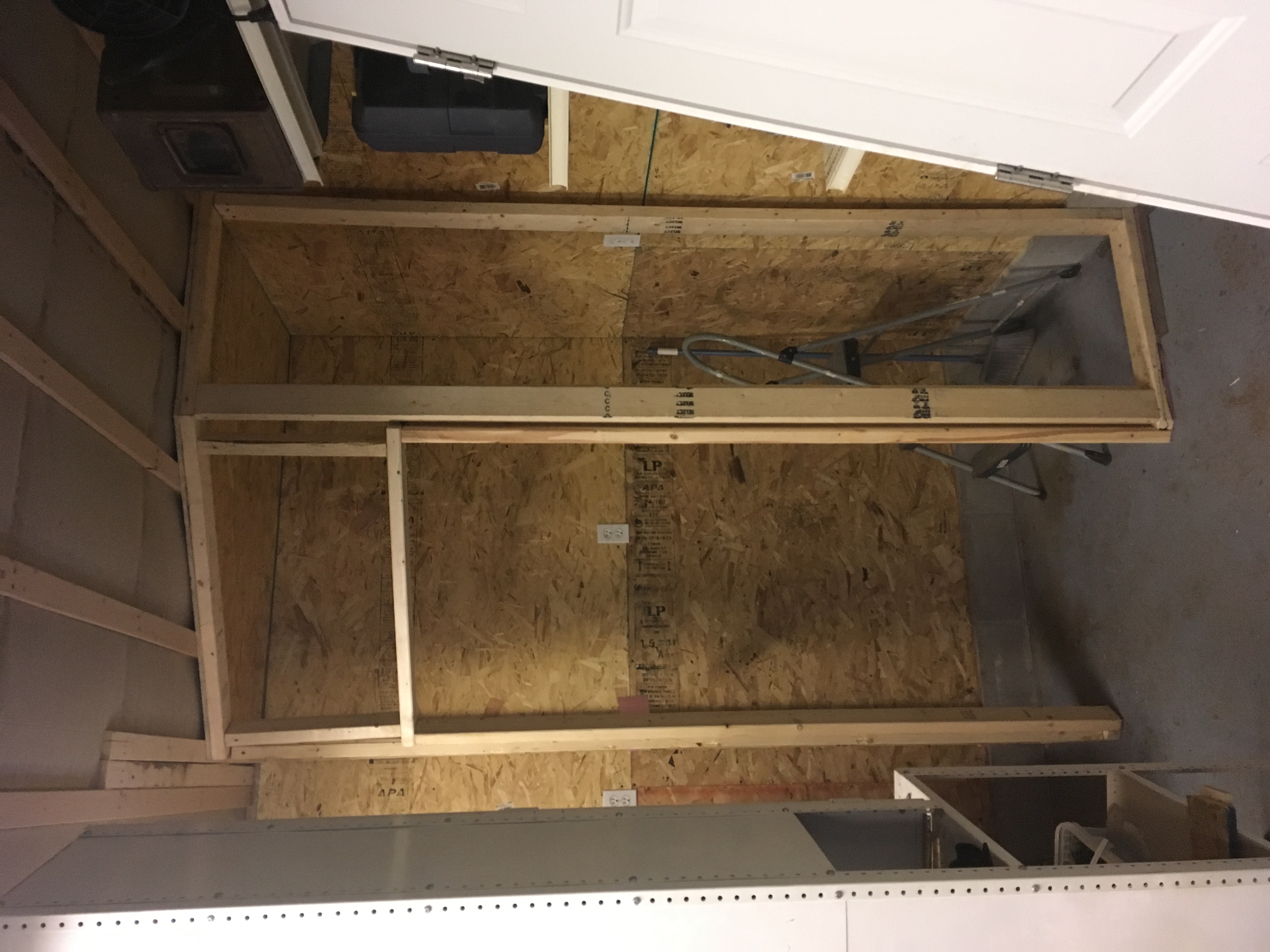

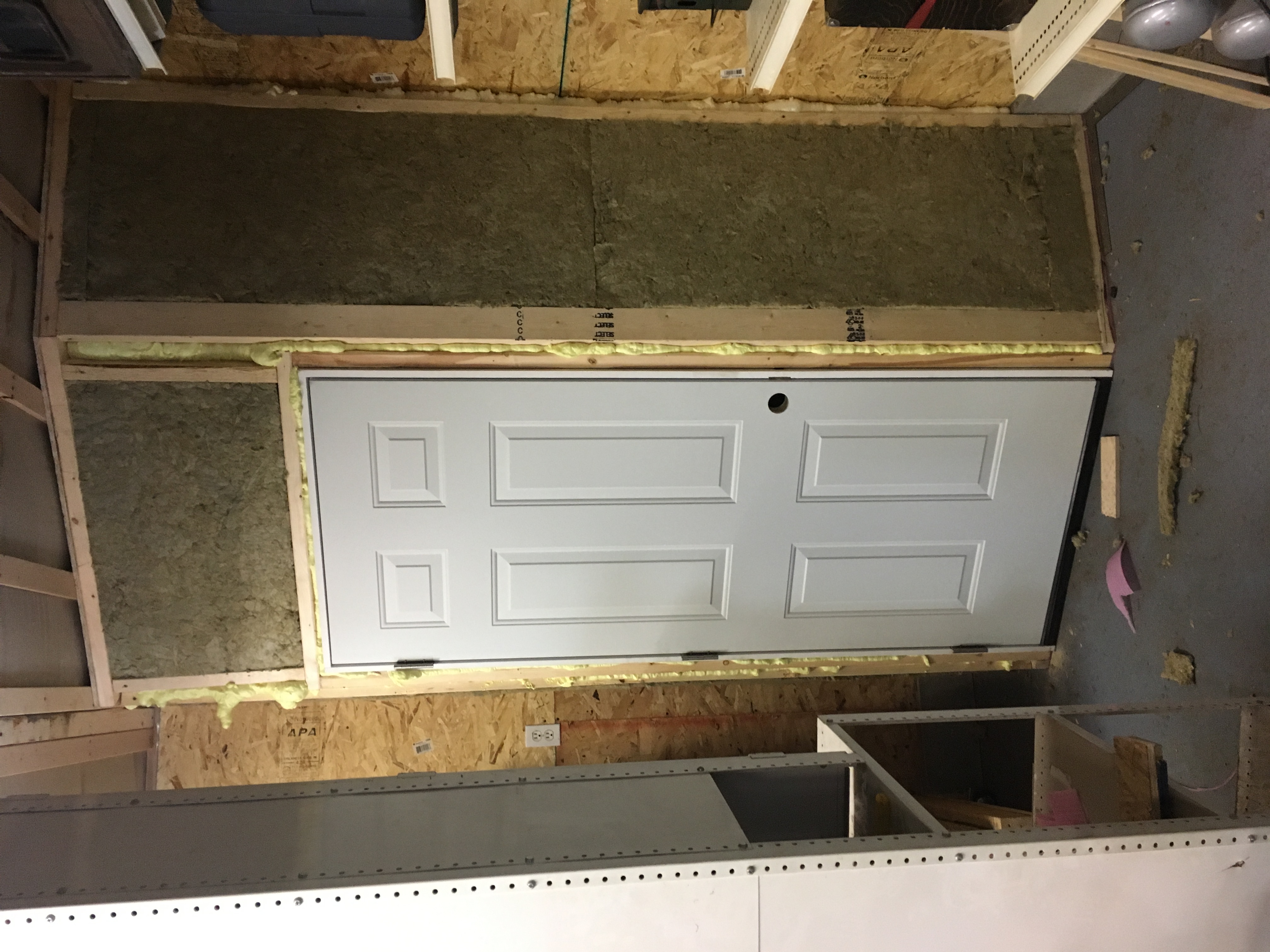

it was a busy weekend.
I decided to build the closet roughly 60" x 42" on the outside, with un-equal walls in order to accommodate some shelving I have.
I didn't realize how time consuming using the acoustical seal on all the joints was going to be. it almost doubles the work. the basic steps where, measure, cut, fit, mark, remove, apply sealant, re install, screw.
working alone, the dry wall hoist was a big help.
My ceiling height is about 8'8" which made a few things more complicated then they needed to be.
I put the sheeting up on the inside first, then installed the exterior door, spray foam and insulation.
I still need to trim out the door, and do a little bit of caulking in the inside, but the closet 98% done.
