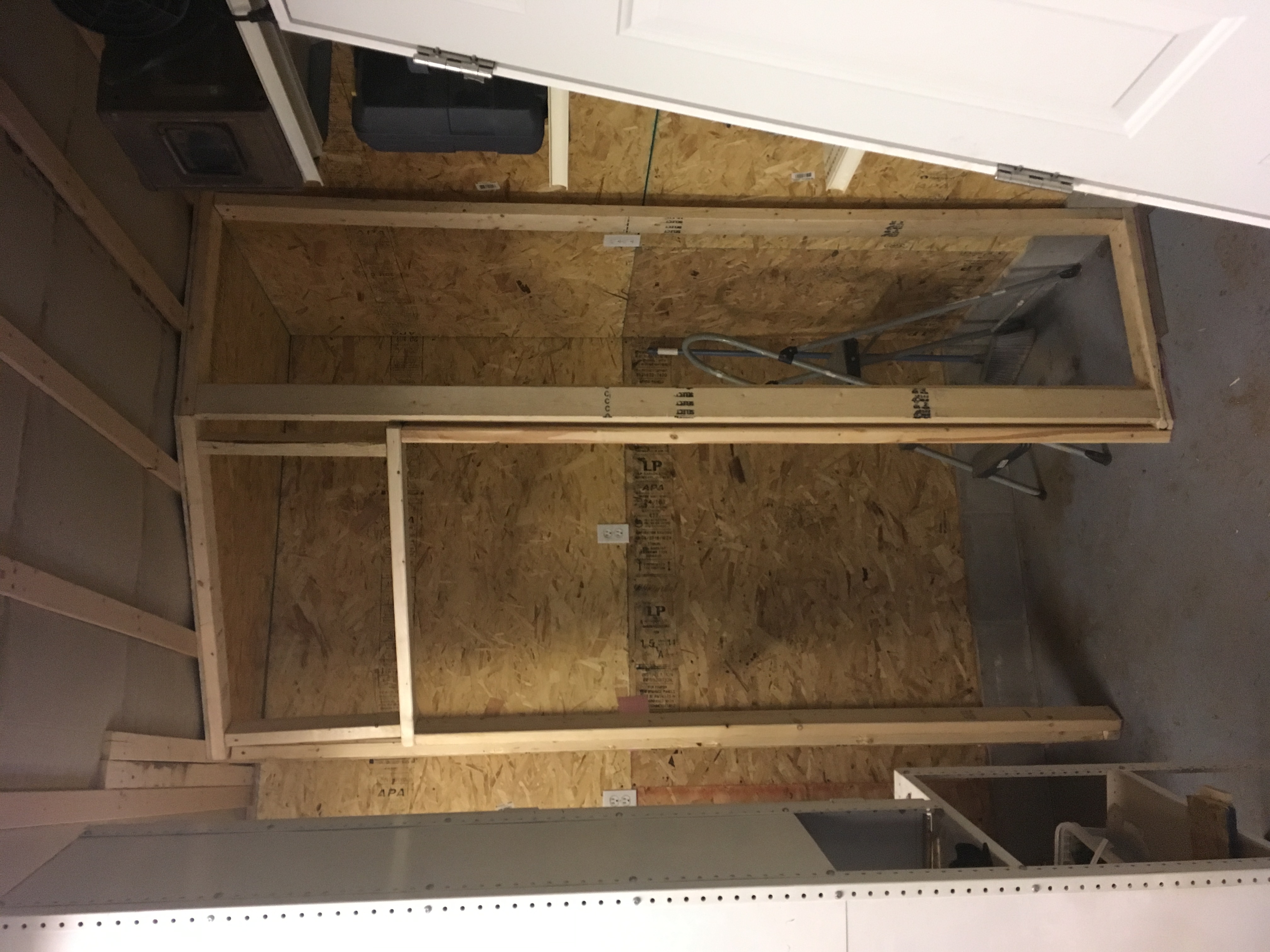

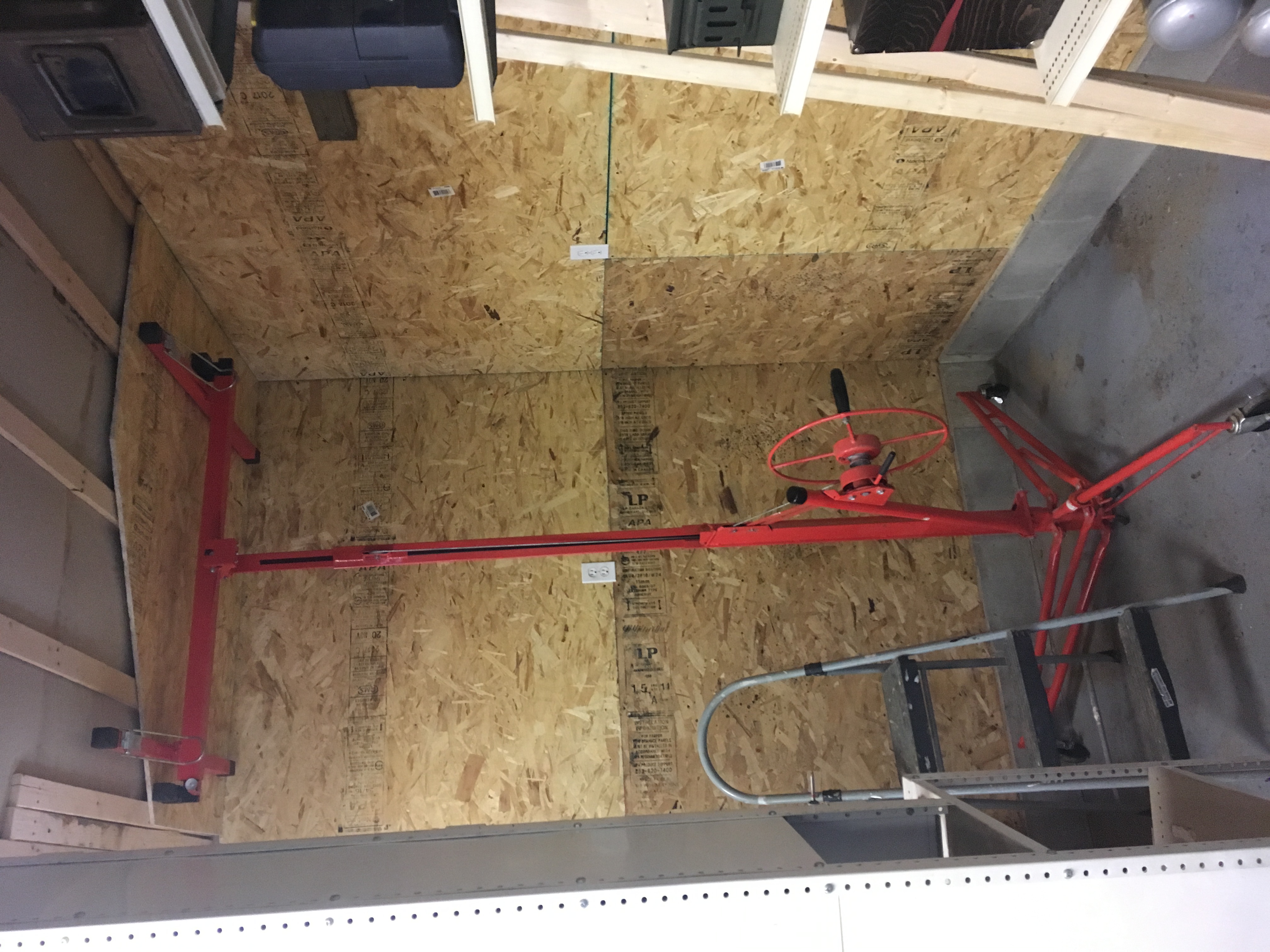

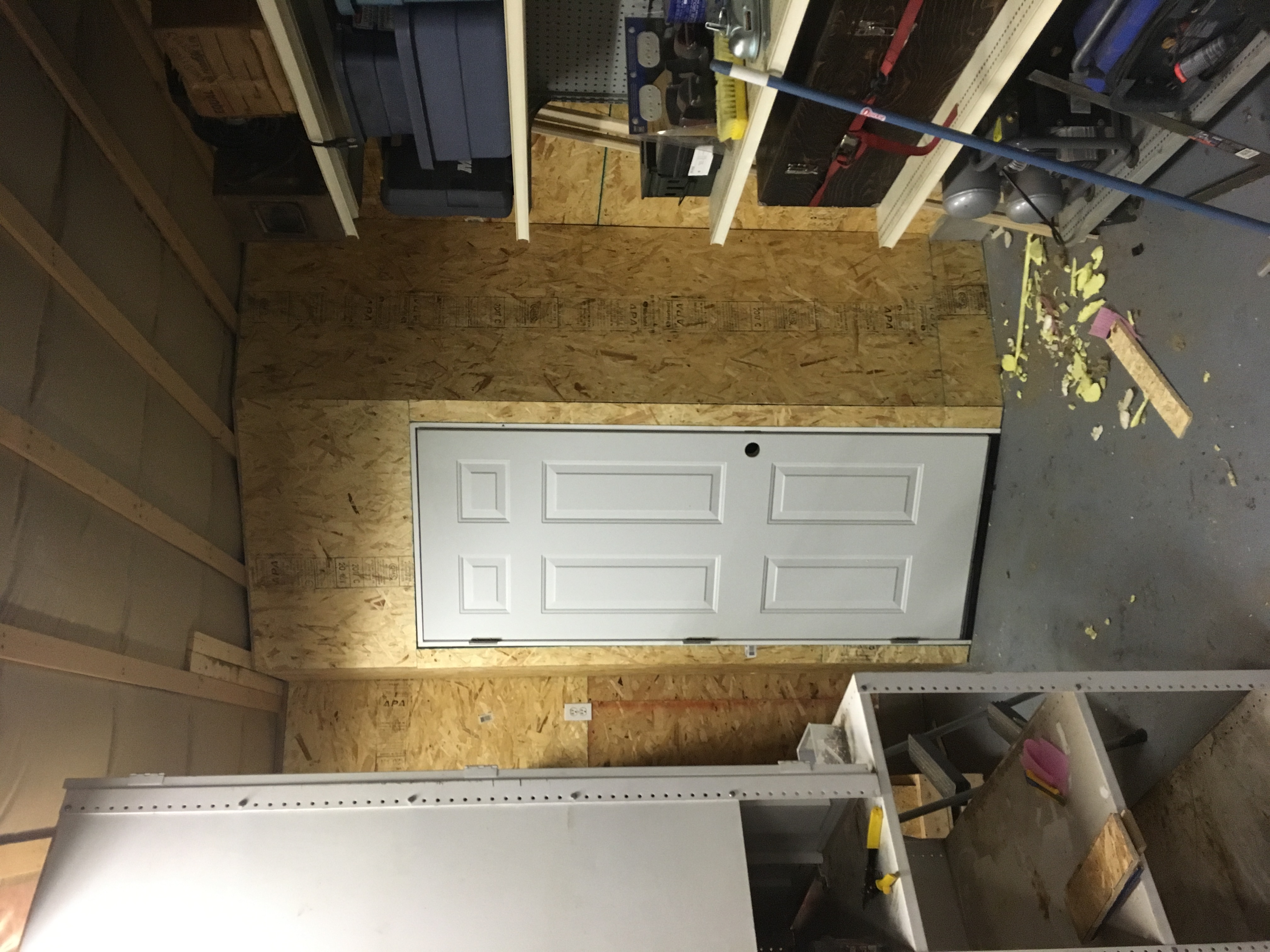

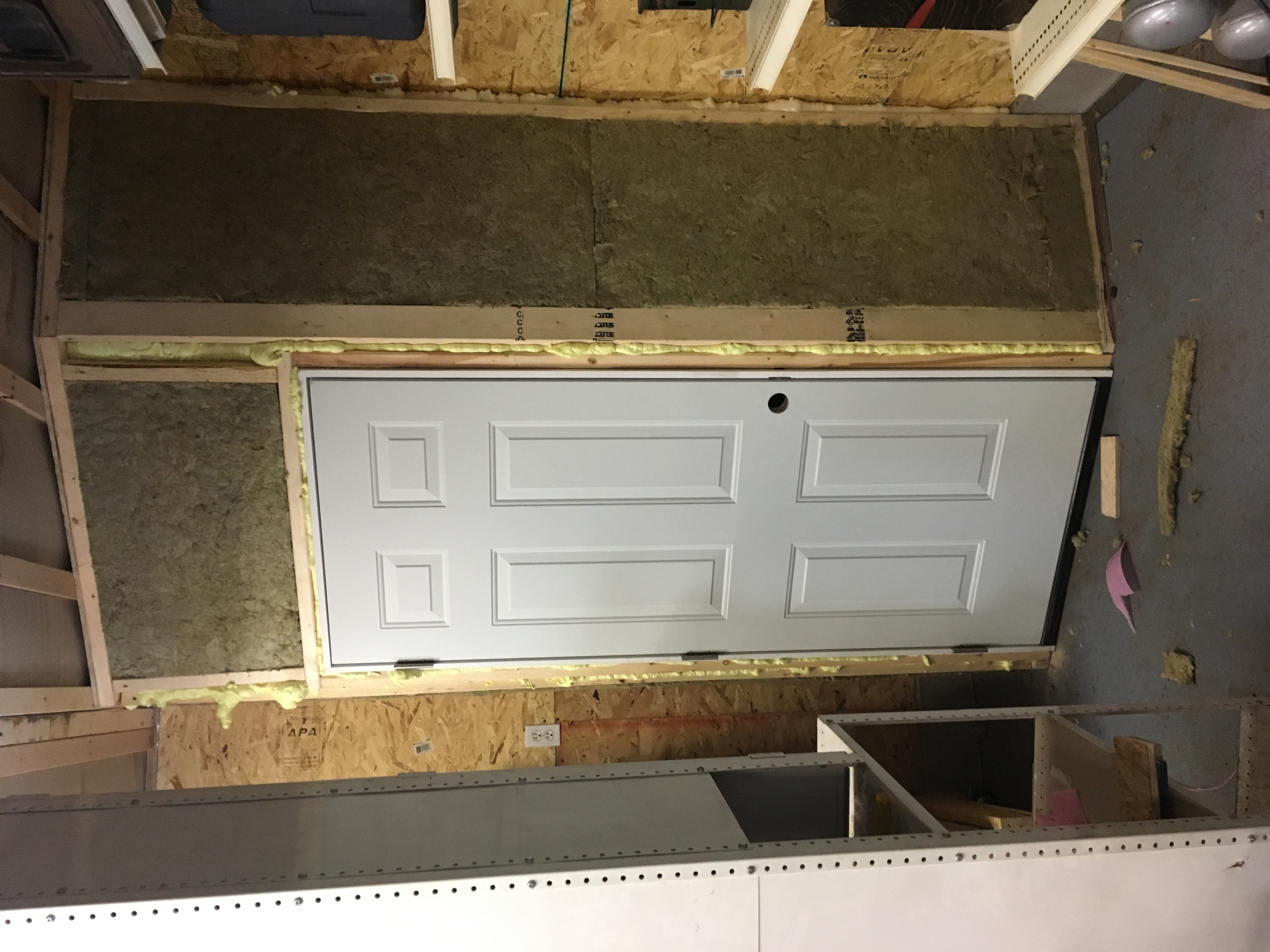

I decided to build the closet roughly 60" x 42" on the outside, with un-equal walls in order to accommodate some shelving I have.
I didn't realize how time consuming using the acoustical seal on all the joints was going to be. it almost doubles the work. the basic steps where, measure, cut, fit, mark, remove, apply sealant, re install, screw.
working alone, the dry wall hoist was a big help.
My ceiling height is about 8'8" which made a few things more complicated then they needed to be.
I put the sheeting up on the inside first, then installed the exterior door, spray foam and insulation.
I still need to trim out the door, and do a little bit of caulking in the inside, but the closet 98% done.
Very nice Construction! But, how does compressor get it’s air to compress? Will you vent your closet to outside air?
Isn’t your compressor 240 volt?
   / Shop Air Compressor set up questions?
#62
yeap and yeap.
for the time being, I'll have to leave the door open, but once the weather warms up, I'll extend the compressor intake to the out side. I'm concerned my vinyl siding will crack if I try to cut it right now.
And yeah the next step is to pull a dedicated wire from my sub panel. I plan to run it up in the attic.

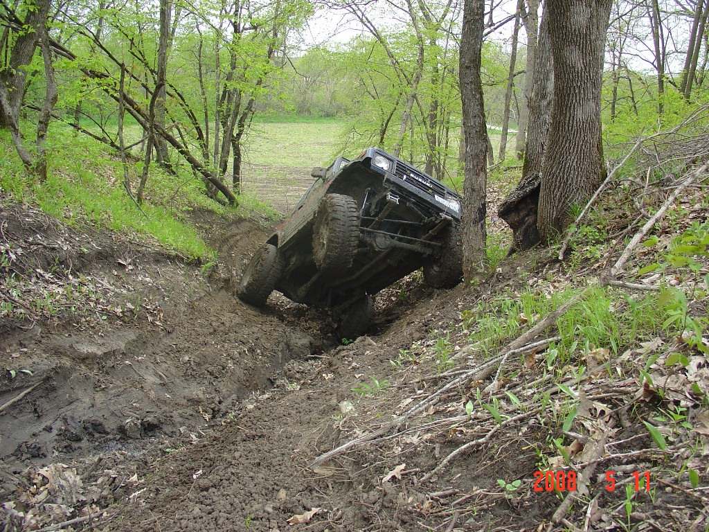

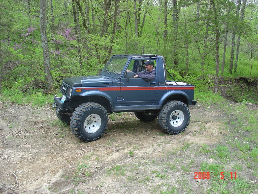

The buggy is what I work on when I finish the the "honey do" list.
it started life off as a Suzuki Samurai... but rust killed it and I decided it was time for a dedicated trail rig.
specs are basically 1.6L, 3 speed auto, kick reduction box, sami 4:1 T-case with dana 44 axles, locked front and back, high steer set up and 35" tires. Jeep YJ springs all hanging off a custom 2x4 frame and tube body.
Nice work on the shop. Hard to not get frustrated when doing those "slow" parts. But your patience will be rewarded for years!!!
I'd enjoy seeing more pics of your buggy whenever you can!!!
Here's a Sami a friend of mine wheeled for several years until the engine blew. Then he had another child, built a new house/shop, and hasn't gotten any extra money to get it going again. It's stretched and runs YJ springs with homemade "revolver" shackles. They make awesome wheeling rigs. :)
