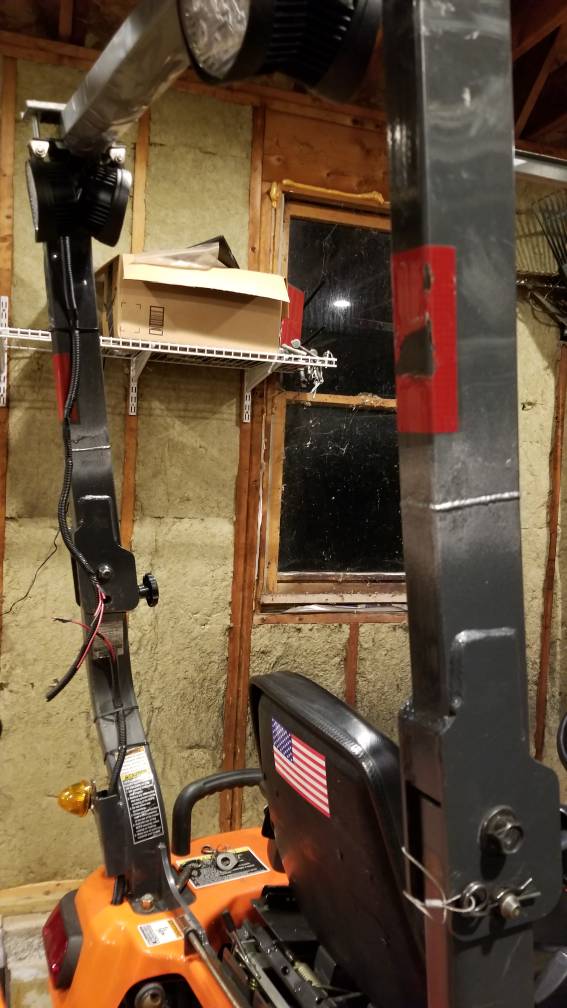

Bringing this thread back from the dead.

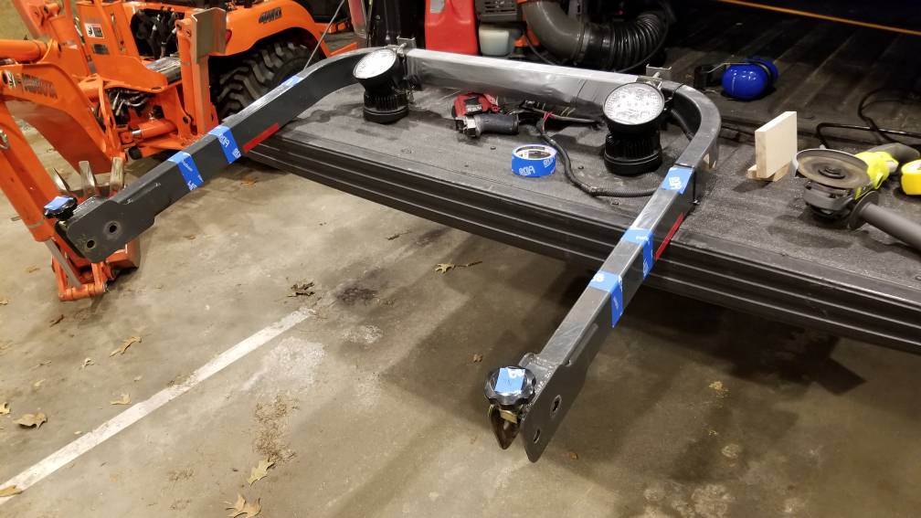

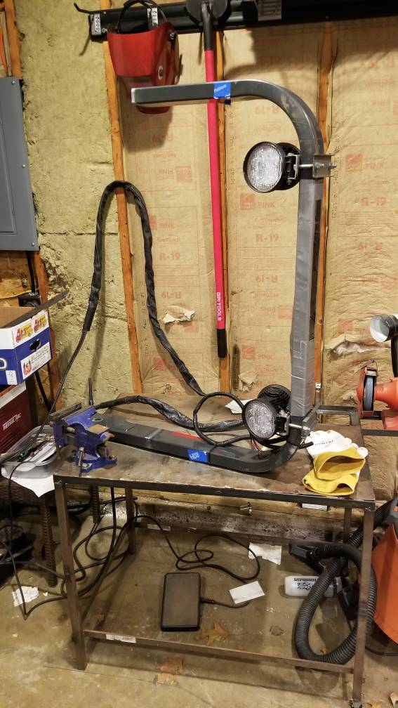

I shortened my ROPS tonight.
Yes. I know all the drawbacks.
No I'm not a lawyer.
Yes I know Kubota engineers are really smart and "engineered" the ROPS this way.
I still did it for a number of reasons.
1. Kubota made a mistake engineering it so it wouldn't fit most standard garage doors.
2. I drive around town and half the Kubota's I see have their ROPS removed. My assumption is because they are so inconvenient that many people forego the protection. In my situation I still have it so I think I'm better off.
Will people on this forum wonder whether it'll hold in a roll-over situation? I don't care. I believe it will after testing the weld on the sections I removed.
3. The cut section is already just above my head when seated. If for some reason I roll, and if my weld fails it'll fail above my head and I'll still have the "legs". I know it won't protect as much as if it were square but it's better than nothing.
What did I do:

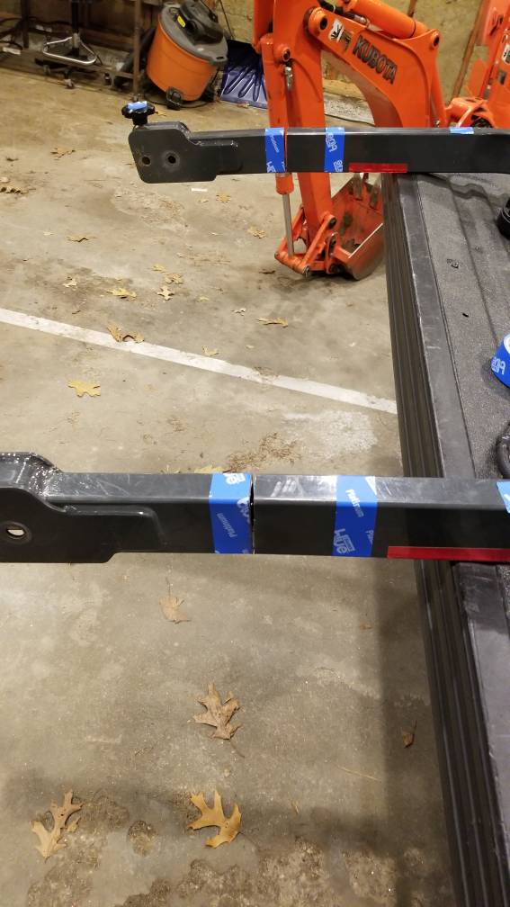

I took 3 inches out of the legs of the ROPS. I did this about 12 inches from the bottom.
After removing 3 inches with a cutting wheel I cleaned and squared up the edges so they would all mate well together. I gave everything a slight bevel. Then ground away the paint and hit it all with acetone.

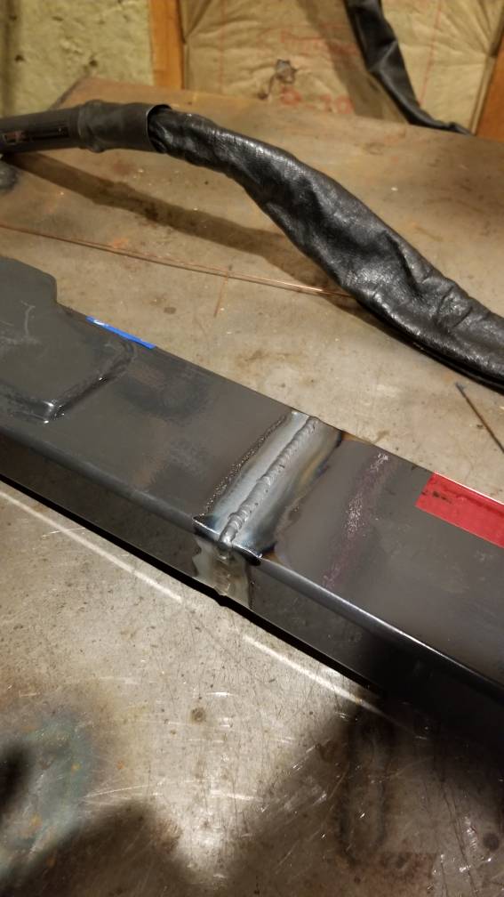

I TIG welded everything back together. It's been a while and I'm not the best with a TIG anymore but it'll do. Feel free to make fun of my welding. I have thick skin.
Then I painted things and test fit.
It took me 2.5 hours in the cold trying to hurry a bit before I froze.
Notable:
* The ROPS is 1/8" plain steel

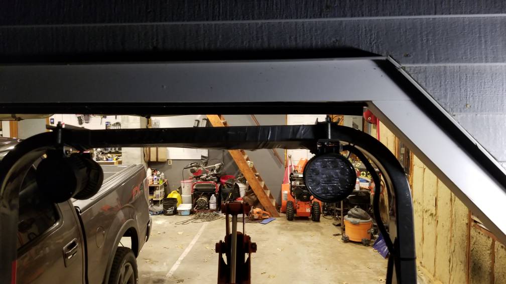

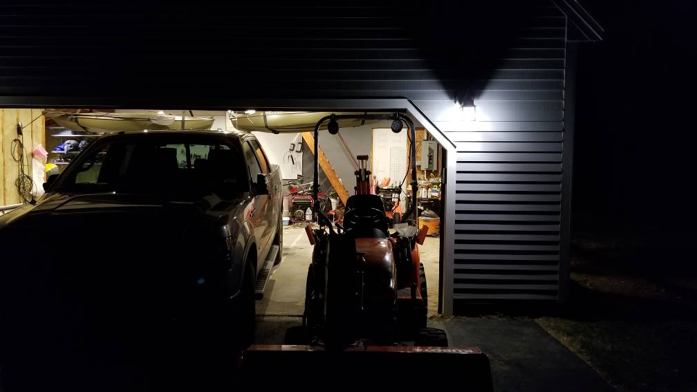

* 3" was perfect for me and I have some brackets above my ROPS and they still cleared my garage.
* I think I could have taken more out (4 maybe even 5 inches) and still would have plenty of clearance for my head when using the backhoe. I had tons of room when I tested it.
* I would have ground away more paint on the ROPS. Heat from welding started to fry the paint. I should have gone another 1/2" farther to give me more of a heat break. I started sucking in burnt paint fumes at one point.
* Given the cold temps I would have pre-heated the metal before welding.
I just threw whatever paint I had laying around when I finished.
The convenience of this so evident I had to do it. I've hit my garage three times in the 6 years I've had my BX. Yes I know I could dangle something ridiculous from my garage but I choose not to.
   / Shortening folding ROPS on BX24 #47
Here are the pics 20181204_205240.jpeg20181204_210111.jpeg20181204_221523.jpeg20181204_221532.jpeg20181204_230131.jpeg20181204_230712.jpeg20181204_230727.jpeg

:thumbsup: looks good to me. i wouldnt worry about the "rops " police.. anytime you need a hiding spot - ill hide ya.. ;)
   / Shortening folding ROPS on BX24 #49
Just for good measure and to support that joint I would weld a supporting plate across the weld seam on eather side.
   / Shortening folding ROPS on BX24 #50
Good idea.
Would you grind down the bead to do it?
I have a professional welder friend I think I can ask.
