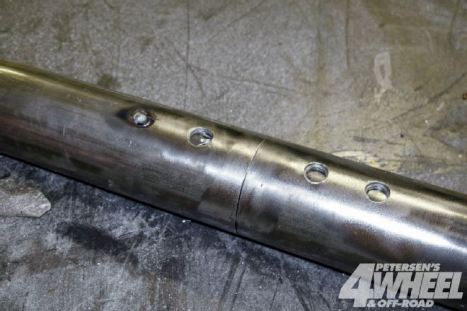

A diamond shaped plate will allow for more weld reinforcement and make the joint as stronger or stronger then the original box tube was.

So cut a square and weld it with points at 0, 90, 180, 270?

A stretched out 6 or 8 sided shape will allow for more weld length to reinforce the plain butt weld and it will spread any stresses or loads to a larger area.

That makes sense. That's good info.
I'm thinking a diamond would be enough. I don't plan on making use of it :)

Using a sleeve on the inside, would be the strongest, and cleanest way to do this kind of butt weld.
