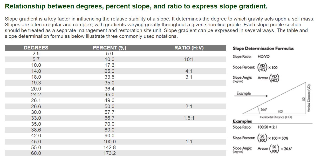

It might handle the 20 degree slope, but it will slide sideways or roll on the 30 degree part.
How did you measure the slope?

Yep, but a 3:1 slope is only 18 degrees, not 20 or 30 like the OP asked about.
This is an 18 degree slope.
This is a 26.6 degree slope, very difficult to walk up or down.

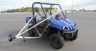

If you don't have narrow places...outriggers! :D
Bruce
