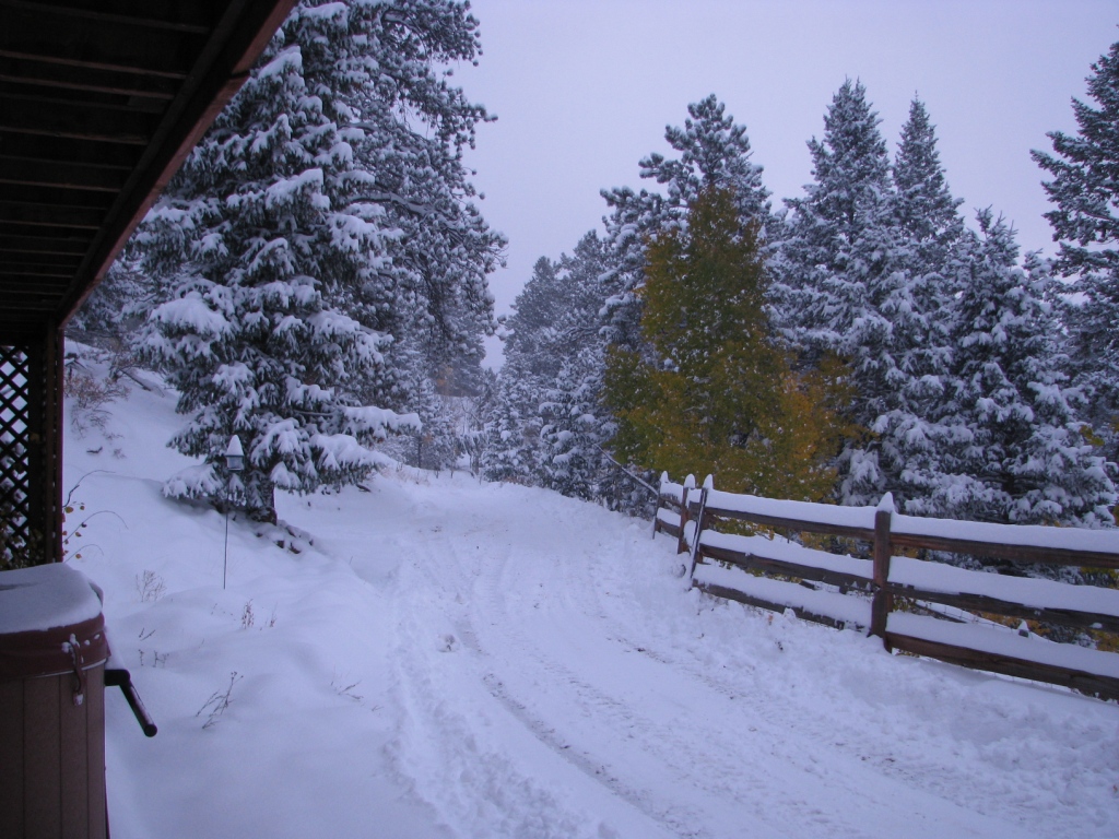

If it was me I would go with the lighter blade. I also have a "shelf" road and that makes the blade work very nicely. No big snow banks to deal with. I put hydraulic angle on mine so I can push to the same side going out and coming back to the house. That will add more weight.
