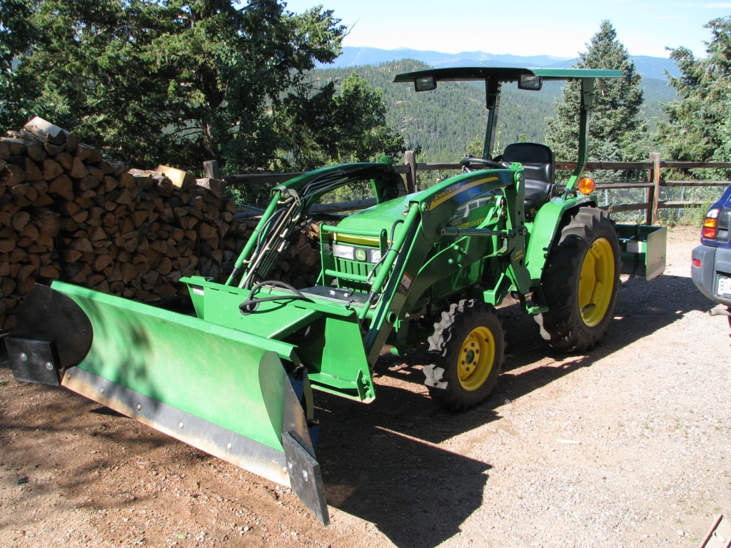

I have a 72" frontier blade on my 790 plus 22" of wings. Worked fine with 10" of snow and several feet w/o the wings. Haven't had a big snow since I added the wings.

Now back to the blade. I will still get a front blade and have settled on a 72" loader mounted versus a frame mounted. I'm not plowing commercially and am the only one using the tractor/plow so feel I'll be careful enough not to twist the loader arms. I also like the idea of being able to quickly switch between the blade and bucket versus a frame mounted blade, plus I don't feel the need to use the plow as a bulldozer.
   / Size of Front Snow Plow for TC34DA? #24
The FEL mounted blade will work fine. As long as it has a spring trip you shouldn't have to worry about damaging the FEL. With mine, I don't think it puts anywhere near the stress on the FEL compared to digging dirt with the bucket. Just don't get crazy with the blade and try to ram a frozen pile of snow/ice from a running start.

Thanks, what do you think about using the 7' blade on the loader arms along with chains on all 4 tires on a gravel driveway? I live on a hill, so chains are a must. Also what about using the edge of the blade to cut back a bank by the mail box that the town snowplow piled up?
   / Size of Front Snow Plow for TC34DA? #26
I use a 72" FEL blade with 22" of wings on a JD 790 w/o chains on R1s. Works fine.

Thanks Mech. That helps. Now I just have to decide whether a standard or medium duty blade. Any suggestions guys? Here is the info that Michigan Iron and Equip sent me. My TC34DA can lift over 800lbs and is 35hp, so is at the top end of the recommended weight for the Standard blade. They like the Standard blade for my tractor and snow removal, but I was thinking of going with the medium so I could do some light dozer work with some loose soil.
MIE QA Standard Duty Blades -
Recommended up to 35hp
Snow plowing and light grading and dozer work
Approximate Total Weight - 320lbs
72" Moldboard Width
Moldboard Height - 22"
MIE QA Medium Duty Blades -
Recommended up to 50hp
Heavy snow removal and medium grading and dozer work
Approximate Total Weight - 560lbs
72" Moldboard Width
   / Size of Front Snow Plow for TC34DA? #28
I don't know how much mine weights (its a lot more than I can lift) but I wouldn't want any more weight on the front. I have tried it to grade loose dirt but find that backing my BB is much better. With the blade way out in front of the front wheels any depression or bump will move it a lot.
