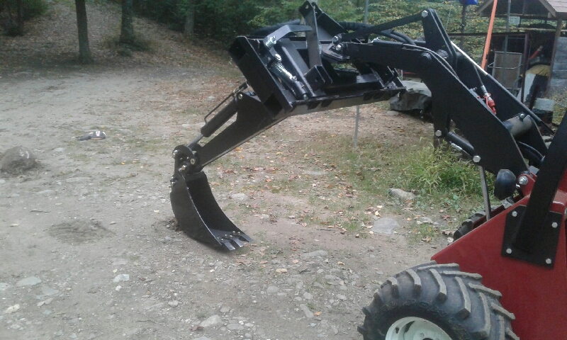

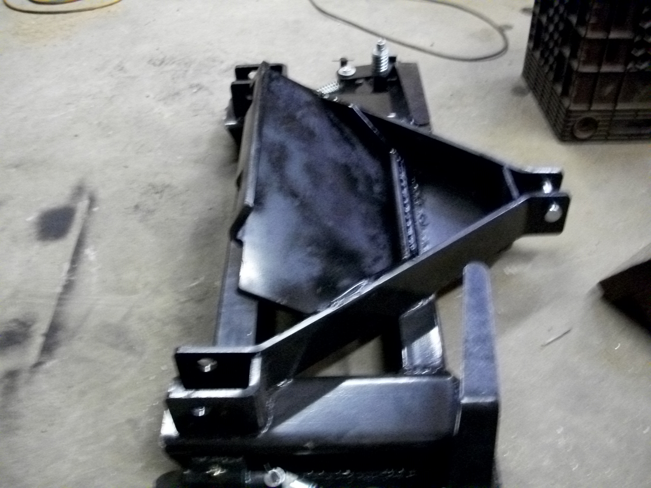

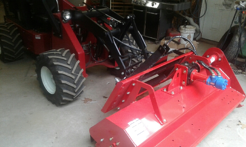

I also had a Steiner 430 max Kubota powered. It would get hung up on rocks and stumps and is made only for lawns. The slip scoop lifts about 2' high. The forklift goes about 2.5' high. You can't put larger tires on due to clearance issues in many directions. The bottom of the PT is like a steel sled and with 9" of ground clearance (1430) it can slide without damage over obstacles. Both tractors have their own implements, compare what Ventrac gets for a brush mower compared to PT (I believe Ventrac to be 3x more). Also PT sells blank plates to weld to other manufacture implements or adapters. See the pics attached, one is a PT to skid steer quick attach I just made. Now I can buy any proportionally sized skid steer implement from no name cheap manufactures and used them on the PT as shown in other pics of the flail and the front hoe. You can't do that with Ventrac.
