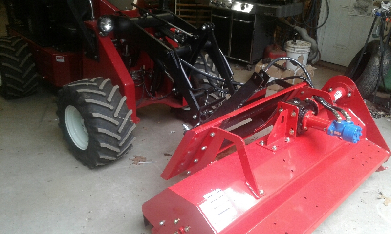

Having one machine to maintain that does a lot of different jobs is a big asset. Some people have criticized the quality of grass cutting given by the PT finish mowers (and there may be truth to it if you are a perfectionist), well you can always buy whatever brand mower that is your favorite and add a hydraulic motor to it (see attached pic). I love the way my PT works for clearing land. Although not recommended, you can raise the deck over rocks/boulders and stumps and trim down. I also use mine in a vertical position, like the propeller on an airplane to push back tree growth around the edges of pastures where the vegetation always goes in. You can't do that with a zero turn.
I just bought a 5' flail for my PT1430 from Titan. To check the oil in the gearbox you have to remove the motor adapter at the gearbox. That revealed that it was a 1 3/8"-6 spline input shaft on the gearbox, the same as you would connect a tractor PTO shaft to. It is a converted shaft drive mower. The specs of the PT1430 are below the advertised min for the mower. I have only used it for about a hour and it works fine for brush clearing.
After all your mowing is said and done, for the price of attachments you can have a grapple for clearing debris, loader bucket for wheel barrel or moving earth, and the 38 other attachments they offer. It's a no brainer as my old boss used to say.

Just FYI, flail mowers take more HP then rotary mowers, that is why PT doesn't offer them in the smaller tractors. So keep that in mind when calculating your HP requirements.

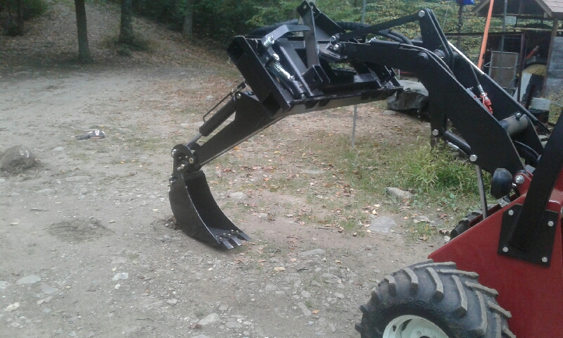

/ Sizing a Power Trac #11
I also had a Steiner 430 max Kubota powered. It would get hung up on rocks and stumps and is made only for lawns. The slip scoop lifts about 2' high. The forklift goes about 2.5' high. You can't put larger tires on due to clearance issues in many directions. The bottom of the PT is like a steel sled and with 9" of ground clearance (1430) it can slide without damage over obstacles. Both tractors have their own implements, compare what Ventrac gets for a brush mower compared to PT (I believe Ventrac to be 3x more). Also PT sells blank plates to weld to other manufacture implements or adapters. See the pics attached, one is a PT to skid steer quick attach I just made. Now I can buy any proportionally sized skid steer implement from no name cheap manufactures and used them on the PT as shown in other pics of the flail and the front hoe. You can't do that with Ventrac.
The Kubota is hands down a great machine. The PT is vastly easier to operate due to the proximity to the implement being right in front of you. Try scooping up a small object with the loader on the Kubota and compare to a PT (it will be the same with dirt when you get it home). See how easy it is to get on and off the machine, and think of a long day working it. As mentioned, when trying the kubota, hook up the largest implement you think you might buy and see what a pain it is (make sure you at least get the extendable lower links on the 3pt and a hyd top link with 2 or 3 aux hyd circuits). The PT is effortless to change implements except getting oil on your hands/gloves from the hyd hoses.
Some people I know have a tractor for each implement because its so hard to change and make all the sway and angle adjustment to get the 3pt hitch right where you need it. I would vote a big no on the Ventrac or Steiner. You might have a tough choice with the Kubota/PT.
