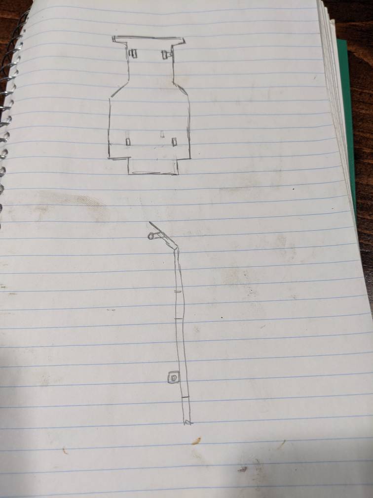

I made this up real quick just to have something to look at, I think it will work with a bit of cleaning up but it is basically the top middle of the mower deck and will have double tabs in back like the deck has for the raise and lower function and I do not want any crap about my drawing being I am not a artist or engineer, I just know what I am trying to accomplish and that is all that matters, here is my kindergarten drawing.
Ok, so you're looking to use the mower deck's front bracket, I gotcha. So literally just a swap, the skid plate instead of the deck. Not bad, not bad.

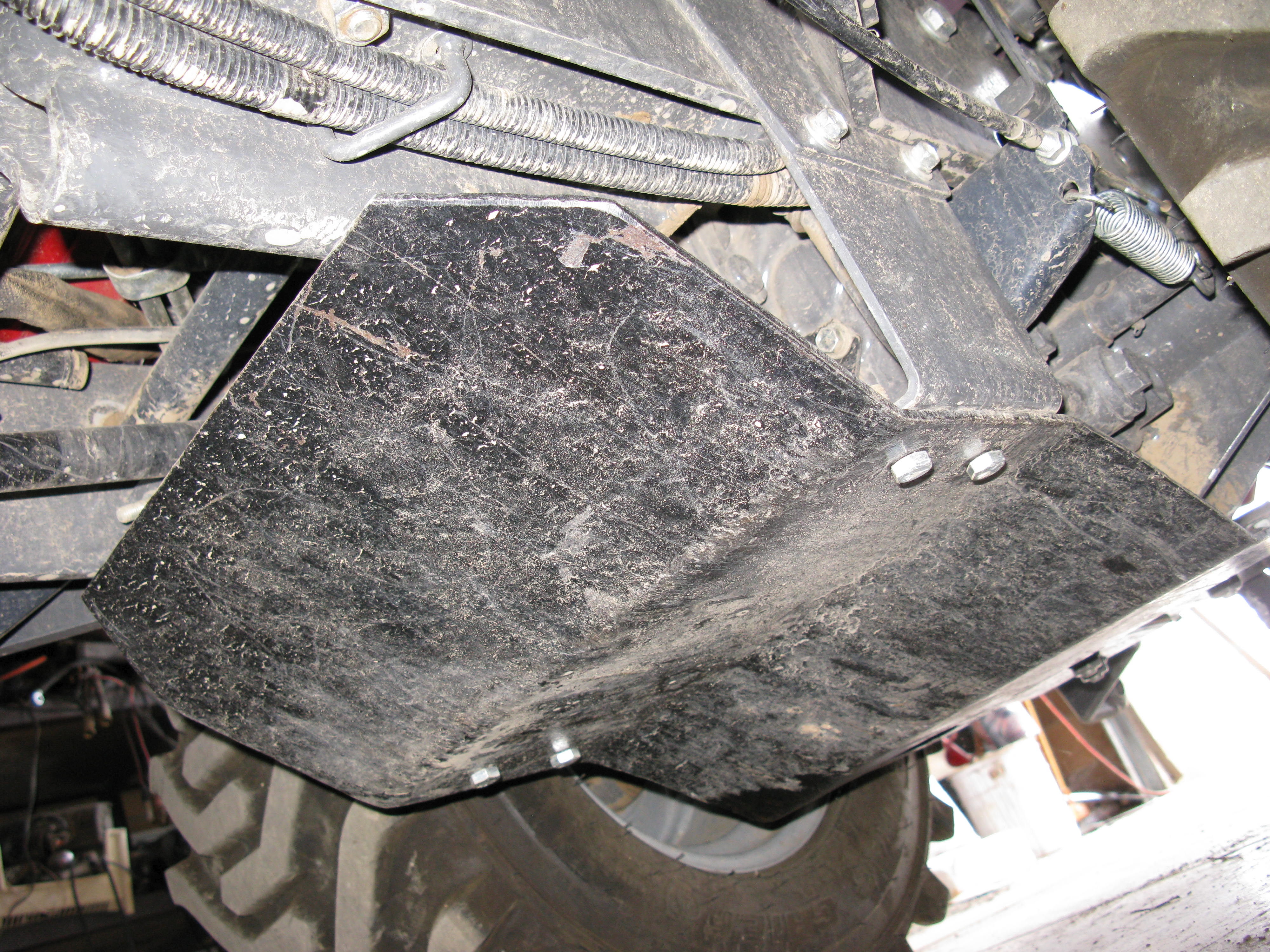

I'd love to see that, can you post a pic?
Sorry for the delay. It's pretty simple and I remove it in the winter to hook up the front driveshaft for a snowblower. Have to also remove it for changing the filter but it's only 4 bolts. I made it out of a scrap of steel of unknown parentage that I had laying around. Lots of big rocks around here and it held up real well. I bent it by heating the bends with a rosebud torch until it bent fairly easily. I don't use a mower. The skid plate cuts down the ground clearance under the rear differential by maybe an inch and so far hasn't been an issue.
Thanks for the pic, definitely doable for sure. I will keep a pic of it in my album.
