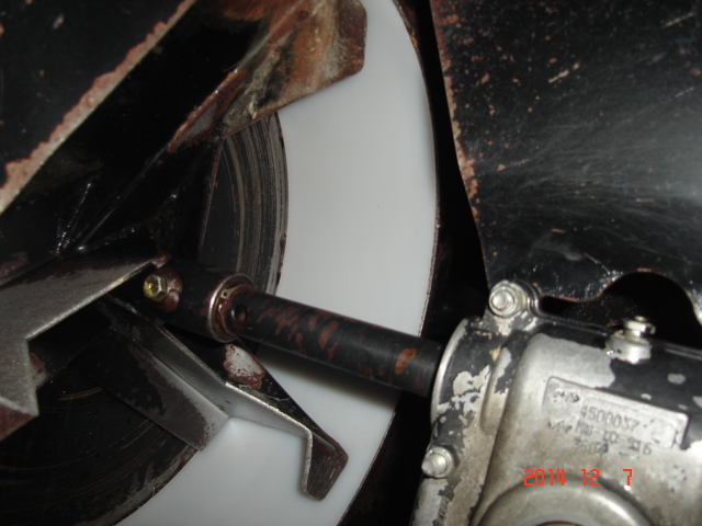

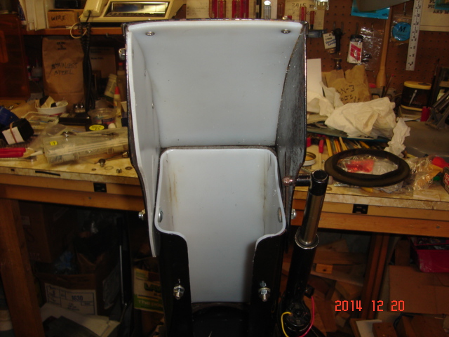

If you're considering plastic(s)... consider UHMWPE -- ultra-high molecular weight polyethylene. That stuff is amazingly tough, and is often used for snowplow scraper blades. I used it to line the impeller cavity and chute on my snowblower, where it made an amazing difference. It can be ordered in sheets of desired thickness (I used 1/8" for my project), and can be shaped by using a high-heat gun or even a small torch. Heat up just below melting, bend, let cool.
That material, plus perhaps some metal stiffeners here & there, might just work!
View attachment 625618View attachment 625619
Nice job lining your discharge chute, I still have the UHMW pieces saved in an online basket, just have not put that project at the top of the list yet.

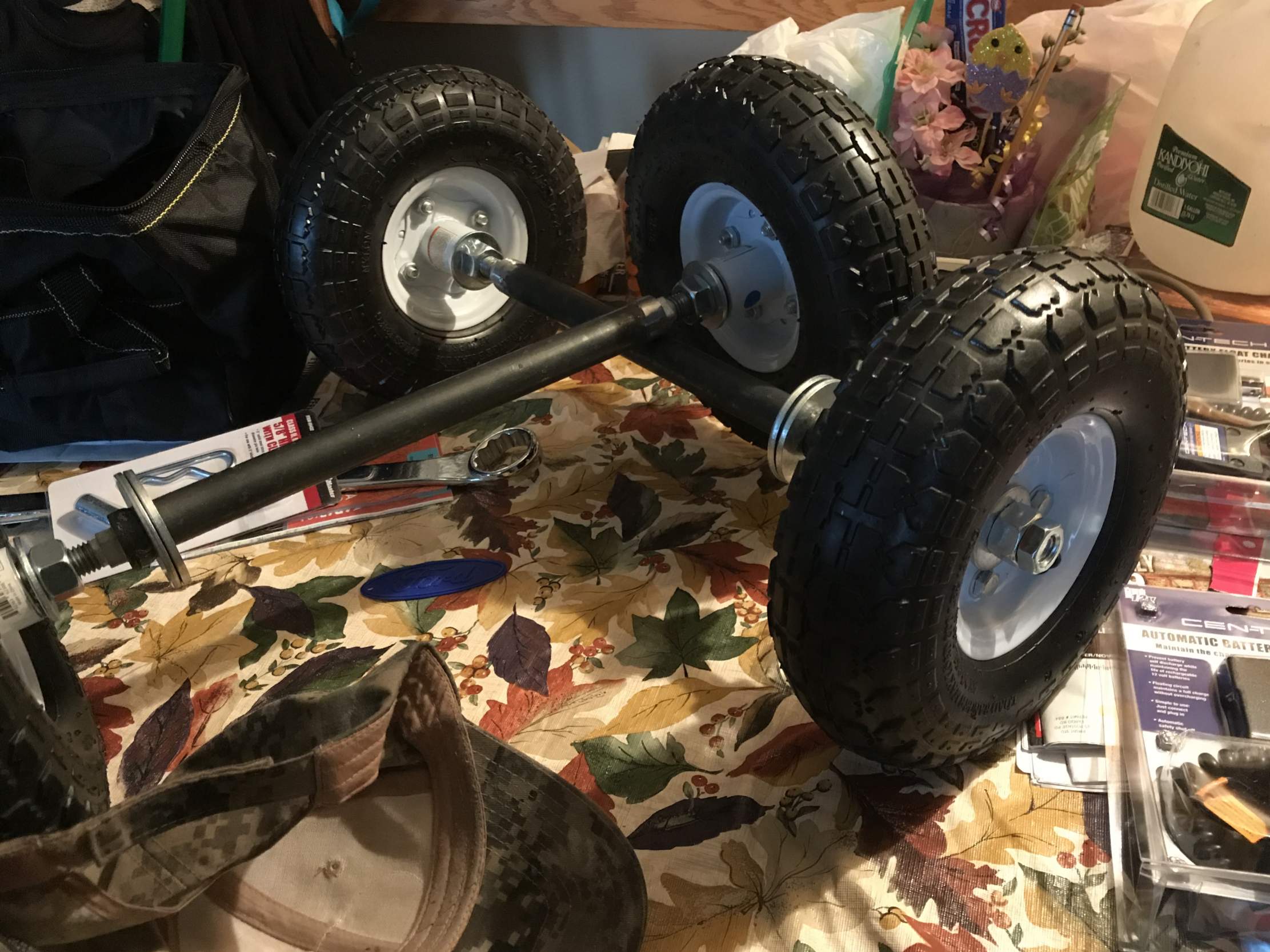

You got it, just like a deck, it has been a crappy day here with high winds and rain so I did not get to town but my wheels showed up for my MMM dolly and again to crappy outside to open the garage/shop door and lift the mower deck up to fit the axles, the wind and rain are blowing right at the door.
Sweet.
