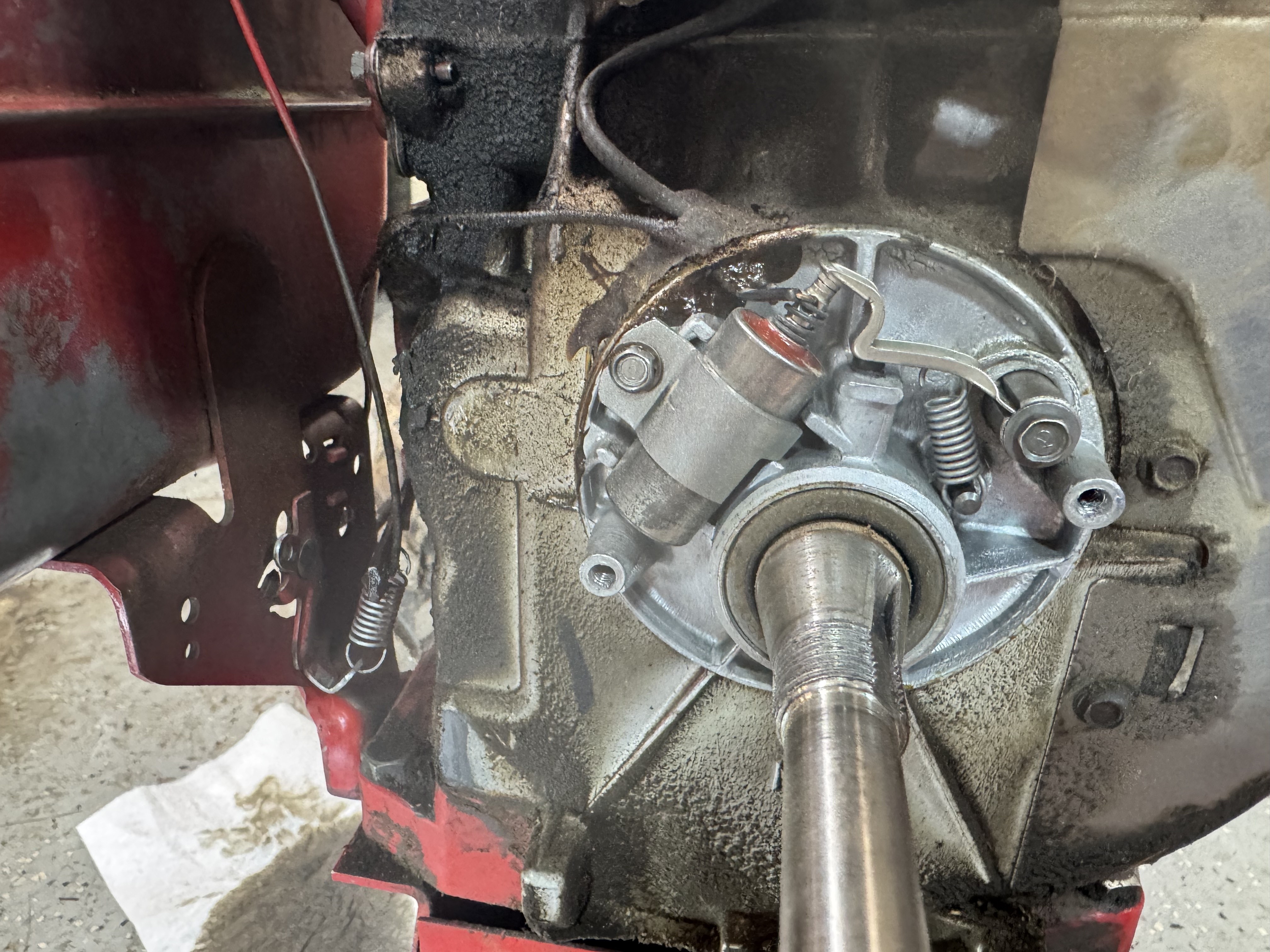

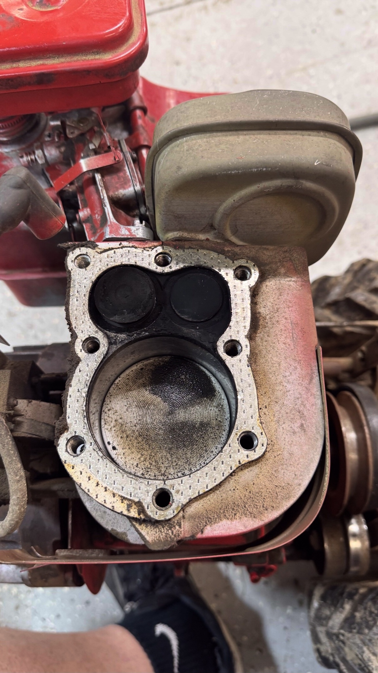

I give up, I keep tearing into it deeper and just can’t find why it won’t run. I think it carb related but I still can’t make it run. I ran it on starting fluid but it won’t run on its own.

No head and no flywheel, no wonder it won't run! ;-)
When confronted with symptoms like you have, I put some gasoline in a squirt bottle , expose the carb air inlet, and see if I can get it to run and stay running "on the drip".
That separates the "Is it fuel, or is it ignition" question. Always check for spark as soon as the flywheel goes back on. A strand of lint in the points, and the spark is no-go.
Everything looks so clean, it's got to be something small.
I assume you pulled the fuel tank off the carb body to make sure the lift tube is intact.

Not exaggerating, I’ve had the carb off 10 times. It will run with gas in the carb or starting fluid.

Has to be fuel supply…
Had a gas engine with a pinhole in the fuel system that would let air in.
Had another where the gas cap vent was obstructed…
It was giving my friend fits and I told him try running with the cap off… he did, it ran and from then called me the engine whisperer…
His solution was to drill a hole in the middle of the cap… would not have been my first thought.

Just a little back story. This tiller was made in 1981 and the original owner used it some and then it sat unused for roughly 25 years. It was given to my buddy roughly 5 years ago. I got the thing running 5 years ago by just cleaning the carb. My buddy lined the gas tank. This last year he let it sit all winter with about half a tank of e10 gas.
That brings us up to date with this thread. In a couple of days he plans on getting a predator engine for it.

If he hadnt run ethanol, that tiller would still be running, IMPO. I suspect the carb isnt creating the vaccum needed to draw gas from the tank below and/or the pickup fuel assembly is somehow messed up.
Since the intake valve is open put your thumb on top of the exhaust valve and see if it turns. And then turn the engine over to close the exhaust valve and then try to turn the intake valve. I will bet one or both will turn with just thumb or finger pressure, which means the valves are not sealing and you are loosing compression. Have worked on 3 in the past 2 weeks with this issue.
