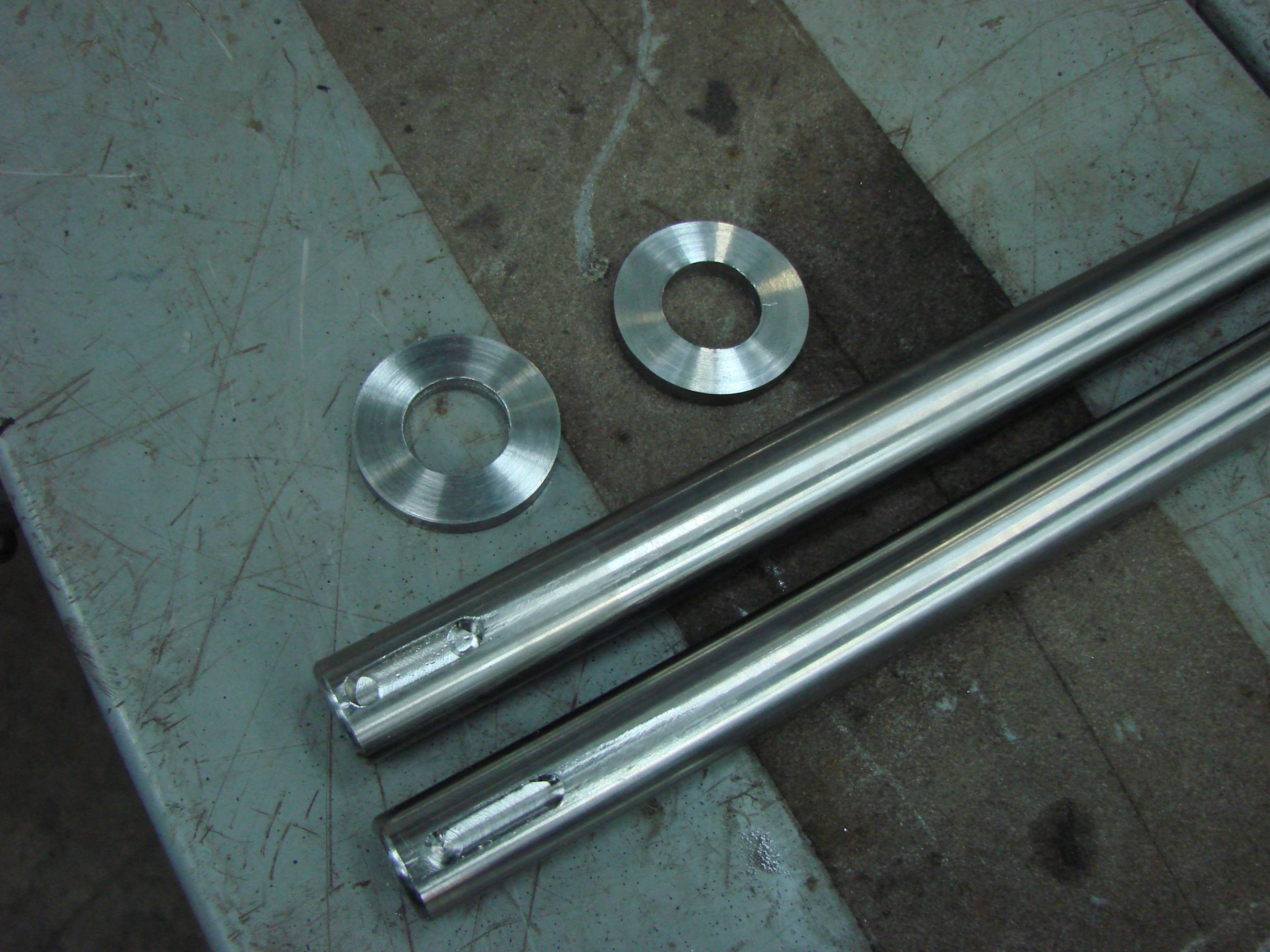

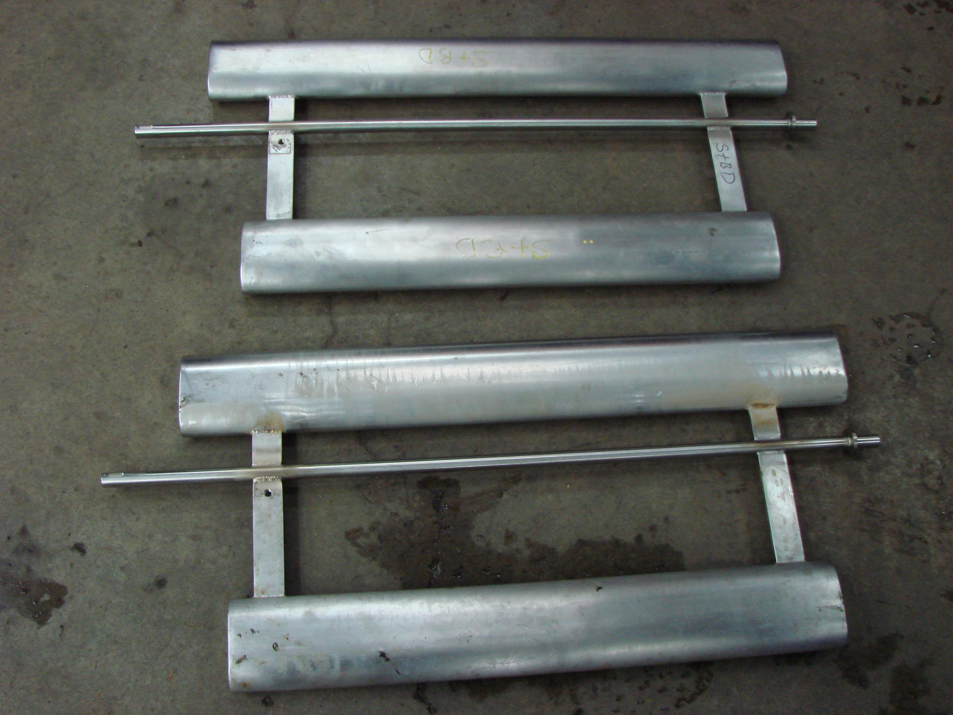

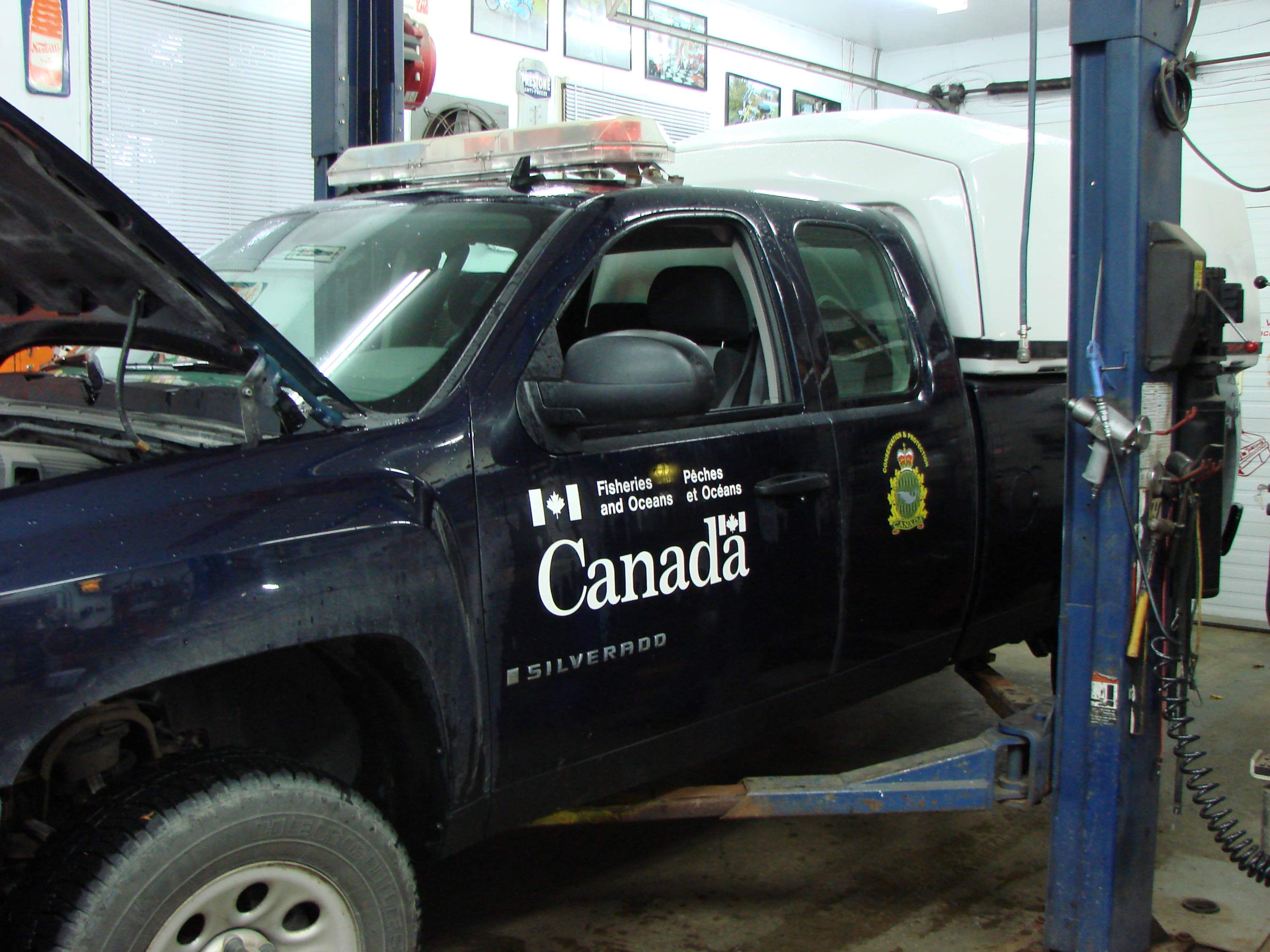

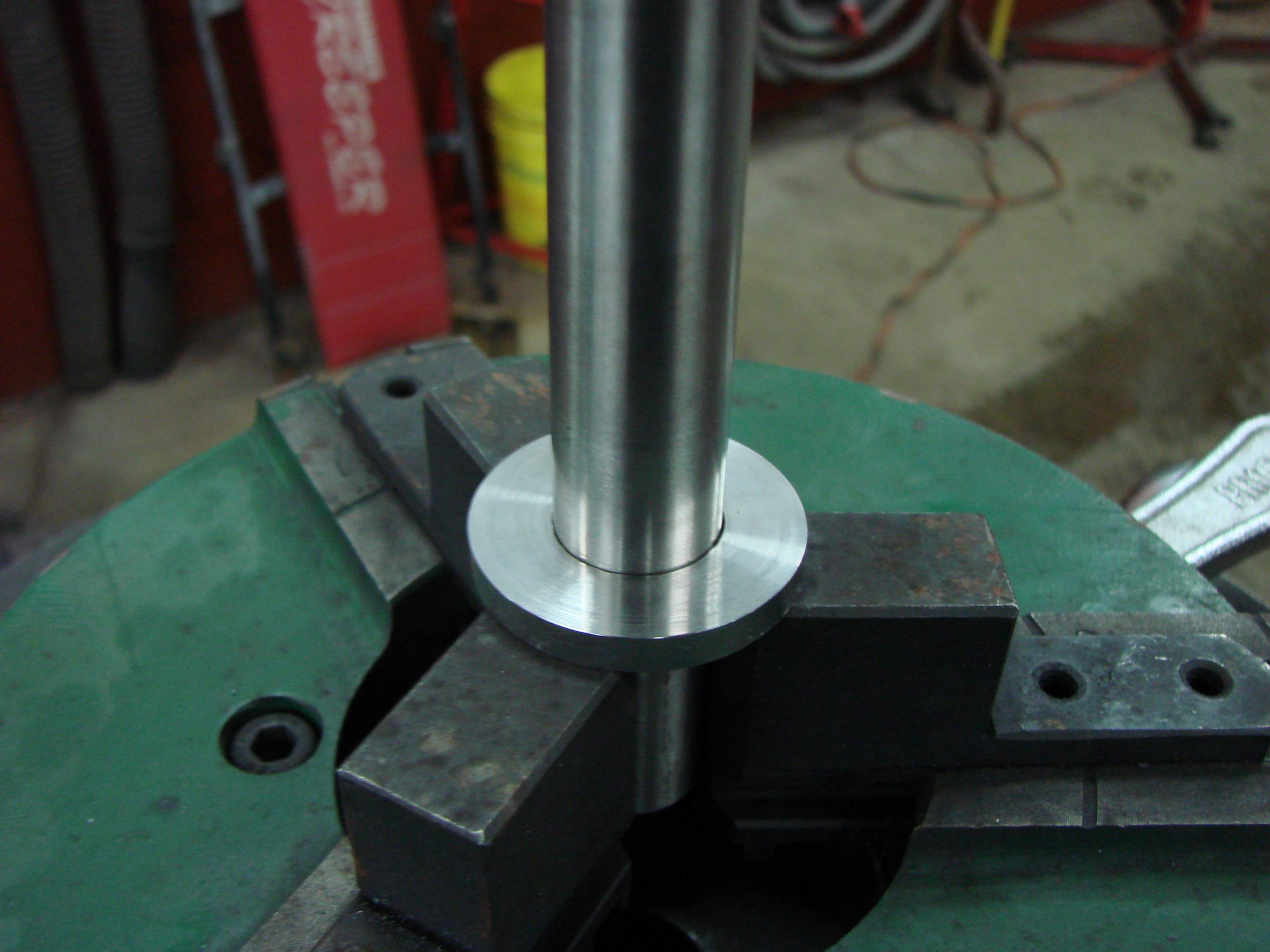

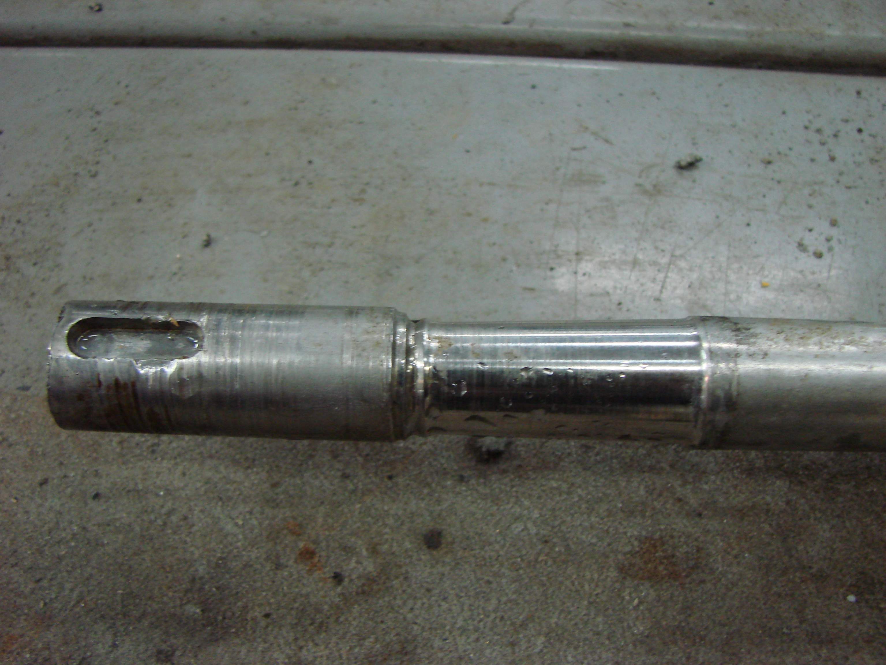

The first job was on a government vehicle. The second job was on these stainless parts off a factory freezer ship that was brought in with worn shafts.

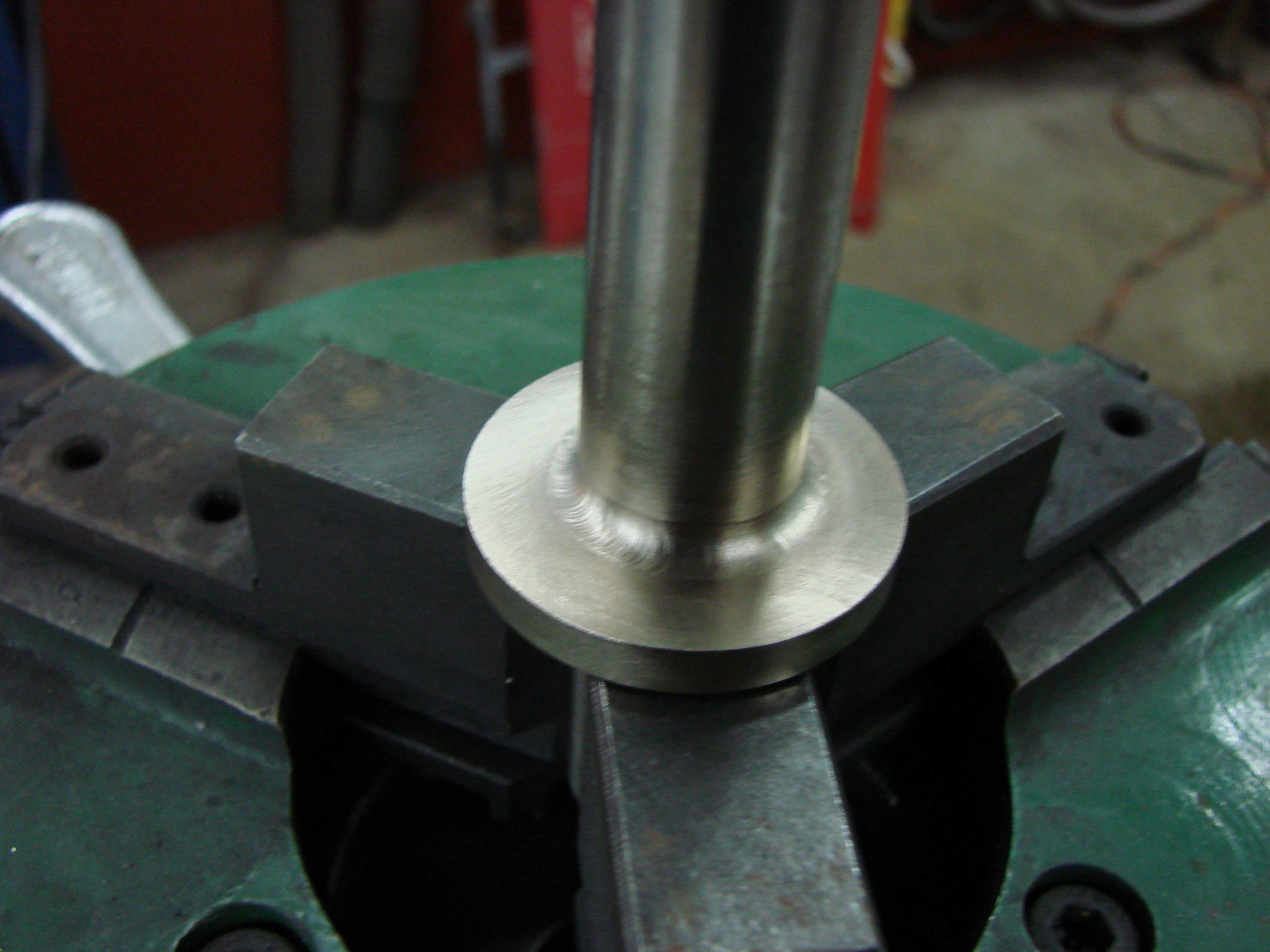

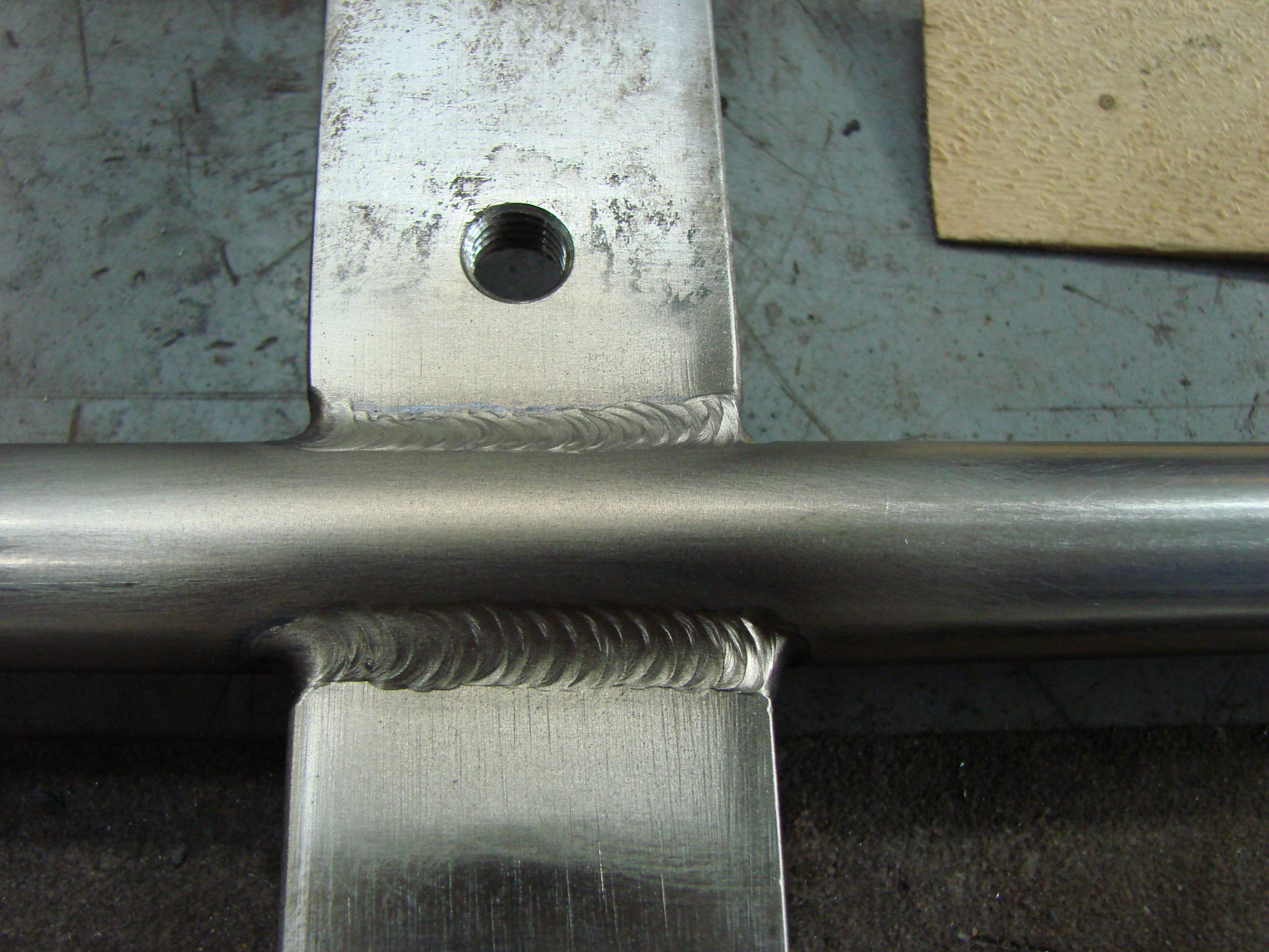

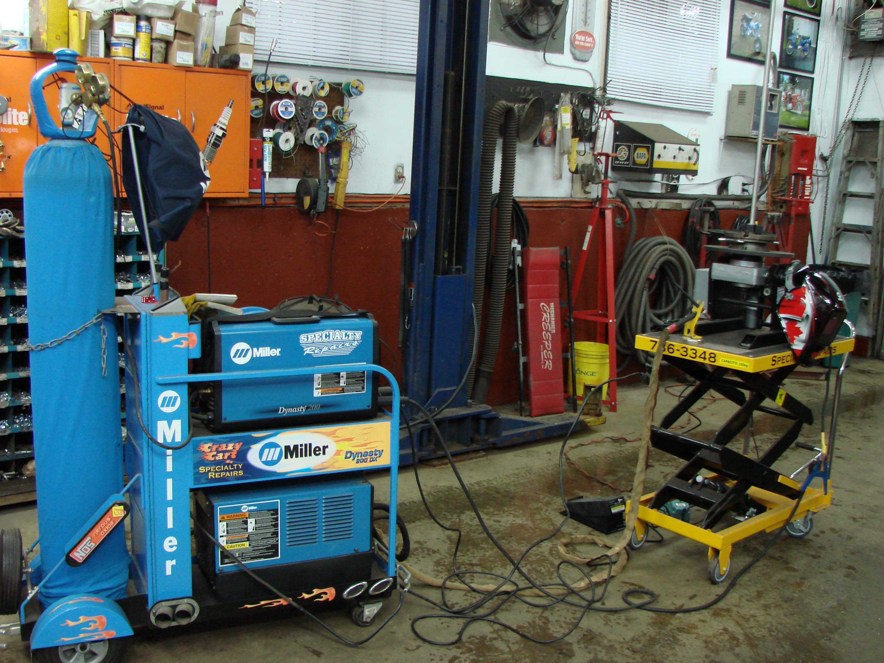

New shafts were machined and then the old ones were removed and the new ones tigged on. I attached a few steps and some close ups of the welds to bore you with.;)

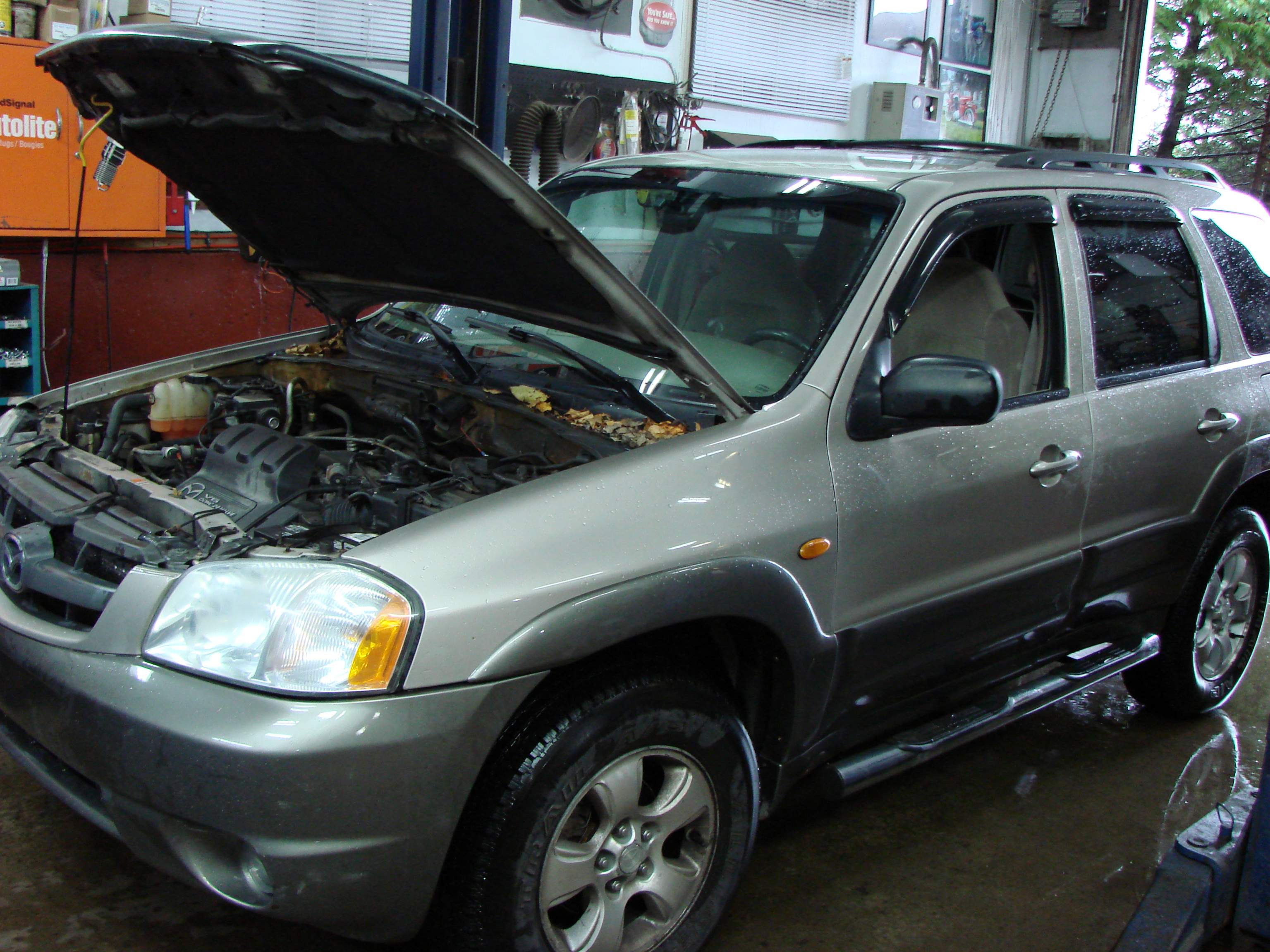

The next job is the last pic so far today and it's some basic repairs on a SUV. That's it so far. Have a look. Thanks for your posts guys :thumbsup:

That flange on the shaft is a work of art.:thumbsup: Nice to hear from you, buddy. :)
   / Small roller repair #35
Nice work! I can't believe how pretty those welds are.
Thank you. I get lucky and do a good weld once in awhile :laughing: Great to see your still around as well :thumbsup:

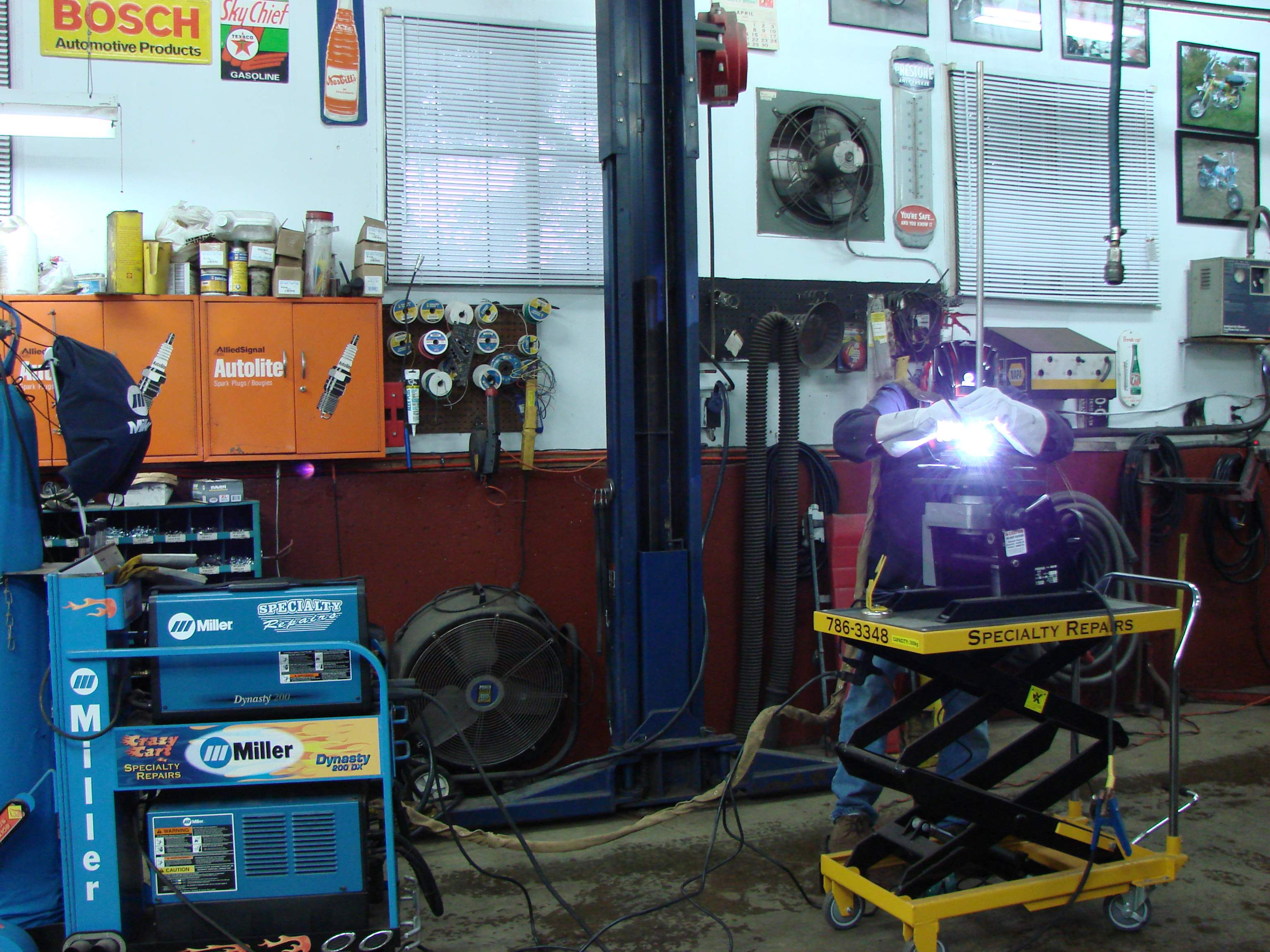

   / Small roller repair #37
Hey Mr. Paul, sir...

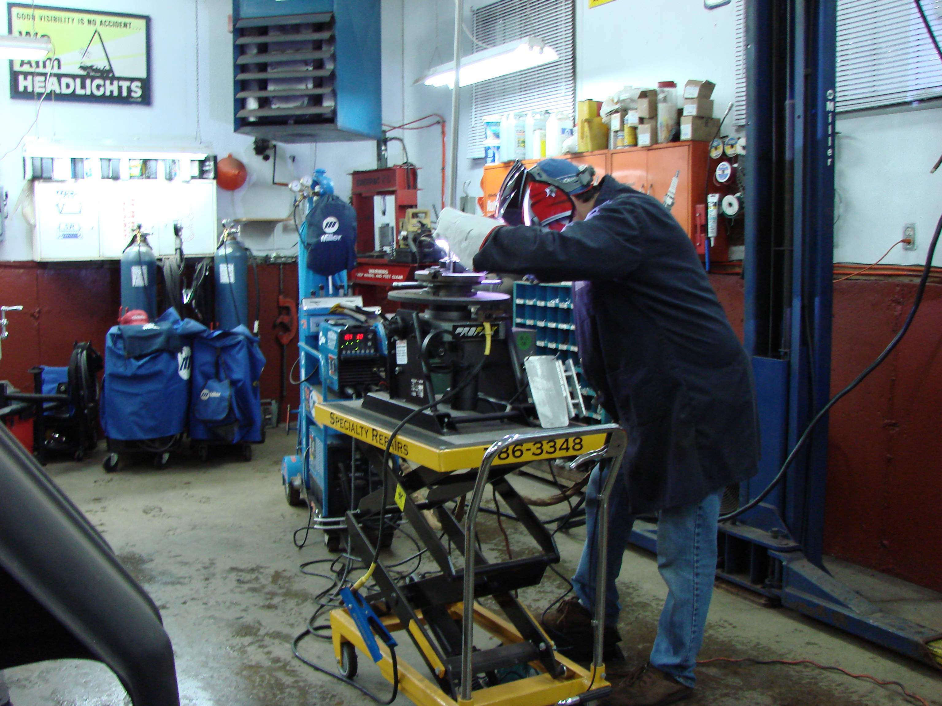

Remember me asking about your positioner? Was that what you used to make that nice weld all around the flange?
Just wondering... :D
#38
Yes my buddy. It was the result of the positioner. The trick is to know what speed to set the rotation. Also know the right set up for the welding equipment, have a steady hand and the rest is easy :laughing:
   / Small roller repair #39
Jeez! :shocked: So, one foot on the TIG control, the other foot on the positioner speed, and the other other foot on the camera shutter?
I've often wondered how to get that consistent weld. Don't move the gun... move the piece. How cool is that?
Thanks Paul. Some of my welding is getting better enough to have me grind away some of the really bad stuff and weld it again. 'Course I'm not welding using a mirror over my shoulder or anything like that! :laughing: Maybe next year. My LWH (lucky welding hat) is really helping out. :D
