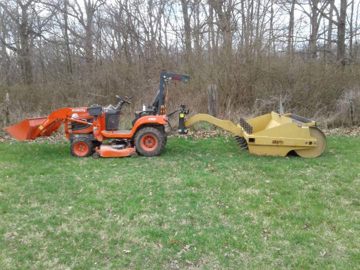

/ Smoothing a bumpy yard? #7
My box blade does great job on mole hills and runs, just too lazy to re-seed bare spots
That's a nice blade. Granddad had one similar that was mule drawn to maintain public roads in the early 20th century. Looking back,it worked better than my 3 point blade.
/ Smoothing a bumpy yard? #8
Can you pull that up hill? its as big as the tractor!
6 footer box can collect enough material to make a 2wd, 50hp ford with loaded tire & chains spin it's wheels. Live on a hill, biggest problem can't lift it off the ground like 3pt blade. Meeting a neighbor on hill can be a problem (at least they don't own any trailers). Prime, FedEx, ect can be challenging since it doesn't back up very well.
