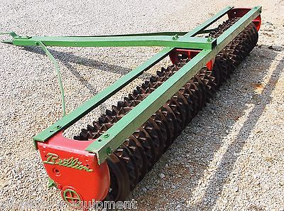

In my vocabulary, a ring roller is smooth. It was a variation of a segmented roller in which the segments were shortened to became rings instead of tubes.
A cultipacker has ridges and/or knobs on the rings
But as I've moved around, I've also learned that farm implement names vary regionally and change over time.

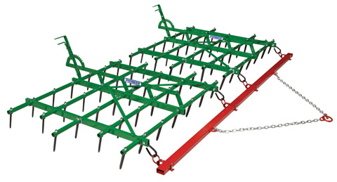

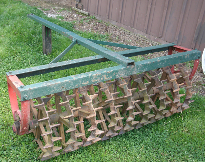

Soil Conditioner Soil Conditioner.jpg Rotary Hoe Rotary Hoe.jpg Spike Harrow Spike Harrow.jpg
Cultipacker Cultipacker.JPG Crow Foot CROW FOOT.JPG Field Cultivator Field Cultivator.jpg

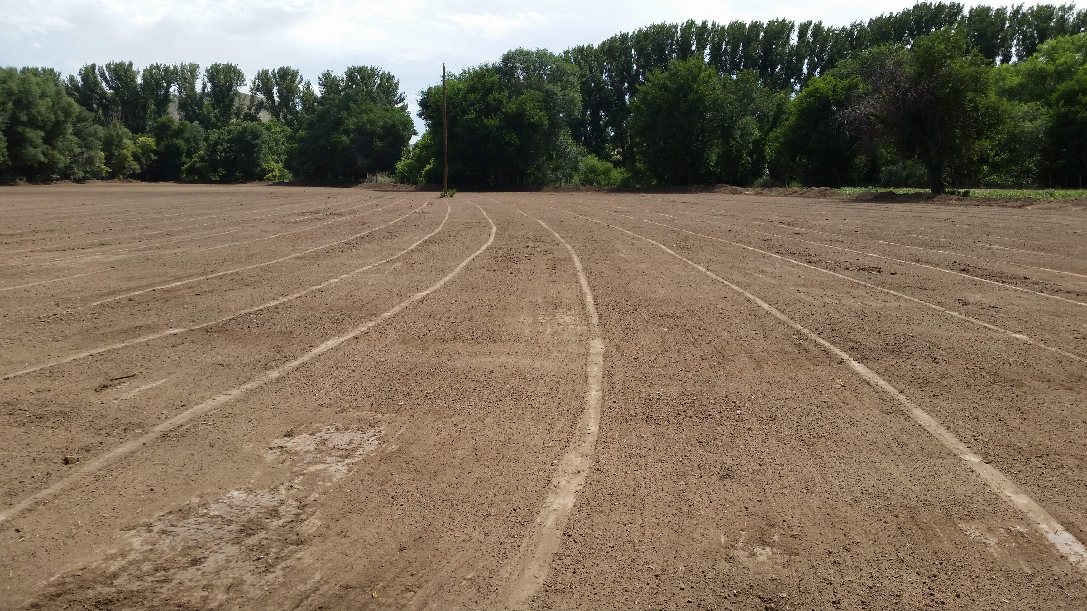

I use to use several different tools to smooth after tillage from drags to section harrows. Most of my smoothing now is done with a land plane grader scraper with the blades set flush. It can move more dirt to the right place in one trip across the field than the other implements. If needed I can make one pass with a section harrow and be ready to broadcast seed.
Here are the two tools I use the most for smoothing. The first oicture is after making one pass across the field with the land plane shown in the second picture. In pictures three and four of the spiked tooth harrow you can see the result of the harrow being used. Soon after the grass filled in nicely. Both implements are 8 feet wide and cost about $1200 combined to build.

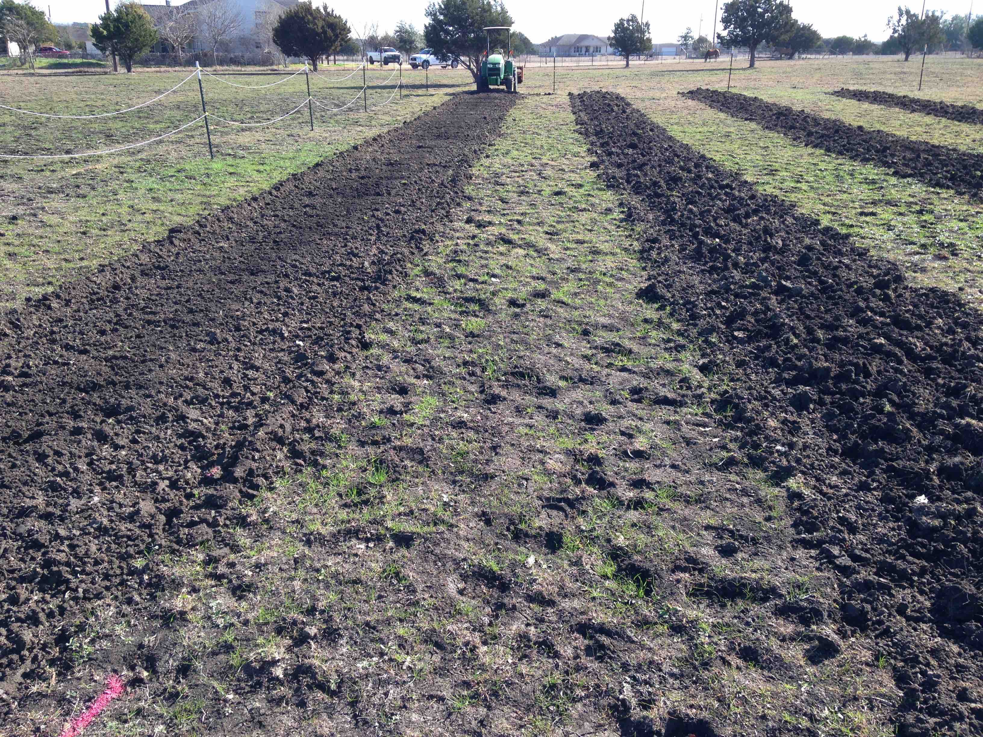

You could use a rotary tiller after the discing.
Tilling after discing on left, discing on right:
This is clay to clay-loam soil, and I worked it a little too moist. Had I waited, the clods on the right would have been smaller with less moisture in the soil.
This is newly-broken ground for new beds. My process, in sequence:
Subsoil
Rip
Chisel plow
Disc
Till
