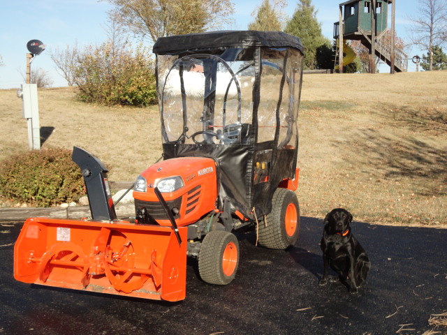

I have the Kubota BX2750 snowblower. It is a front mount, mid PTO snowblower. I think the front mount was about $600 more than the 3PT mounted snowblower. I suggest that you take your tractor out and drive up and down your driveway, in reverse and twisted around watching where you are going. I might even be a little more realistic if you can find someone to spray your face with a hose. I'm not trying to be funny but this will give you an idea what you will be going through.
I also bought a hard top and cab from https://www.covermytractor.com/ I blew snow for three years with out the cab and I can't explain the relief I have, not having the snow blown in my face. The cab and hard top cost about $1500 and once you figure out the sequence of the installation you can do it in about 30 minutes. Here is a picture of my setup.

Did the black accessory with the orange color come with the tractor, snow blower or the cab, or was it a stand alone seperate purchase?

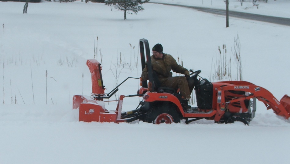

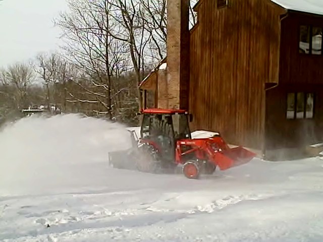

I second the comment of others, go with a snowblower that has a name brand. I also tried using a rear blade at my place; the winter of 2010-2011 made me get a rear blower--funny stopped snowing after I made the purchase. I bought a Meteor. They are made in Canada and a lot of people claim to have good luck with em. Only downside is that the skids don't come with it: they are an option. For your gravel driveway, be sure to get skids.
Good Luck.

Stand alone separate purchase. But has ended up being just as expensive as the Snowblower.

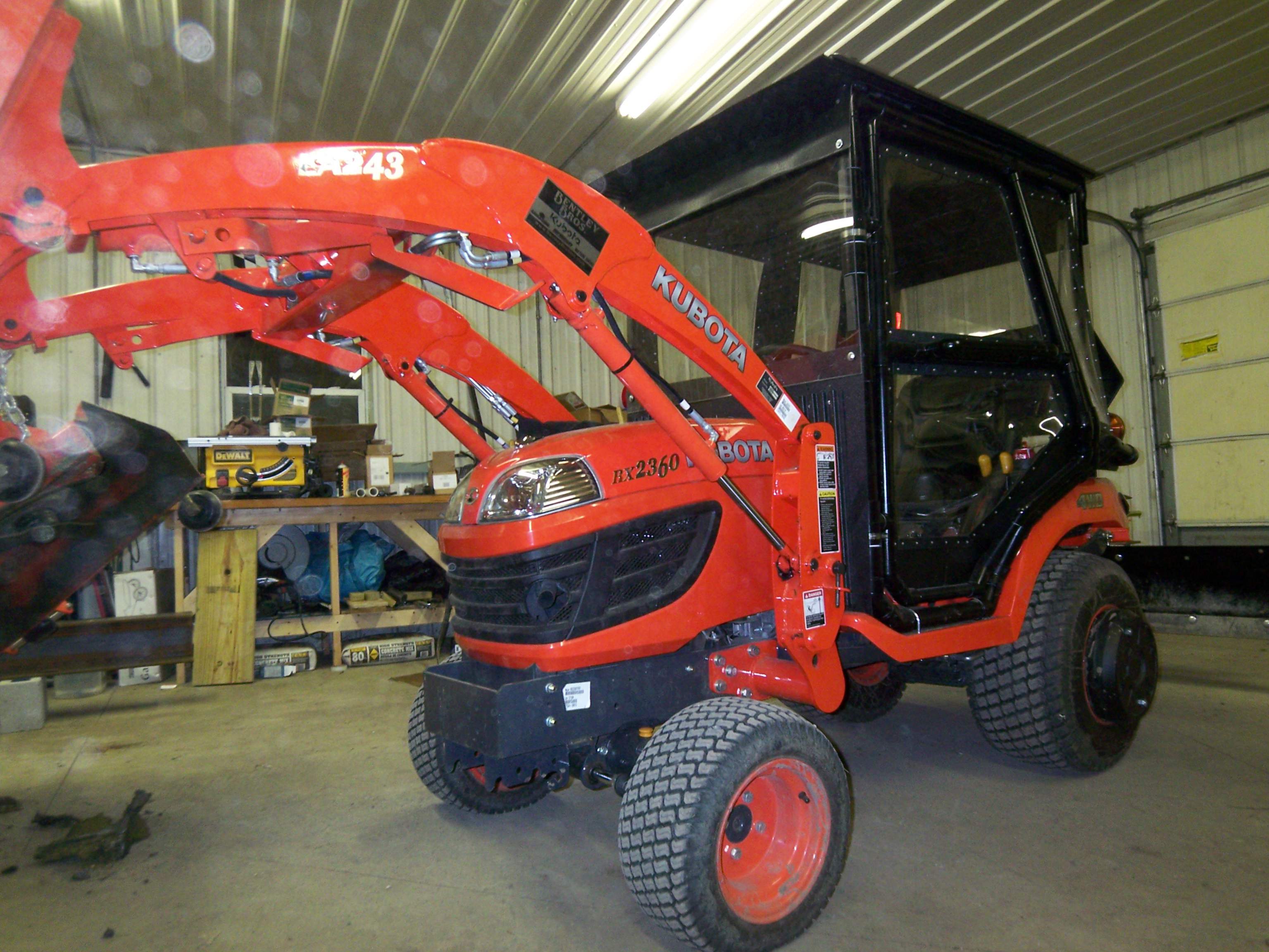

Thanks for all the advice. I already got the cab covered...built it out of PVC and clear vinyl last summer when the wife finally gave in and said "OK you can buy the tractor and the rear blade but NOTHING else." Going to have to sell some of my other toys for this blower...as for plowing backwards, that's how I did it last year and it was tolerable...will be a lot more tolerable with a blower I figure, because it should be twice as quick.

It looks like you're runninng a Kubota MMM. Are you using their front monut snowblower?
