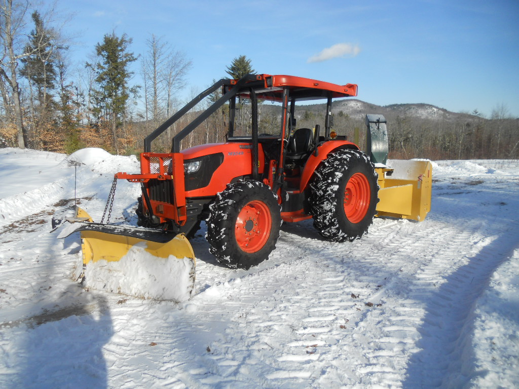

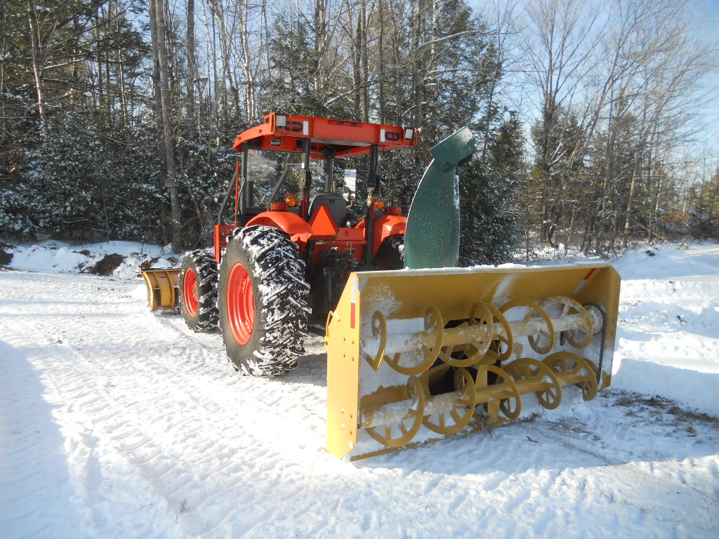

I plow a lot. I keep close to 2 mi open on my place and do about 25 driveways & lots. All but 2 are dirt.
My current method is with a frame mounted Fisher "EZ-Vee" 9'6" blade. When the banks get too big to push back or I just run out of room (woods), I'll get out the blower (8' dual auger Loftness) and the customer get's charged for that. That makes ALL my blowing what I would estimate to be "severe", meaning very deep and usually hard & icy snow. Shear bolts and chain repair is common & frequent.
My reasoning (and question) is simply speed. Normal snows are 6-10" and it's hard to beat the speed of a blade, but with that said, I've never blown a "normal" snow either. My tractor is borderline under powered for that blower (80 ish pto hp) for much over 16". I'm wondering what travel speed would be reasonable for the blower in a "normal" 6-10" fresh snow? It's usually a fairly dry nice snow. I have been considering making a front mount for the blower for comfort & convenience but I question myself how often I would use the blower over the blade. In the past it's also handy to have both on for a final clean up.

Total guess - 4-6mph travel speed with your setup. I can do 4-5mph in those conditions with a 6' single auger blower and 45 PTO HP, if I'm pushing it a bit. 3-4mph is very comfortable for that amount of snow when it's dry and fluffy. Your tractor is much larger and your blower heavier duty than my setup.
I imagine you can plow much faster, but keep in mind doing a driveway with a blower you do one or two passes (and maybe just one with an 8' blower) and it's done, you don't come back for clean-up, compacting piles, stacking snow or anything like that.

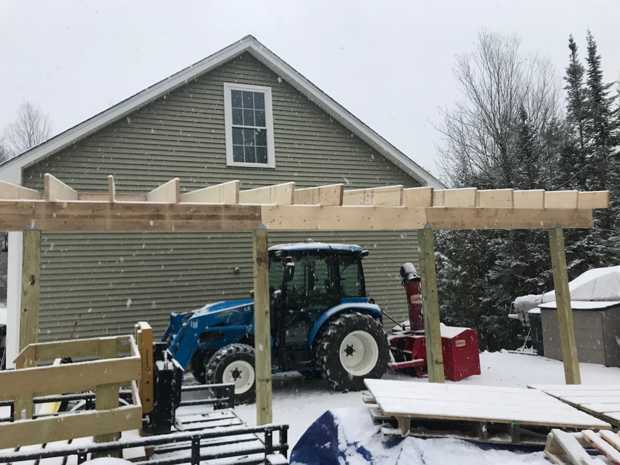

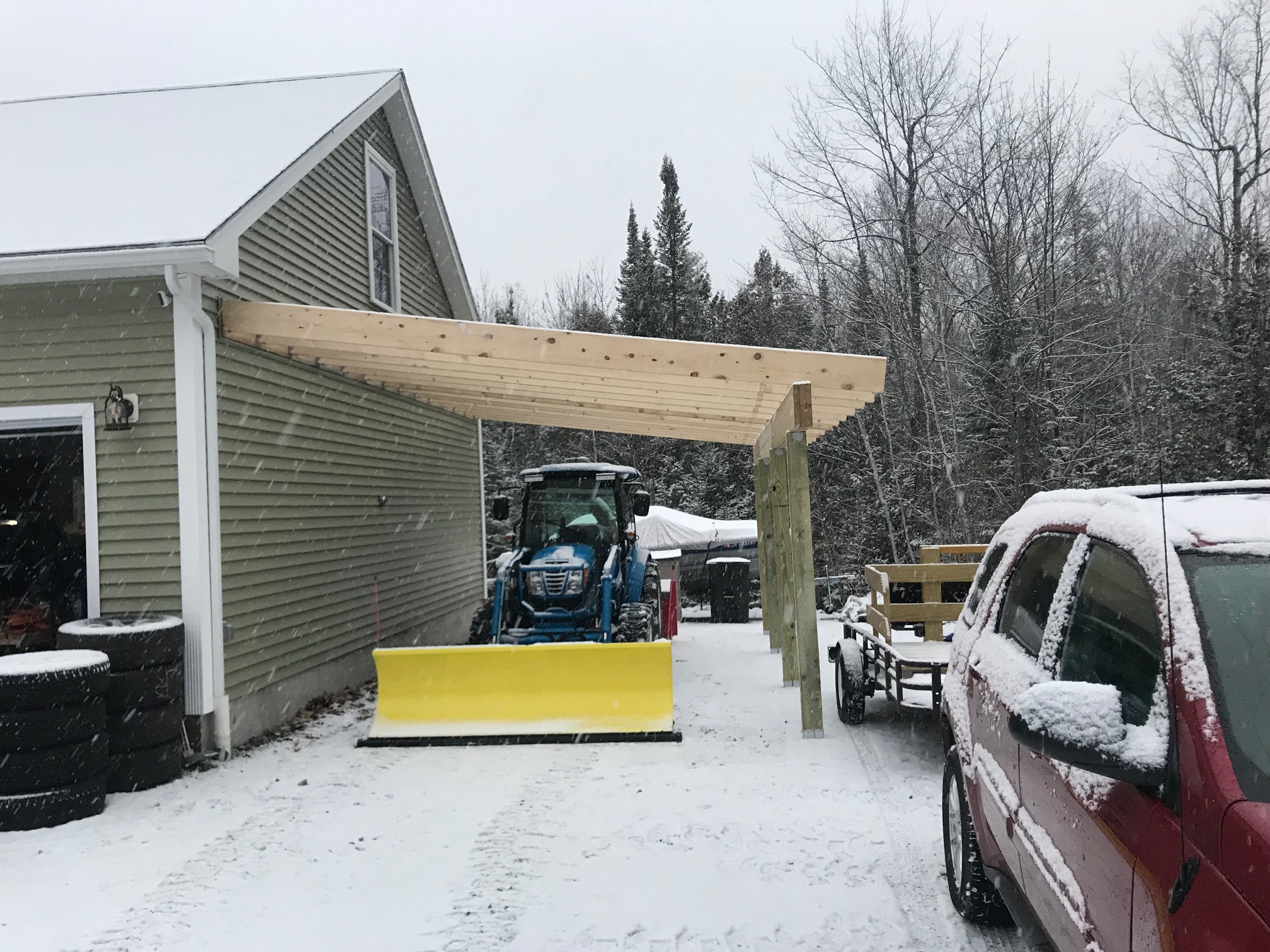

This is my first Winter with my tractor LS 4140HC. I have a 7'6" Diamond plow blade on the front and a 76" Dettson blower on the rear. In the past I've always had "yard trucks" that were not legal to use on public roads because of rust issues. I care for my own private road that is gravel, with a few houses on the road. I don't clear out everyone, but do help about 4-5 older couples that need the assistance. When I bought the tractor the plan was to use the bucket and the blower for everything. I quickly found out that the bucket was useless for anything other than moving snow banks. I find myself using the plow 90% of the time and the blower here and there. My current "plan of action" involves plowing opposite of what I would normally do. I plow from the edges of the road into the center and then use the blower to shoot the snow into the woods. This plan is working great, leaving the edge of the road clear and without banks of snow. I can plow the road quickly then take a slower pass or two down the center of the road with the blower. My reason for doing this is so that the snow banks never really build up narrowing the road, and will help later in the spring to prevent mud and potholes because there is far less snow to melt into the road. This is just my opinion, but so far this Winter we have had a good amount of snow and the road is still wide and clear.

Your doing exactly what airports do so no worries there.
With some airports they plow the snow in fifteen foot piles in one direction going in a loop if they have room to blow snow on both sides of the runway and then follow it with the snow blower eating the windrow and repeat this for the entire 160 foot width of a FAA standard 6,000 foot runway.
