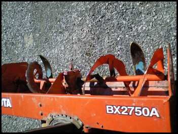

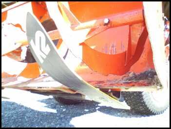

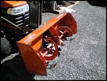

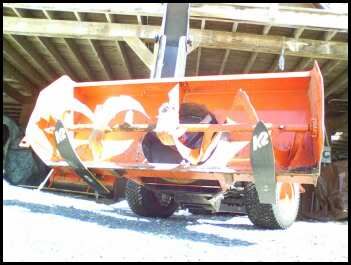

On the news that we are just about to get 12-16 inches of fresh heavy snow (Nor'Easter) and with no snow on the driveway and the crushed gravel has thawed a few inches over the past few weeks, I decided to take the little factory mounted flat skids on my frontend snowblower on my BX23 and mount some chopped off alpine skis. I cut off about 30 inches from the tips and drilled holes in the skid plates. Then clamped the skid plate to the now shortened ski and drilled through the holes I had just drilled into the skid plate. Bolted the shortened ski to the skid plate with two 1 inch x 3/8 carriage bolts. Rebolted the new setup back onto the snowblower and it looks pretty slick. The ski tips curl up just in front of the blower with the same curve of the auger. If I paint it Kubota Orange, ya might think it was factory! :laughing:
Just finished it in about an hour! I knew the old straight edged alpine skis would come in handy for something! I'll post a progress report tomorrow during or after the snowstorm. AND maybe get a picture or two!
I might have to add spacers in between the leading edge of the snowblower and the skis to give more lift. Right now the skis only give about a quarter inch rise and I don't know of any driveway that's perfectly level. :(

I'll have to figure out how to get pics up of the alpine ski mod when daylight comes around. And yes, I do yodel.... thankfully the BX23 is so loud at full throttle the neighbors cannot hear me. :D
I have to say it worked like a charm! I only spit out less than a handful of gravel while doing the whole driveway(150ft x 20ft on a slope). It was weird not getting ALL the snow because I'm used to pushing the blower all the way down and lifting the front wheels so it would be near bare surface after each pass. What was left was about a half inch of snow which quickly melted in a couple hours.
Sure enough, today's sun melted a lot.... I could have left 3 inches of snow and it would have been gone by 3pm.
The snow was a thick settled wet pasty type so I seemed to push some of it while moving forward but most got sucked up and out as it should. Can't wait to try it on colder deeper snow!

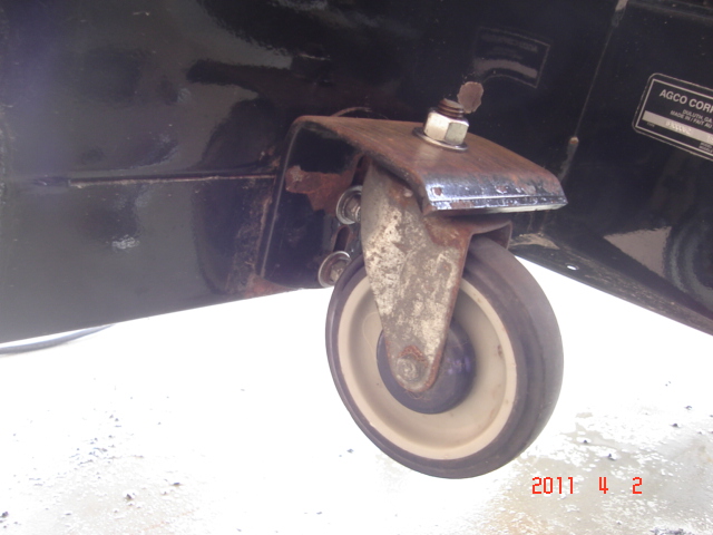

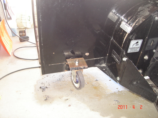

I also tried to come up with a way to deal with the wet, heavy stuff on top of a soft gravel drive.... my solution was "free" (had some 5" casters laying around), but wasn't entirely successful.
It did help some, and might be quite useful next winter, but I like your skis idea!
I took my skids and flipped them upside down to mount the casters; however, the casters are a bit too narrow to prvent sinking in, if the ground is really soft. They'd probably be fine if the drive was firmer.
