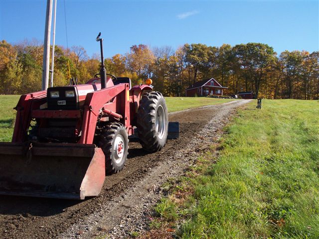

Mornin Kenny,
For what its worth I have the float feature on my old 1986
MF 1040. So I would imagine the manufacturer came up with this idea some time ago ! ;)
