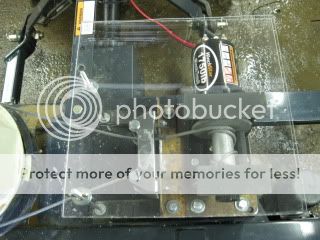

Amazing,how many ways the guys can come up with to do the same job.
This is how I did my electric rotator. (Next come the deflector.)
TGR

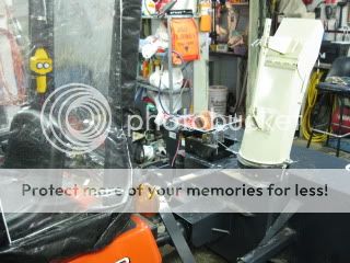

   / Snowblower electric chute rotator motor resource. #24
This is how I did my electric rotator. (Next comes the deflector.)
TGR
   / Snowblower electric chute rotator motor resource. #25
I am in the process of hooking up the power motor chute rotator and the power actuator for the chute deflector angle. I consider myself a pretty good back yard mechanic but I have a problem! :confused: I tried bench testing the motor and the actuator but can't get them to work. Each unit has two wire coming from them. I assumed the motor housing was the ground (-) and the the two wires from the motor were either up/down or right/left depending on which one I applied plus (+) voltage to. Maybe today I will try it right off the Kubota battery and see what happens. :mur:

   / Snowblower electric chute rotator motor resource. #27
Bugsrlb. Reverse the wires and see what happens, thats how it works.
   / Snowblower electric chute rotator motor resource. #28
You will need a DPDT switch or the aquvelent.
   / Snowblower electric chute rotator motor resource. #29
You mean put plus (+) to the motor housing and ground (-) to the wires???
   / Snowblower electric chute rotator motor resource. #30
I did buy the DPDT switches. Thanx
