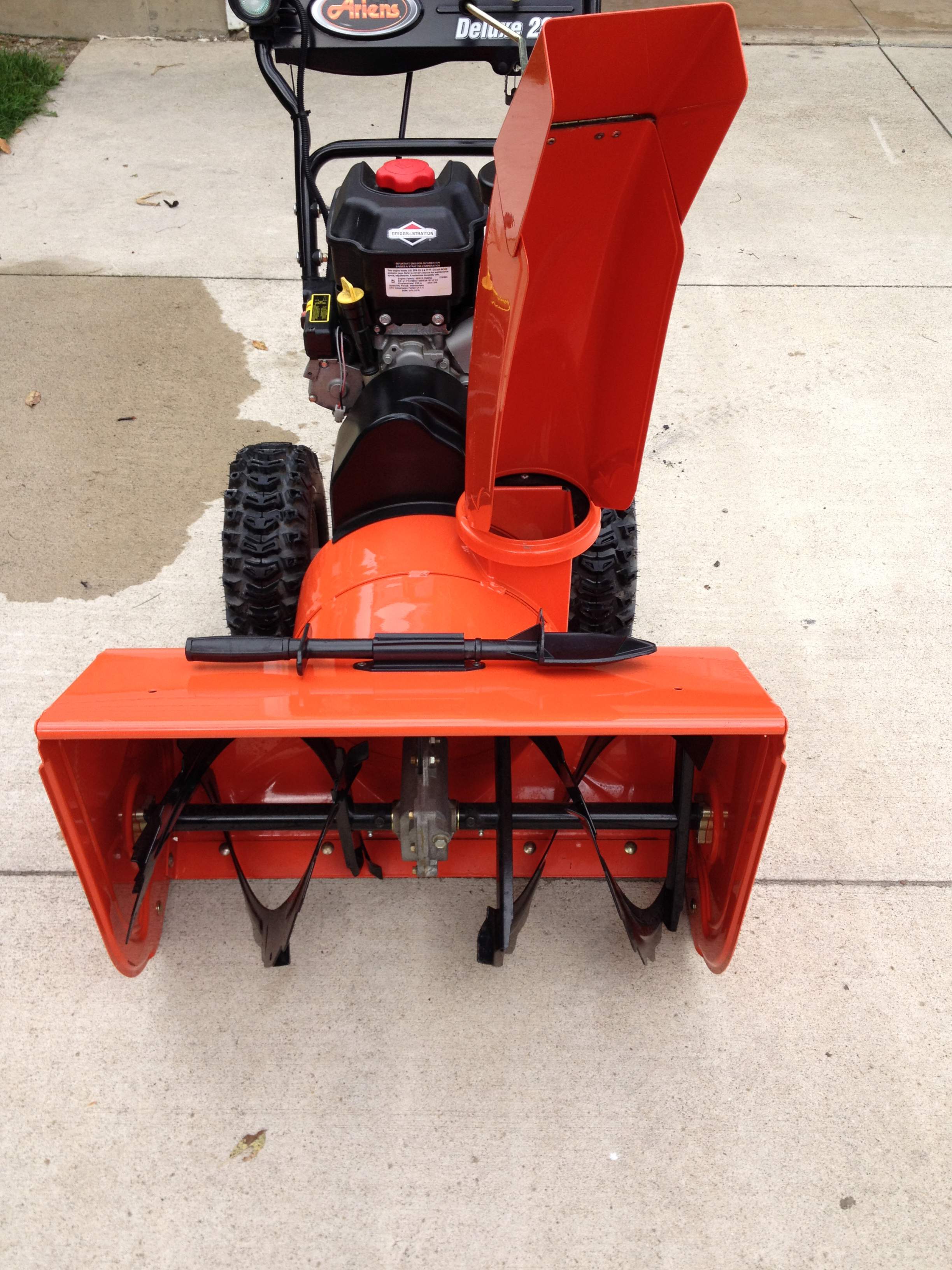

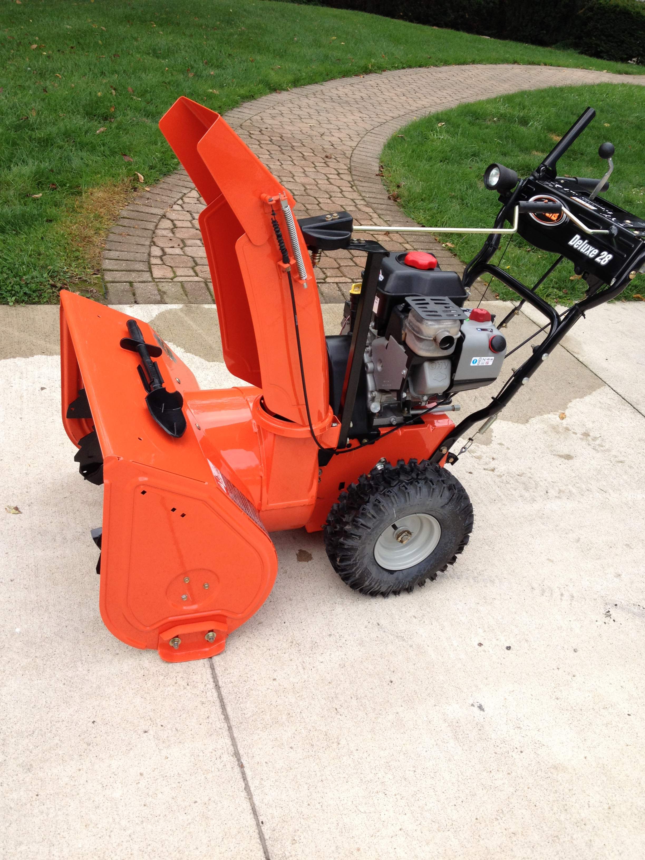

My choice of two stage snow blowers would be Honda,simplicity,ariens,& toro..I have own areins deluxe 28 and love it..Bought is used last year in august for $550..
Those are good machines but all have the 'disc drive'
