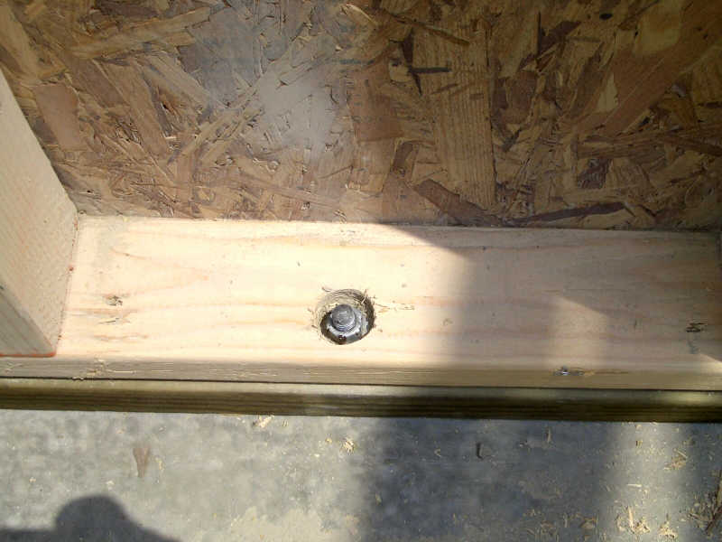

Because the slab was finshed so flat and smooth, decide to do without the sill sealer in favor of dual beads of construction adhesive under the PT sill plate. Galvanized wall anchors were required by code, and we ended up using some made by RedHead every 6' and at wall section ends.

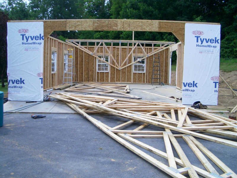

#142
Once the walls were up, spaced and braced, we started setting the trusses upside down on the side wall top plates. The trusses are awkward to move, but not that heavy. Two guys could get them off the trailer and into position.

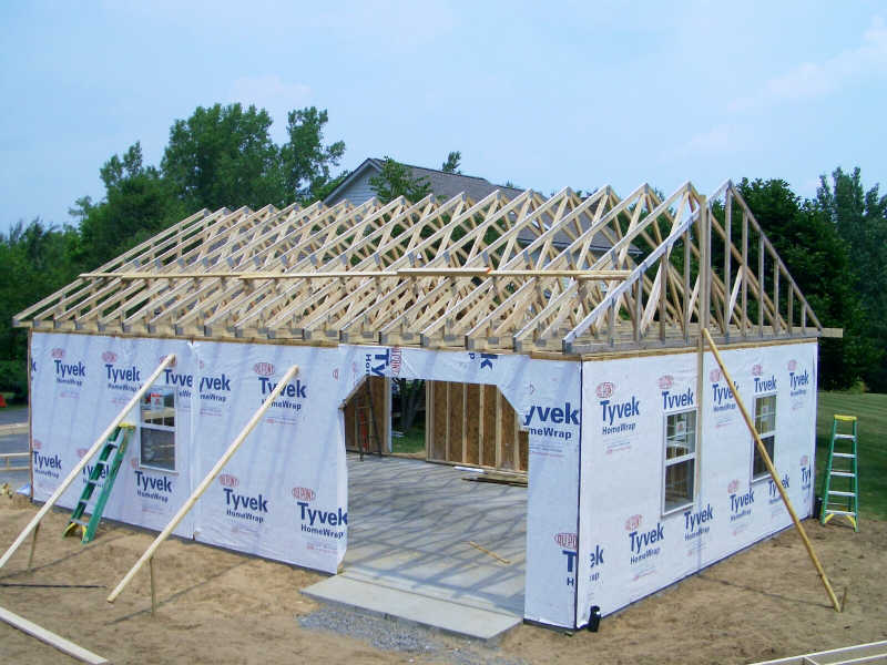

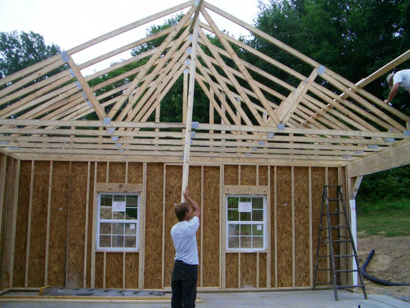

#143
Made a push pole and walked the truss tops right straight up. One guy fitting into position using a pre-cut spacer, tacking the ends and then nailing to the braces.

#144
Trusses are all up, ready for roof sheathing.

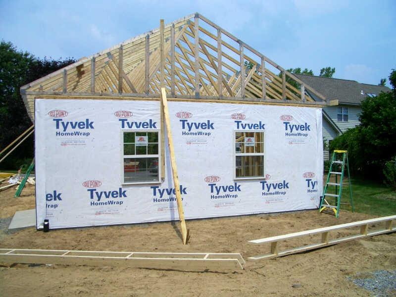

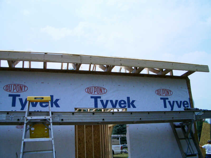

#145
Backside gable end overhangs framed and ready to nail up.

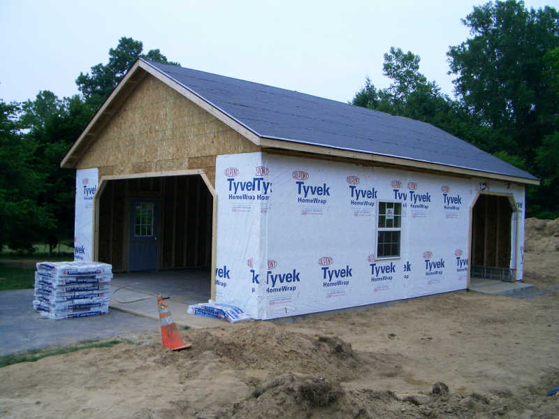

#147
Roof sheathing and paper on. Still working on the rear gable end and overhang.

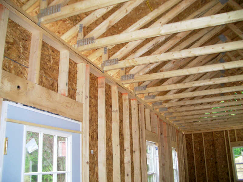

#148
If you look close, you can see we used rafter ties on every other truss.

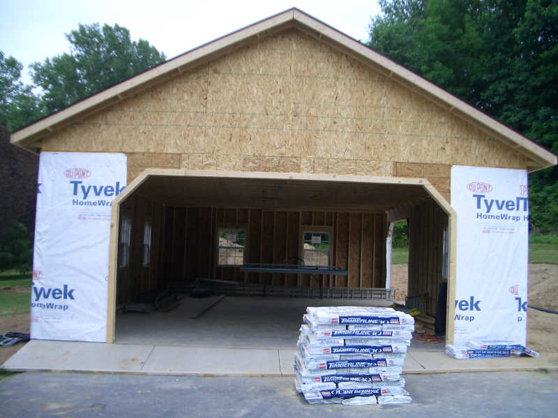

#149
Decided to use 'clipped' corners on the main and side overhead doors for a little visual interest, even though the house garage does not.

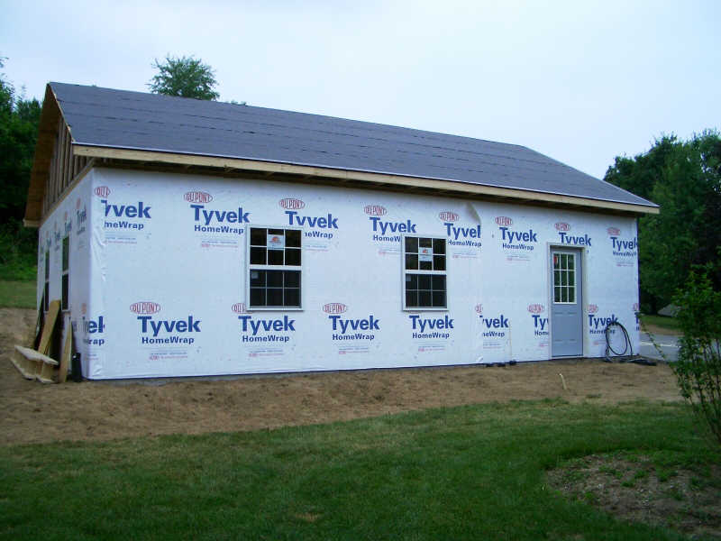

#150
Here's a shot that shows both overhead door exterior trim. I only put one window on this side, as there ultimately will be a shed roof extending over a gravel parking spot along this side.
