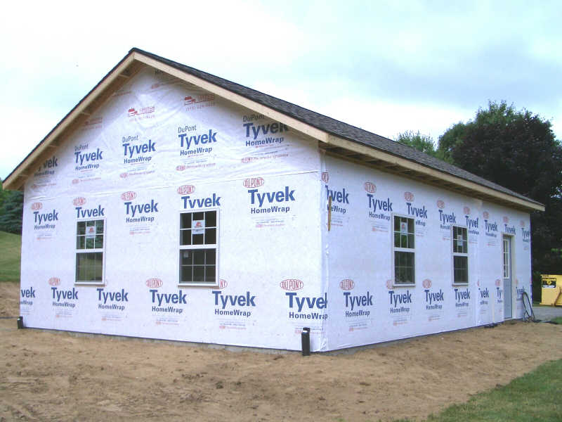

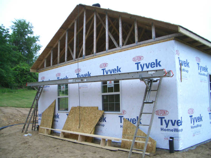

Wanted to get the shingles on as rain is forecast but, before the shingles could be completed, that rear gable end overhang and drip edge needed to be finished. These jack stands and scaffolding worked real nice.
   / So I got a good deal on some trusses...
#156
Back side all buttoned up. Starting to look like a real garage and shop now!
