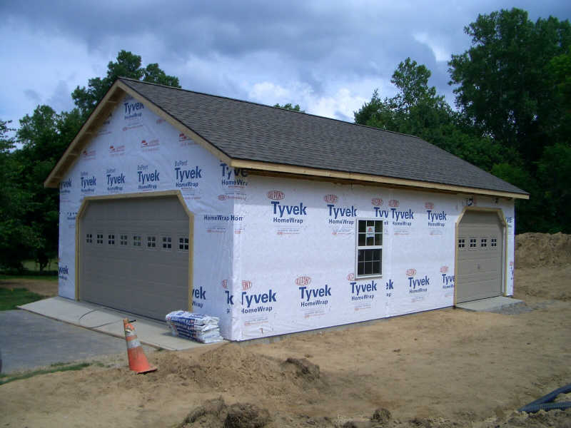

#166
Finally, the siding came in last week. Just in time for a couple days of rain but not complaining, we really needed it after all the heat. The Mrs. - you know, the one who said she wanted the siding to match the house color - says right off, "That siding's too light!" /forums/images/graemlins/mad.gif

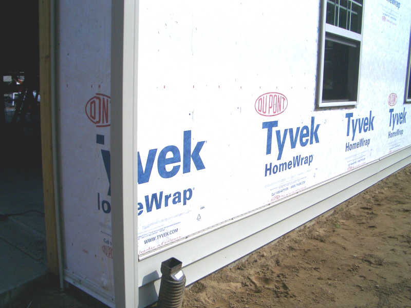

#167
Siding work began on the backside, putting up the corner and starter channel. Didn't want to put any long siding pieces up back here yet, figured I could use any short cutoffs on the rear without anybody noticing.

#168
Yes, Junk, used the real Tyvek tape... now I'm another $4.29 over budget, thanks to you. /forums/images/graemlins/grin.gif

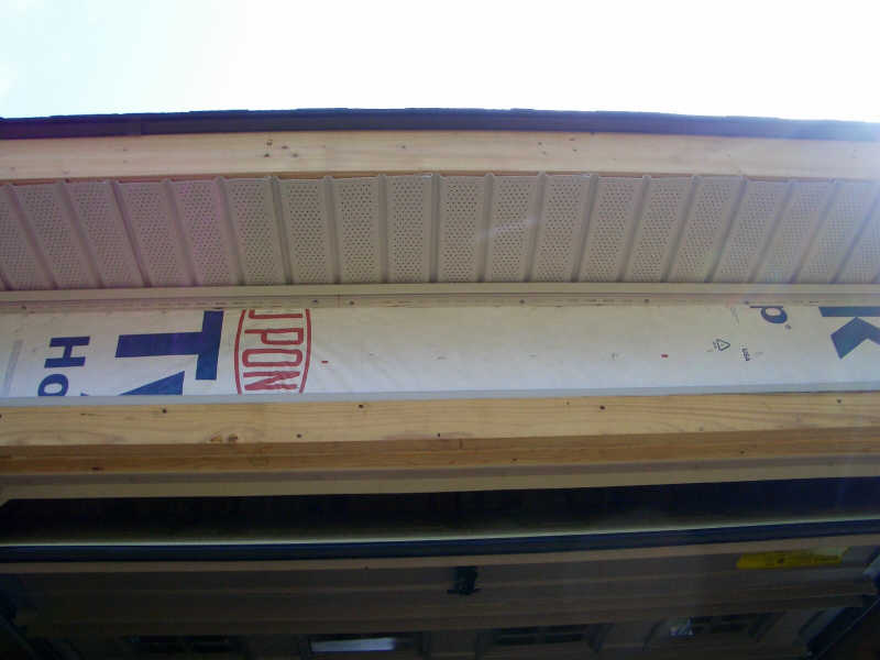

#169
Matching color ventilated soffits are up, fascia and door trim will be aluminum clad a bit later.

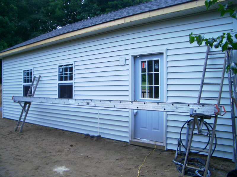

#170
One side done, I think the color matches fine. Dunno what she's talking about! /forums/images/graemlins/confused.gif
