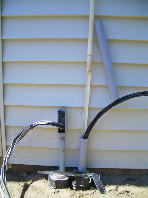

Back to the main supply for a min. When trimming the conduit stub down before gluing the LB on, I was very concerned about nicking or cutting the insulation on the 4-wire supply. So I made a 'shield' of sorts to slip down into the conduit. Simply cut a section of smaller diameter pipe lengthwise and positioned appropriately as I carefully cut around the conduit.

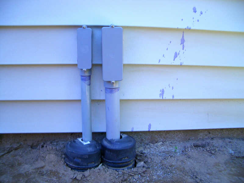

Did have one small accident. Splashed purple primer on the new siding. /forums/images/graemlins/mad.gif
Can says to use baby oil to remove, didn't work. Neither did paint thinner or nail polish remover. Any way to get this stuff off, or maybe that bush would look good there after all?
   / So I got a good deal on some trusses... #213
Been there done that and it is still the pretty purple color. Guess the stuff enters the pores of the siding and any thing that will remove it will also mark the vinyl. Suggestion, take a chunk of scrap siding put some of the purple primer on it, let it dry and try acetone, ether, lacquer thinner, methyl ethyl keytone, mineral spirits, etc. One of these may work but most will cut the top layer of your siding. If all else fails, contact the manufacturer, they may have an easy solution.
Farwell
   / So I got a good deal on some trusses... #214
<font color="blue"> Any way to get this stuff off, or maybe that bush would look good there after all? </font>
I'd opt for the bush. It will look attractive as well as cover up the conduit and your "ooops".
   / So I got a good deal on some trusses... #215
Sure glad I was not the one feeding from an LB into an LR /forums/images/graemlins/grin.gif
Glad it worked for you though.
   / So I got a good deal on some trusses... #216
I second the bush location. Just don't understand why you would use primer?

</font><font color="blue" class="small">( Back to the main supply for a min. When trimming the conduit stub down before gluing the LB on, I was very concerned about nicking or cutting the insulation on the 4-wire supply. So I made a 'shield' of sorts to slip down into the conduit. Simply cut a section of smaller diameter pipe lengthwise and positioned appropriately as I carefully cut around the conduit. )</font>
I like that protection idea. In our house, all of the wire in the studs has conduit around it so that a wire isn't drilled or nailed into. Pretty neat idea to keep knuckleheads like me from killin' themselves!
