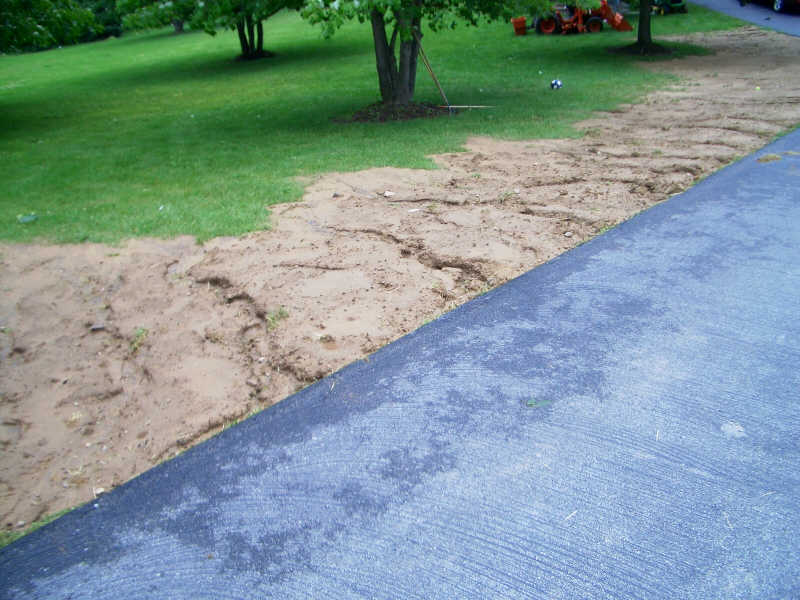

</font><font color="blue" class="small">( Often a rain like that midway through a project like yours can be more disastrous. )</font>
Yep, you can't argue with Mother Nature, as this pic clearly shows. /forums/images/graemlins/crazy.gif

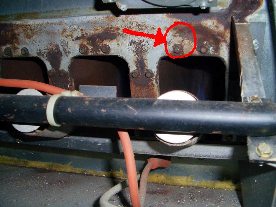

murf - I do see quite a few of them around but don't hear much about quality one way or the other? I guess that's good. One thig for sure, the AC has been working overtime for the past week. I believe it is about 4 y.o. and I think 12.8 Seer. Does that sound about right? Anyways, our home just sold had the infamous York 'cracked heat exchanger vestibule'. The little crack in the photo cost me $2,000+! Grrr...

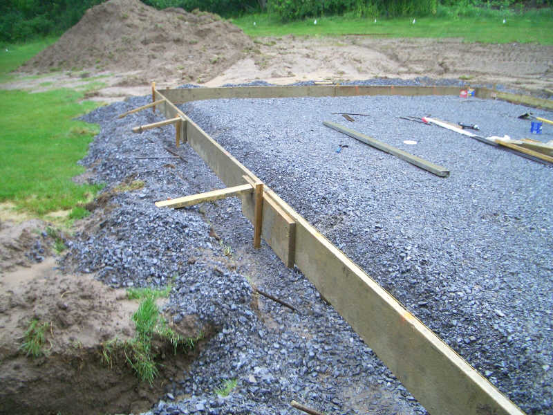

Been a tough couple of days, not many breaks with the rain. Was able to start banging the pour forms together.
